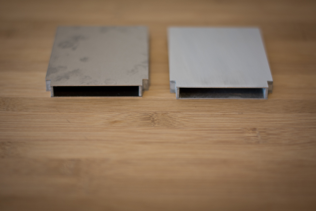

Before going further, a little cleaning is required. The pieces already look nice and clean out of the laser cutter, but we are enough careful enough. For degreasing and general cleaning, I use the hard way : gasoline C (since I did not have acetone), small lint-free cloths that I had from when I was playing around with epoxy , nitrile gloves (you can never be too careful) and, of course, a mask to avoid inhaling the fumes.
Even for aluminium "out of the factory", I think it still really dirty Oo
For the rest, I tinker with my wedges remains of aluminum brackets ... With the return of the great buddy epoxy. : D
And voila ! As it is a slow setting epoxy glue, I put it all in press for the night, hoping not to have bad surprises tomorrow.
After drying for 12 hours :

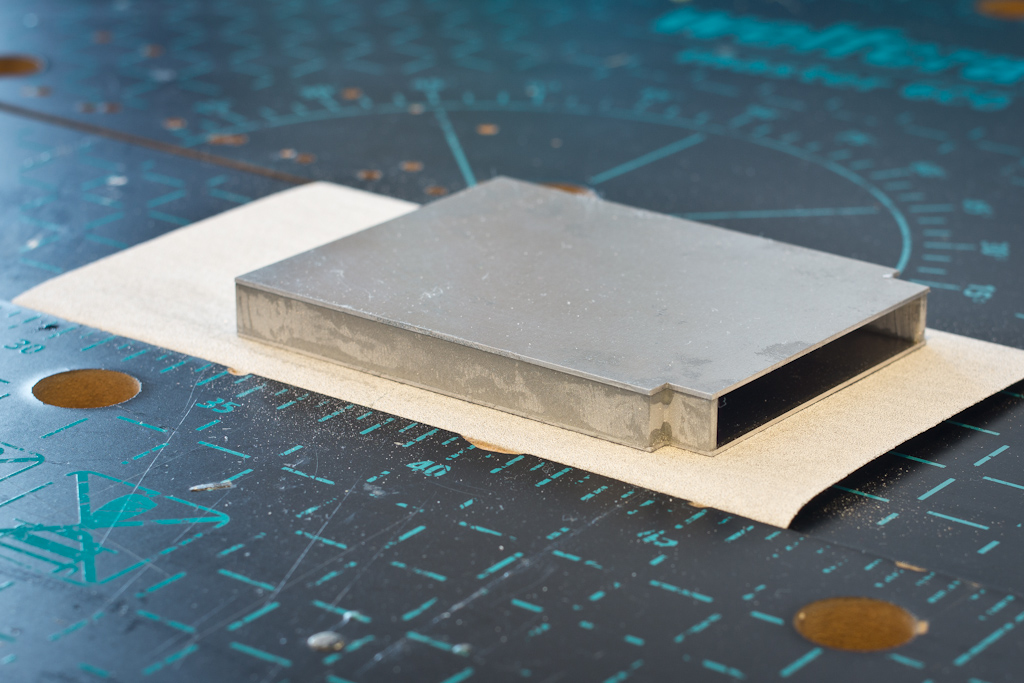

Now, it is to remove the traces of glue and scratches on aluminum it's time to make a little bit of dry sainding with 60, 120 and 240 paper grit :
I honestly did not know what to expect, but in my humble opinion, this is pretty good. I love the matte finish that gives to the aluminum and the "hand brushed aspect". This contrasts with the "too perfect" aspect of laser cutting.
