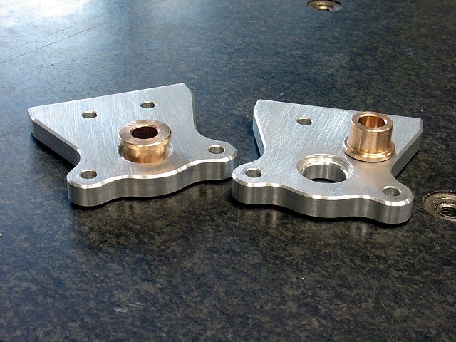

It happened again. You skipped how the material held in the vise is removed. Do you need to make a clamping bracket when you flip the odd-shaped parts? Or do you clamp it in the vise at an odd angle and adjust the cad model?
-It's OK if you don't understand me. I don't understand what I said either.
Cheapskate is offline   Reply With Quote
Old 16th May 2009, 01:06   #144
r4tch3t
hmmmm....
r4tch3t's Avatar
Join Date: Aug 2005
Location: New Zealand
Posts: 3,146
r4tch3t is a hoopy frood who really knows where their towel is.r4tch3t is a hoopy frood who really knows where their towel is.r4tch3t is a hoopy frood who really knows where their towel is.r4tch3t is a hoopy frood who really knows where their towel is.r4tch3t is a hoopy frood who really knows where their towel is.r4tch3t is a hoopy frood who really knows where their towel is.r4tch3t is a hoopy frood who really knows where their towel is.r4tch3t is a hoopy frood who really knows where their towel is.r4tch3t is a hoopy frood who really knows where their towel is.r4tch3t is a hoopy frood who really knows where their towel is.r4tch3t is a hoopy frood who really knows where their towel is.
As far as I can see, when they are odd shape they are bolted to a back piece, you can see it in his last post of CNC action.

Yeah, it took me a while to work that one out as well.
There are two pieces attached to each other, one is clamped in the vise and had holes tapped in it. The other piece (which will become the finished piece) is attached to this first one with the bolts you see here:
Yeah and it looks like the back piece gets kind of sacrificed to get the front one milled. Get all scratched up. Like the wood piece we all stick under our alum and plexi drilling.

Thanks to all for your interest and your great partecipation!
Originally Posted by riekmaharg2 View Post
How many € ?
Depends of the quantity and the profile type of the material. The price of the raw material is 3 to 5 €/Kg.
Originally Posted by Viksom View Post
Hey wait a moment, it's a optic effect or thats millings pieces no match perfectly, give my money back
The two pieces are identical. The difference are only the bevels on the sides.
Originally Posted by r4tch3t View Post
It's not an optical effect, they are identical, you are just seeing the front of one and the back of another.
It's right! Thanks r4tch3t
john
Thanks guys for the great explanations!
Sometimes, I use the "masks" for the milling of the perimeter piece.

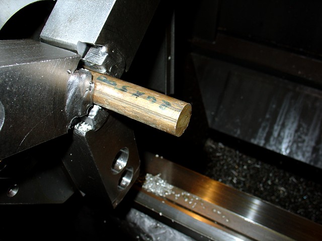

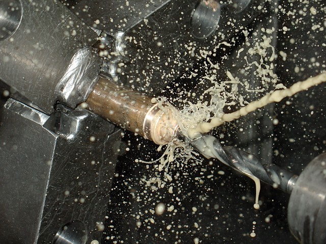

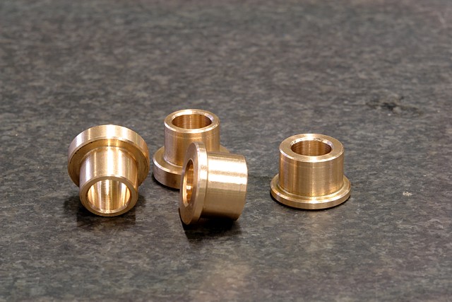

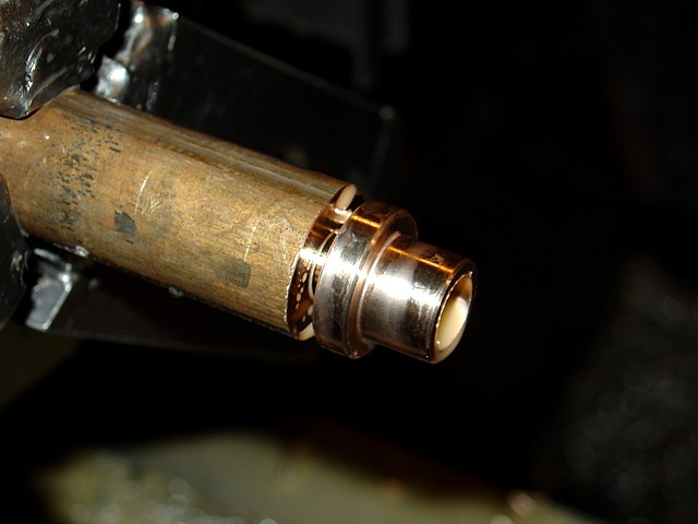

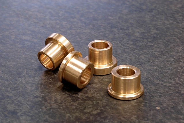

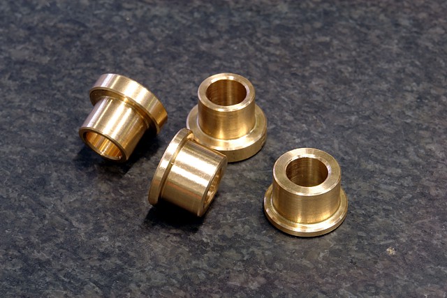

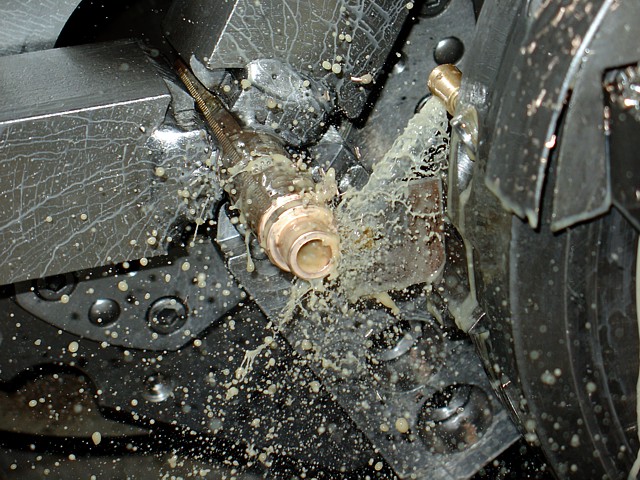

UPDATE
The bronze bushings.

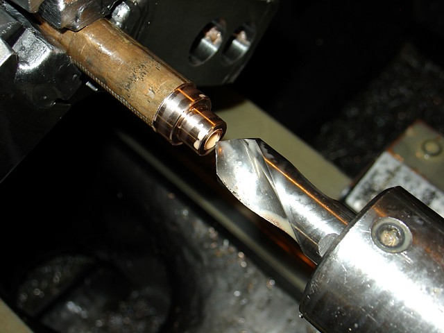

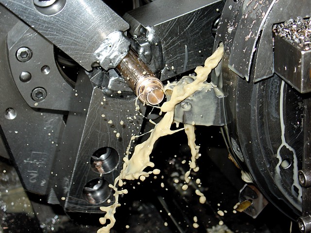

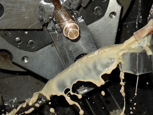

The photos of the CNC lathe working phases.
ZOOM!
ZOOM!
ZOOM!
ZOOM!
ZOOM!
ZOOM!
ZOOM!
ZOOM!
ZOOM!
ZOOM!

Old 22nd May 2009, 07:06   #154

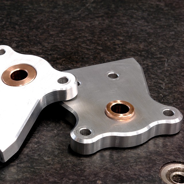

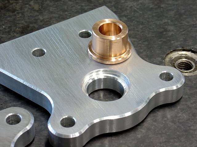

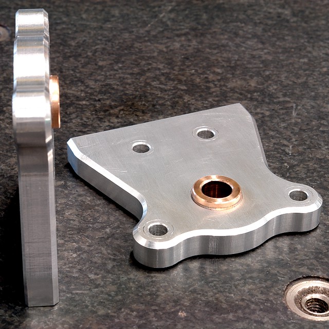

...and some images of the installed pieces on the supports of the guide.
ZOOM!
ZOOM!
ZOOM!
ZOOM!
See you soon to the next working phase...

DAVEtheRAVE has yet to learn the way of the Dremel
Awesome work! And I love your photos with the cutting fluid in such focus!

Originally Posted by SNiiPE_DoGG View Post
well my hats off to you sir, a CNC mill is something I very much hope to own one day - yeah, screw a fancy car - following with great interest!
*agrees*
I start missing my cnc op education days reading this thread. <=)
Keep it up!

I have no idea whats going on, but that looks awesome! Great picture skillz, i know ill never own a cnc, so ill just wish i had your photography skills

As always you pieces are beautiful, I am looking into getting a little hobby lathe, yeah I know a CNC is a completely different thing but they are quite similar.
