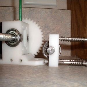

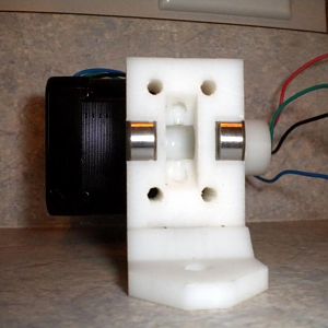

Prometheus
From another angle

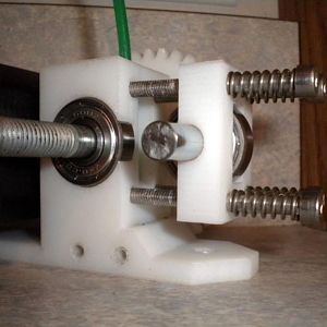

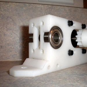

Prometheus
The bolts thread themselves into the plastic

Prometheus
The springs allow me to adjust the pressure on the filament

Prometheus
Here you can see how the material is forced through the extruder

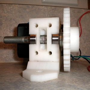

Prometheus
From another view

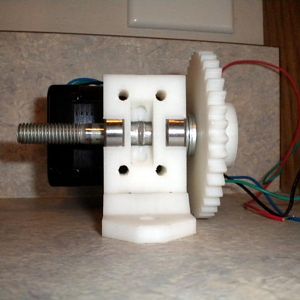

Prometheus
From another view

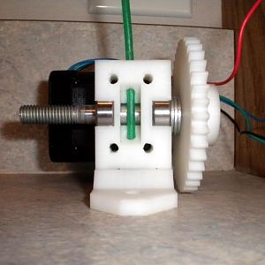

Prometheus
Here you can see where the filament enters and exist the motor assembly

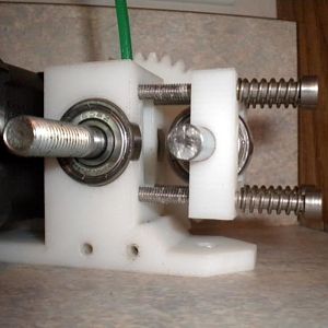

Prometheus
Bearings keep everything rolling smoothly
