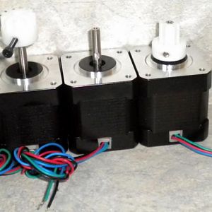

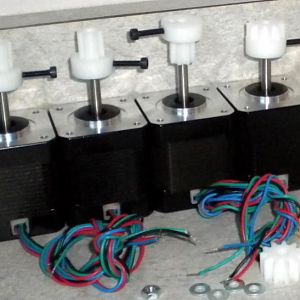

Prometheus
Small flats were ground on the shafts of each motor to give the bolt something to stick to
54
04 Sep 2010
Sea Shadow
Prometheus
Each of the gears has a trapped nut to hold the gear in place
52
04 Sep 2010
Sea Shadow
Prometheus
Nema 17 1.8 degree stepper motors
65

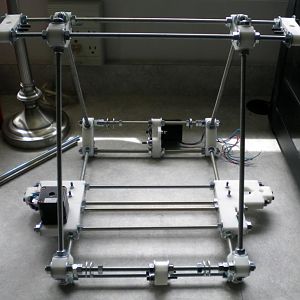

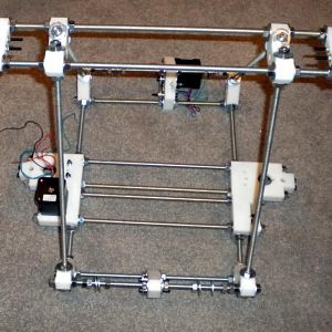

Prometheus
I have added the lead screws for the Z-axis and installed the X-axis (it was upside-down when I took the picture)
54

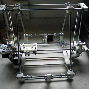

Prometheus
Time to square up the each axis and add some loctite

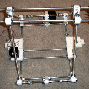

Prometheus
All bottom rails have been installed

Prometheus
Alternate view

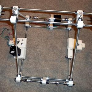

Prometheus
Now some of the center supports have been added, they are needed since the Z-axis belt will be tensioned right over that area.

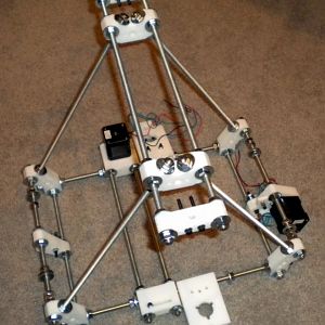

Prometheus
The back rails have been added. If you look closely you can see where the motor for the Y-axis has been mounted.
