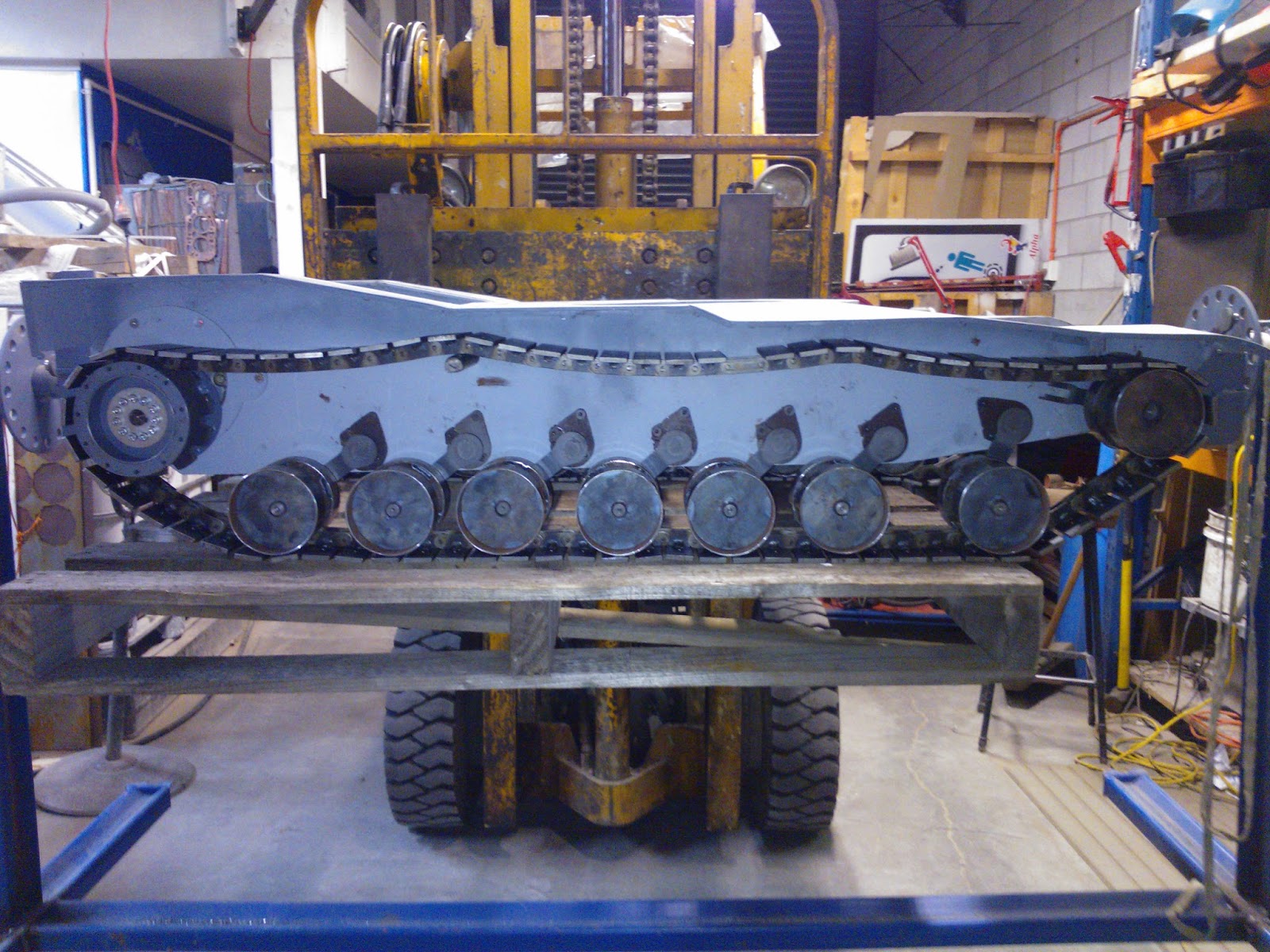

    Cut the first track to length and attached to tank for testing.
    Will be doing the other one later today, once done can look at running up the motors to see how the tracks will run.
    Suspension sitting at the level i was hoping for and seems to work well. I still have the full waight of the jig on it as well which should make up for no turret etc in it.
    Testing to see what it will look like with the side skirt on, looks about right

    Kick buttocks.:D I can almost hear the tracks clanking already.

    Holy moly that thing is huge! But looks like it could be really cool toy :D Great looking project.

    wow ..sir you have some excellent engineering skills. you must have an oversized demel
