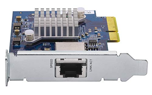

    OK, after initial proof of concept, I swapped out the nic for a Qnap QXG-10G1T, mainly because it was super cheap on Amazon Warehouse. Also, the SFP nics are fine but RJ45 transceivers get damned toasty in use.
    Gotta say, I love Warehouse deals - according to the description, this card had a 1cm x 1cm cosmetic blemish on the PCB and the packaging is heavily damaged. It was pristine. All of it. Even the box.
    Nice little card too, and it comes with Std, LP and Qnap NAS-specific PCI brackets and even a CAT 6A cable.
