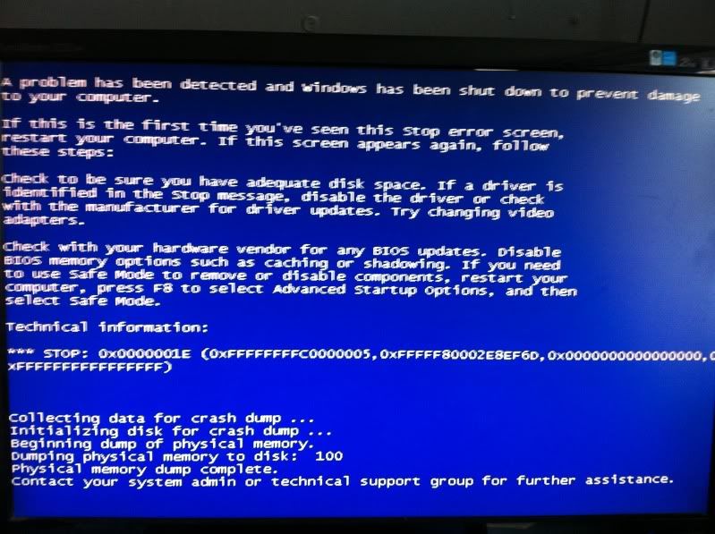

    So I swapped my PC from my Antec300 to a Corsair 700D yesterday.
    I also installed some RAM I got 2nd hand.
    Taking my 4GB to 8GB.

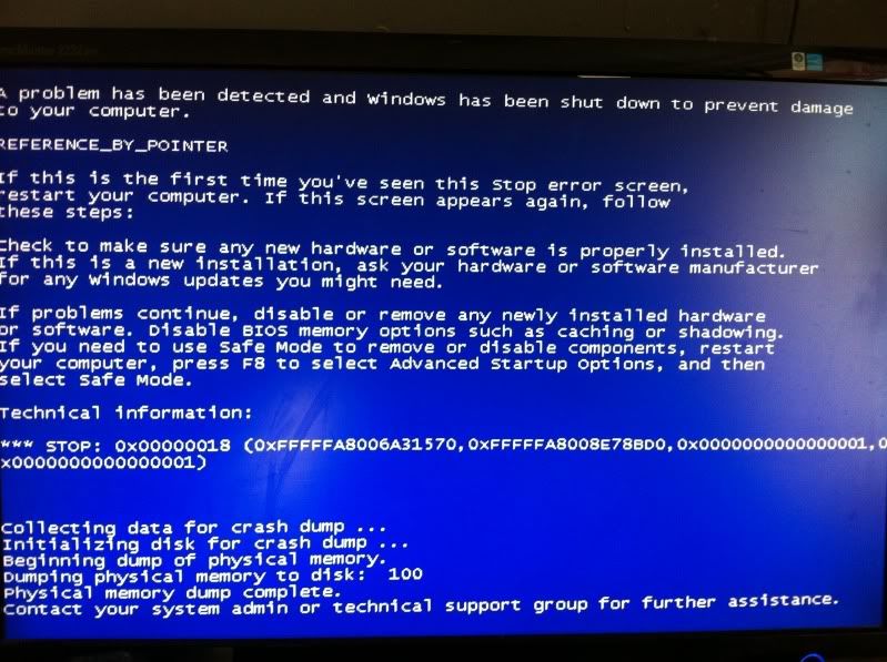

    I've had two bsods since the swap. Details of the dmp and blue screen
    are below.
    The first said ensure that you clean install display drivers.
    So I uninstalled my ati card, driver sweeped in safe mode then reinstalled.
    Then the BSOD happened again with different codes.
    The second bsod seems to point more towards my RAM if i'm not mistaken from a small search. If anyone knows different please say..
    I'm really hoping it isn't buggered. :(
    Is there anything specific I should look for in the bios to ensure it is
    set up correctly?
    But other than that, argh help! :x
    Please
    I'm using Win7 HP 64Bit, spec in sig (but 8GB Ram not 4).

    Right so, i've done few things. See if they were a problem. Gonna link
    in HW forum, that gets more views.
    Got another crash 3 min ago.
    I have tested my RAM, each of the 4 sticks in each slot on mobo.
    All pass fine.
    I've totally clean reinstalled my GPU.
    I want to do a full HDD diagnostic, check etc and that SMART or w/e is
    all fine. But I don't know what to use? Any suggestions?
    Damn BSODS! :(
    Last dump file..
    Anyone able to help? :( :wallbash:
