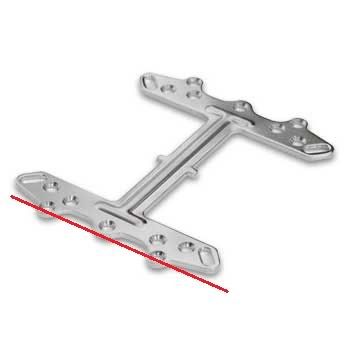

    After having to run with the stock cooler I got the bracket I needed so I can use my fenrir on my 2500K (thanks speed). Went to fit it to my sabertooth with the fan pointing so that it blows air into my exhaust and low and behold the bracket doesn't fit as it fould the heatsinks behind it.
    Out comes the dremmel and I cut off the offending lugs (which weren't needed in anyway for fitting to a 1155), I then find that the fan fouls the heatsink on my first stick of ram (typical) so I am left with resorting to having the fan pulling rather than pushing (which made no difference whatsover when I had to do it on my mugen 2 on my AMD system).

    I'm not going to pull it apart tonight but here is a rough idea of what I did to the bracket, I can't imagine it would have an affect on the functionality of the bracket.
    With 1155 you use the elongated slots on each corner.
    I've seen others mention that there can be a difference between the temps of each core but is it usually as big a difference as 10c?

    Hmmm.... Its not as much as 10c mine has fluctuated between 4-5c what's your idle temp on stock settings

    For core to core temp, most likely too much paste, or it may just be worth loosening the cooler and then re-tightening a bit at a time in opposite corners, just so you know its gone down nice and square.
