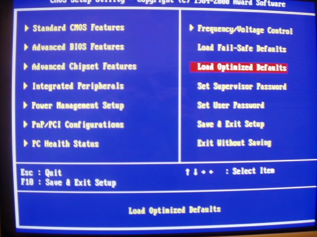

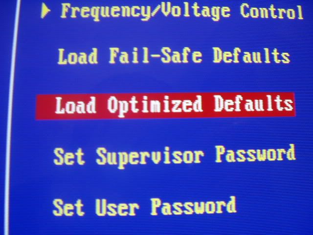

    these optimized defaults are they somewhere besides the screen where you save your bios configuration
  13. Sam0r
    Sam0r It's been a while
    24 Jun 2005
    1,900
    Here:
  14. kenco_uk
    28 Nov 2003
    9,696
    308
    In the BIOS, there may be a setting to set AthlonXP 2500+ or 3200+, choose 3200+ (probably in Frequency/Control if anywhere).

  17. apnaumann
    apnaumann What's a Dremel?
    11 Mar 2006
    12
  18. Sam0r
    24 Jun 2005
    1,900
    Top picture, what you've selected, change it to 200 mhz.
