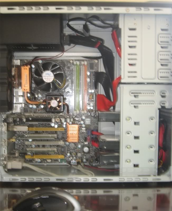

    I just purchased a new drive for $35US. Guy needed money and it was an unopened box.
    I added the extra 400gb Western Digital Enterprise to my 750gb Samsung SpinPoint F1 and 500gb Seagate Barracuda. What a mix right? ....but got good deals at different times.
    The entire computer has heated up. Everything went up several degrees. These pictures are before and after. I just so happened to be talking temps yesterday and had a before shot. I found it interesting that one extra storage drive could do this.
    The "after" picture I played TeamFortress 2 for 30min to see what the max temp would be.
    My computer has always stayed cool until now even with my crazy cables everywhere, but now I think some cable management and a redirection in airflow is needed.
    As you can see in the picture of my case the two fans in the back are switched Bringing air In/Out. (One fan on the side door) I think now they should both be pushing air out, and add two fans to the front of the case blowing on the HDs bringing air in. Cable management, what do you think zip ties? I can careless about the look. My case has a solid door, never was into looks.

    Well thats good to know that Western Digital normally run high. I guess I got use to the Samsung's cool temps.
    I have turned one of the fans around so both in the back pull air out of the case. It has made a huge difference. I removed the 2 hard disk plates in front of my tower and now I can feel the 2 fans from the back working together to pull air in from the front.
    As you can see my temperatures have went back down. Before I receive my new GPU I will either figure out how to fit a 120mm fan in the front or have 2 more 80mm fans in the front.

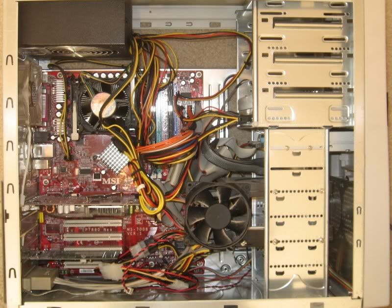

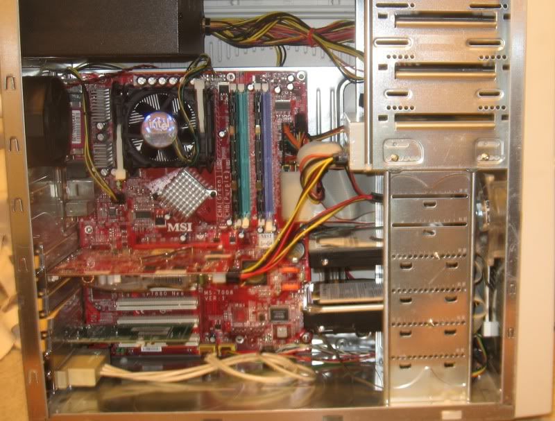

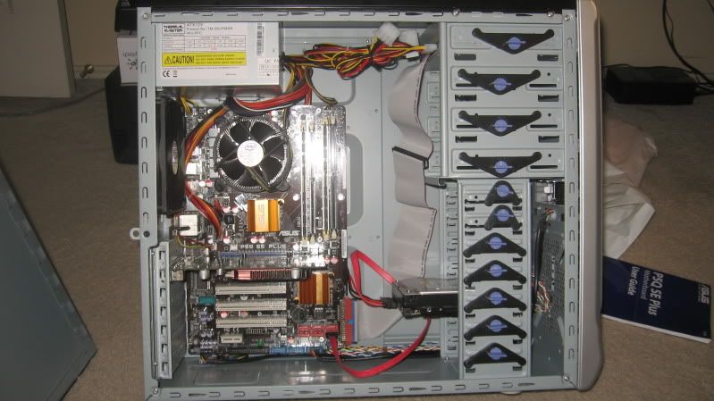

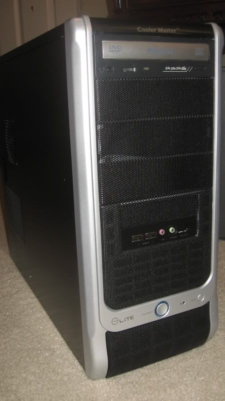

    GoodBytes, I did it.
    I finished building my neighbors computer and then I worked on cable management on mine.
    The neighbor knows nothing about computers and to me its a shame she doesnt know what shes getting. But she wanted something fast and better than her Dell. Every week I have to go over cause she cant open her e-mail or print off paperwork. Nothing really is wrong with her computer, just her. :duh: I had to go cheap in the end on her Power suppy and Tower cause she became tight on money from paying for the removal of her daughters wisdom teeth. Otherwise the cable management would have been better and reached areas so I could do a better tuck away.
    I used the Coolmaster 330 suggested by Bit-Tech, its not a bad tower for the price.
    She has a dual boot Windows 7 and Ubuntu9.04, E2200, P5Q SE Plus, EVGA 8600GT, 2Gs ram, 250G HD. She says she will buy the W7 Lic in June. I know it will only reboot every two hours after the date, but just in case I placed Ubuntu on there just as back up.
    Now! my computer received some cable management after I was done with hers. All in all from fan adjustment and cable management each of the computer hardware runs 10 to 20 degrees cooler, except the Q6600 only a expected 2% drop or so. It was running cool from the start.
