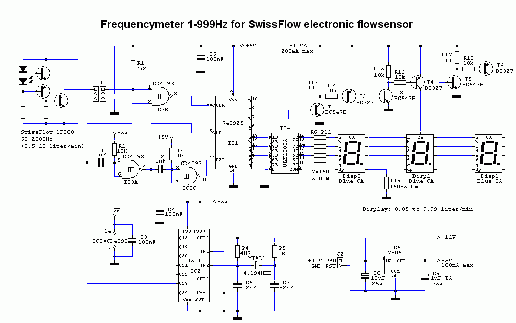

    I'm not exactly making an LED clock here, but I am trying to multiplex some 7-segment displays. I am having problems with the transistor switches used to select the displays. To drive the segments, I am using a darlington transistor array (ULN2001A) and that part seems to work fine. But to select each display, I am using PNP transistors (PN2907).
    However, my displays are just staying on all the time.
    My input to the base of the PNP's is the output of a PIC chip, which can only supply 5V. However, I need a higher voltage to drive my displays, so the emitter of the PNP is connected to a +12V.
    I realize that to actually turn the PNP off, the base needs to be raised to +12V, which the chip output cannot do. Is this the reason why Turbokeu ended up replacing his digit select transistors with the TD62783A (or UDN2981A) High Side Voltage Driver?
  7. SteveyG
    SteveyG Electromodder
    23 Nov 2002
    3,049
    8
    Your PNP's are on all the time. You can easily fix this with some NPN's in open collector or cascode configuration to turn on the PNP's. Whichever works best for you :)
  8. Turbokeu
    Turbokeu Minimodder
    30 Jul 2002
    347
    Yes.
    As SteveyG says you can easily fix this with some NPN's in open collector or cascode configuration.
    An example here:
    See T1 to T6.
    CD :)
  9. phugger
    phugger What's a Dremel?
    16 Jul 2007
    The NPN and PNP pairs worked like a charm. Thanks guys

    ok, this is a really noob question on transistors: wouldn't you need a resistor in series with the base of the npn transistors T1, T3 and T5 because they are transistors (which switch on current) and not mosfets (which switch on voltage)? i'm obviously missing something, can someone explain this to me?
  11. Turbokeu
    Turbokeu Minimodder
    30 Jul 2002
    347
    The base resistors are included in the 74C925.
    See the 74C925 datasheet.
    CD :)

    thanks, i thought i was going crazy...
