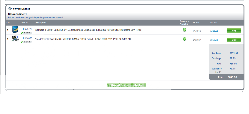

  17. MrDomRocks
    MrDomRocks Modder
    5 Sep 2011
    5,048
    130
    I can't help you in regards your issue. But the best bet is to wait seeing as Sandy Bridge E is coming. Which may or may not be the next choice is upgrade. Depends on performance and NDA's are lifted on Bit Tech and other websites/magazines etc.
    i5 2500k is a great chip. perfect performance and great overclock ability. Though it's all down to if you get a good chip when you buy it. Mine overclocks to 5ghz stable currently but I haven't done any serious testing.
    Mobo/CPU upgrade your looking at this:
    Not including an after market cooler cause your going to overclock right?
