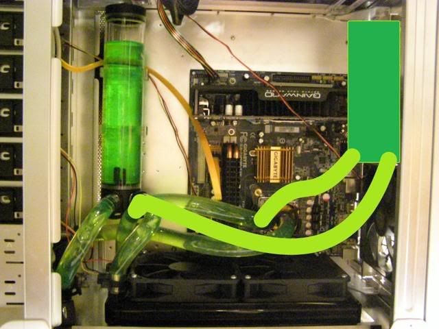

    Hey,
    My loop used to have an EK 150 res but I upgraded to a 250, the spare 150 was going to be used for a second loop but I don't think I'm going to have the money to build a second loop any time soon. I thinking of adding the spare res into my loop so I was wondering if there would be any major disadvantages of doing this? The only reason I want to do it is for aesthetics really.
    If I do decide to plumb it in, does this setup look ok?
    Its currently - Pump>CPU>RAD>RES
    and the adding in the second res would make it - Pump>CPU>extra RES>RAD>RES
    Watercooling spec is in my sig.
  2. Krikkit
    21 Jan 2003
    23,615
    454
    Doesn't make any difference tbh. That proposed re-route looks fine too. :)
  3. tank_rider
    tank_rider What's a Dremel?
    3 Feb 2005
    1,090
    6
    I'd say the only real benefit will be the increase in volume of liquid in your system will slightly increase the time it take for the whole lot to heat up to an equilibrium under load. However there would also be an increase in back pressure due to the longer pipework and extra res, so I doubt you'd see any performance benefits.
  4. DaveVader
    DaveVader Fast Action Response Team
    10 Aug 2007
    2,530
    78
    Absolutely pointless to be honest. More liquid is a plus but more tubing is a negative. Not worth it IMO
  5. ry@n
    ry@n Minimodder
    31 Aug 2005
    1,135
    43
    Thanks for your replies! If do decide to do it, it will be purely for aesthetics so I will post before and after temp to see if it does decrease performance at all.
    To save making a new thread, I have a 2x120mm rad in the bottom of the case and planning to get another 2x120mm rad to mount up front. The idea here is to run dual cooling loops, would this be a good idea or would it be better to just run one big look with both rads in series?
    Loop One - CPU and chipset
    Loop Two - Graphics card(s) and Mosfets
    Im not sure if my current pump would be able to cope with that, so its a choice of buying a beefier pump and running one big loop or buying another small pump and running duals?
  6. pistol_pete
    pistol_pete Air Cooled Fool
    7 Jan 2008
    815
    29
    That's the question really. A longer, single loop will have more resistance around it's path, so you need a higher pump pressure to overcome that.
    I'd say if you are going to add the mosfets and NB as well, you'd be better with two loops.
    You could try looking through project logs for people with WC setups, and see how they have arranged their loops.
  7. opal
    opal Eh?
    21 Jan 2009
    136
    Depending on how much space you have if you can fit another loop in. Would've thought you could get away with 1 loop with a bigger pump and an extra rad though. Also if you really need to cool the chipsets or if you can get away without.
