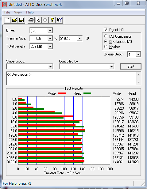

  12. OTO
    OTO What's a Dremel?
    20 Jan 2010
    Thanks for the help! It worked perfectly and my harddrives are now faster as you can see on the picture below :rock:

    Well my run of HD Tune Pro 4.01 is still pretty erratic on AHCI
    ....But my run of ATTO is interesting as upto 4.0 your speeds are higher but then my drives scores sky rocket compared to yours which is interesting.
