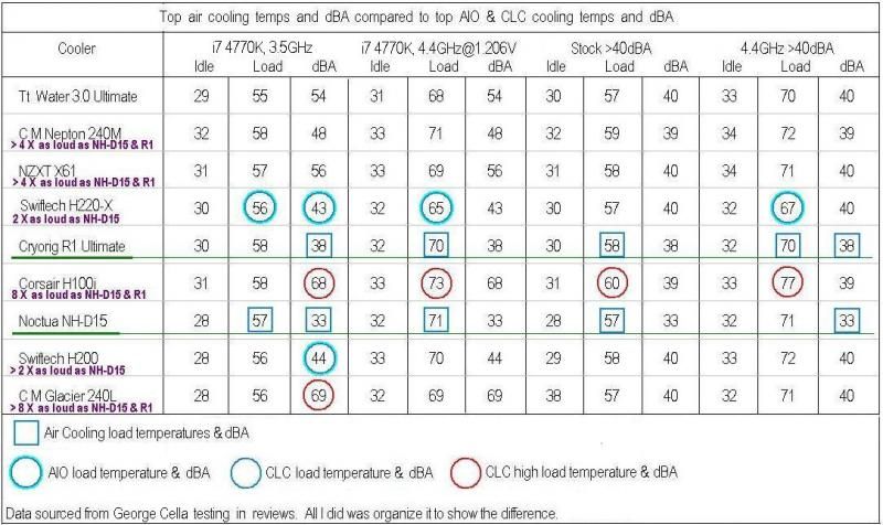

    Interesting that a couple of us were just discussing this. I compiled some data on top AIO, CLC and air coolers.
    H100i is 10c hotter at 39dBA (6dBA louder than NH-D15) It's only 1c hotter than NH-D15 when at full speed, but 8 times as loud.
    Swiftech H220-X is 1c cooler and only twice as loud as NH-D15.
    For me air cooling is still the best way to go for price, performance, noise and dependability.

    Cheers for the info, doyll, that's really interesting stuff.
