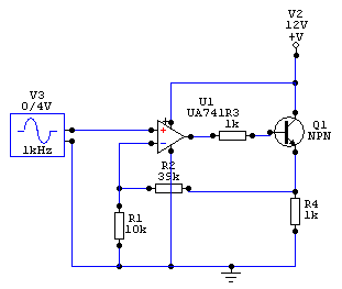

    Well found one, not sure how good it is, but using a 741 (well it's easy to find on the list) and a NPN in emmitter follower seems to work fine, ignoring the huge drop in output range due to the 741, this simulation showing it as 1v to 9v.
    Looks pretty horrid, but hey diagrams help, so curtersy of CircuitMaker Student Version we have (1KHz sig-gen is your ADC, R4 is your fan):

    The original Fig 4 circuit works and I can get up to 11.8V to the fan according to Circuitmaker, even with a 741. :confused:
    Gain = 1 + 39/10 = 4.9
    2.4V x 4.9 = 11.76V.

    *slaps head with a audible clap* The PNP inverts the output, so the feedback via the positive is still negitive feedback.
    What's going on at that transistor is still confusing me, Anyone seen any papers detailing the arrangement? Definately looks handy, if only for DC applications.
