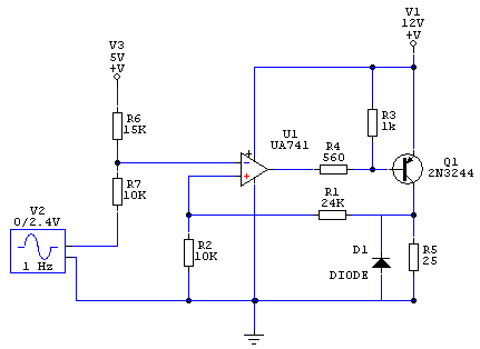

    Easy method I could think of is using a potential divider to compress and shift the DACs output, I dropped the feedback resistor down to 24k as it was pushing 12v for virtually the whole cycle, you can go higher than 24k, but the furthur you go the more bits your throwing away from your DAC, since you were concirned I chose something which doesn't clip.

    That's nice for just an extra 2 resistors. :)

    R6 and R7 are pretty flexible, it'll just change how much and by what you shift/compress the voltage and it's variation by, the values above are correct on the simulator, though the genterator is 'ideal' the output impeedance of your R2R DAC would change things.
