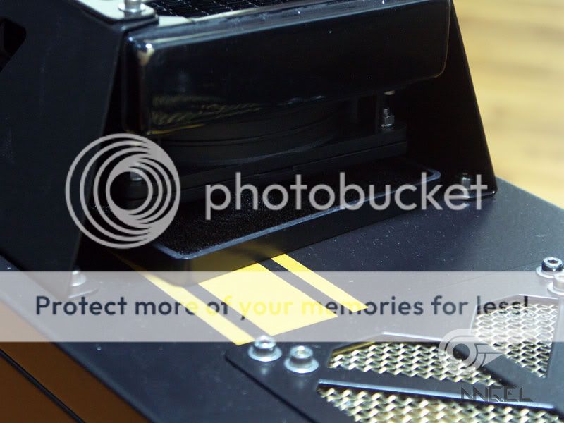

    really love the look of the radiator mount, in fact really love the look of the whole exterior!

    One small suggestion, though: Put the fans on top of the rad and suck the air through instead of blowing it. If not for the improved performance then for the sake of protecting the fins and make the top look a little more "sealed off" and completed. You can still have the filters on the underside of the radiator - just buy 2 more filters and use them without the filter itself on the fans - will make for an OK fan protection grill - or buy a black A.C. Ryan acrylic grill to sit on top?

    Would sucking the air in improve performance? Anyway, FWIW, the fans that I'm using are pretty crap too... And like I said If I had to do it again, I'd definitely make the rad support out of a single piece.
    Plus, most rad grills are bigger than 2x120 in dimension so they won't be very useful here either. Thanks for the thoughts!

    OK. Based on all these feedback, I will be making some changes to rad support. Stay tuned.

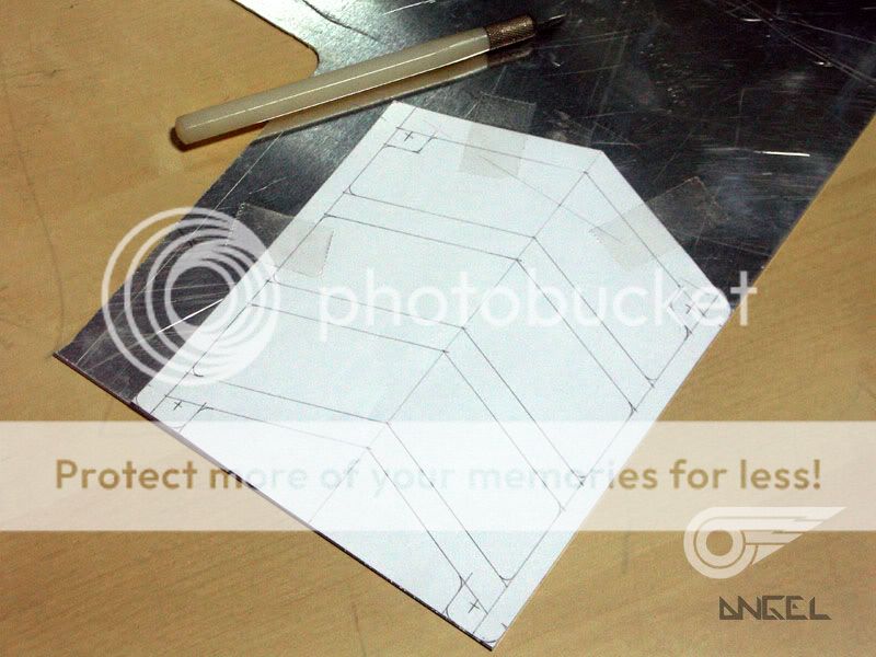

    Based on the feedback gathered here at the bit-tech forum the last time. I decided to work on a new rad cover. I guess it does looks a little incomplete.

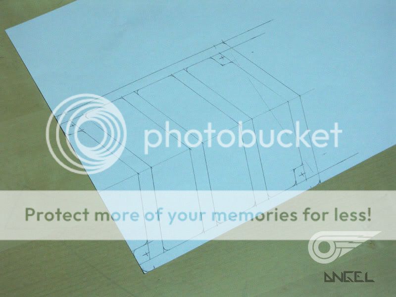

    As always, I draw up the design on paper first.

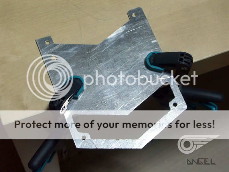

    Next, transfer the design onto the workpiece.
    Begin cutting...
    Cutting done. Filing next...

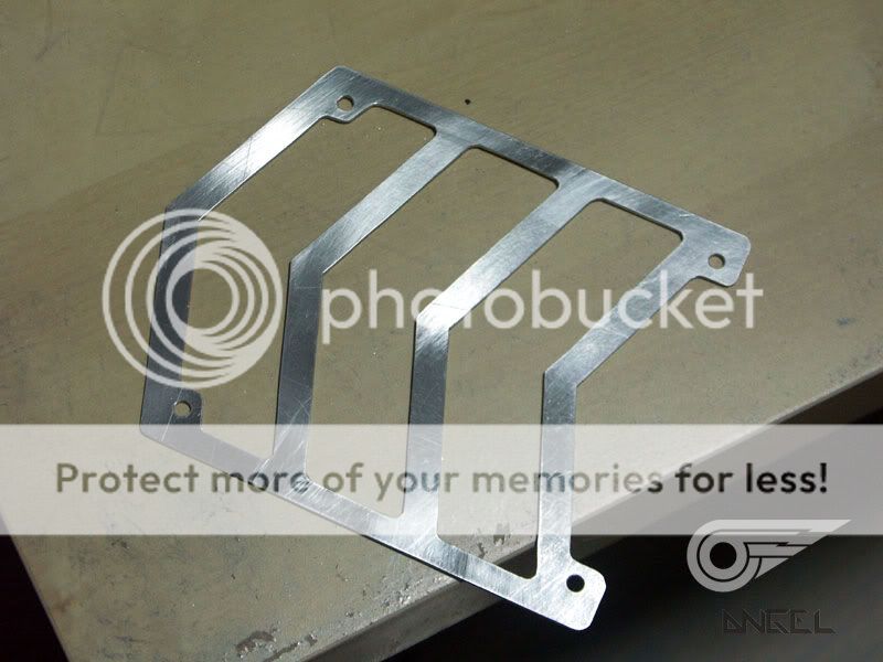

    And 2.5 hours later after I started working. Man... It's a lot of elbow grease work. Shiny!

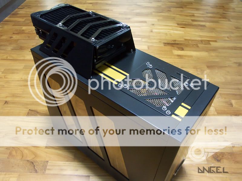

    Off to the powder coaters again, and... Done! This time it's done in gloss black. Looks really rad. :D
    Installed!

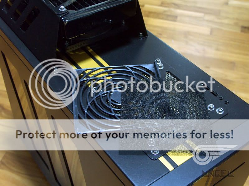

    By the way, someone asked me how I can clean the filters under the rad. Here's how.
    Wow. Dusty already.

    That simpley looks a lot better.
    Nice job!
