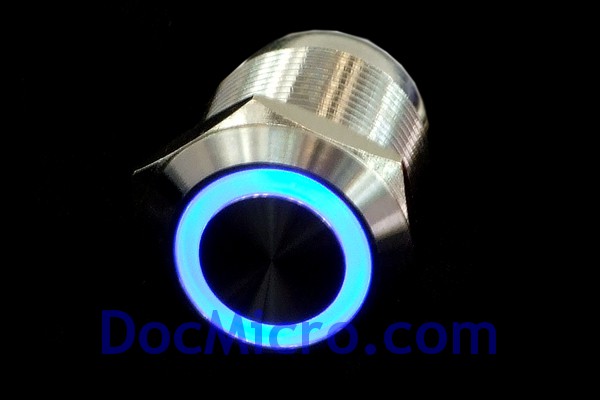

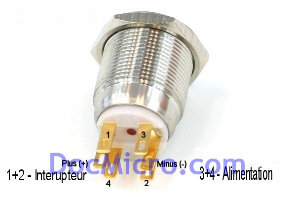

    I'm going to buy an anti vandalism button for my g5 and I wanted to know how did you wire it to you motherboard ?

    Thank you for the answer Cyprio, i will wire mine for cheaper.
    do you know where i can get a male-female psu extension cable that matches the powermac G5 connector size ?

    get a c13 to c14 power cable (these are the connector type used)
