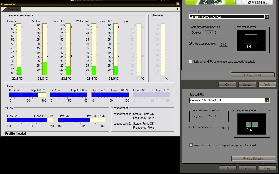

    For some comparison, im using two modded innovatek nv-40(6800) coolers
    on my 7800's
    1/4" loop consists of a fass(res) - aquastream - bip3 - nforce 4 chippy - 7800gtx - 7800gtx - mobo mosfets - fx-57. The highest if ever seen the cards go in game is 41,

    the rest of the info on my other loop if you are intrested.
    1/8" loop consists of, Fass(res) - aquastream - gtx 1 mosfets, - gtx 2 mosfets - ram 1 - ram 2 - bip2 - hd1 - hd2 - hd3,
    Its not true dual loop, they share a comman res , which makes filling a doddle, but it just split up the 1/4" blocks from the 1/8" so the flow rate remained good :)
    I think the aquacomputer blocks seem to more about "bling" than performance. well thats what i seem to have experienced.
