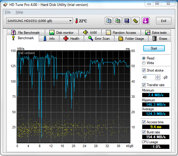

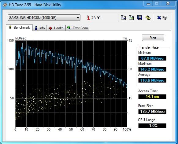

    I have recently fitted my F3 1TB and installed Win 7.
    I have ran HDtune (several versions) and the scores seem rather erratic, can anyone tell me if they look okay. They seem all over the place to me.
    I have set the bios to AHCI and I have installed the chipset drivers.
    Thanks

    lolol -1.0% CPU usage!
    I can't be much help but I do agree they look odd. Speeds are usually different towards the edges of the disk (as for the same RPM they need to move faster than the inner parts) but you have only shown the first 40GB.

    Ah those scores were when I chose the short stroke option.
    The graph below was after I defragged and ran the test again.

    Access time is a bit high... and burst rate very low. Your sustained read speed is healthy however.

    The burst score that bit tech got was around 220 if I'm right but was that done testing an empty drive as I'm testing with the OS on the drive. Does that make a difference.
    The actual drive seems a little slower than my present F1 which shouldn't be right at all.
    Would it make any difference that I'm running it in AHCI as I read somewhere that it can lower performance slightly.

    having your os on the drive will indeed impeed performance of this bench as the os will be doing various reads etc on it whilst the bench is running (i think this may be what your seeing on the fist bench)
