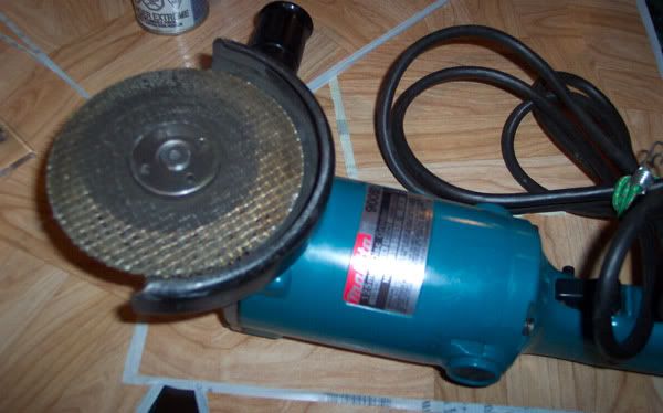

    The cutting blades you display are not the best ones, you can get fiberglass reinforced ones that will outlast the whole canister of the ones you have beleive me, i used to go trough a box of these in a week till someone suggested the other ones. but to cut a window in a steel side pannel i'd use an angeled grinder with a cutting disk, at least for the straight cuts :thumb:

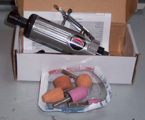

    That first post reminded me i needed something better to grind, this thing can grind a case to dust :hehe: and the nicest WWhhirrrrrrrr garage sound :D
    Air tools are simply the best :thumb:

    And kobalt, why do you need a rotary tool that powerful. Or do you use it for more than case modding. And has anyone had any experience cutting side panels with an angle grinder. Only the straight lines. What do you guys think, and for those who have done it, how well does it work
