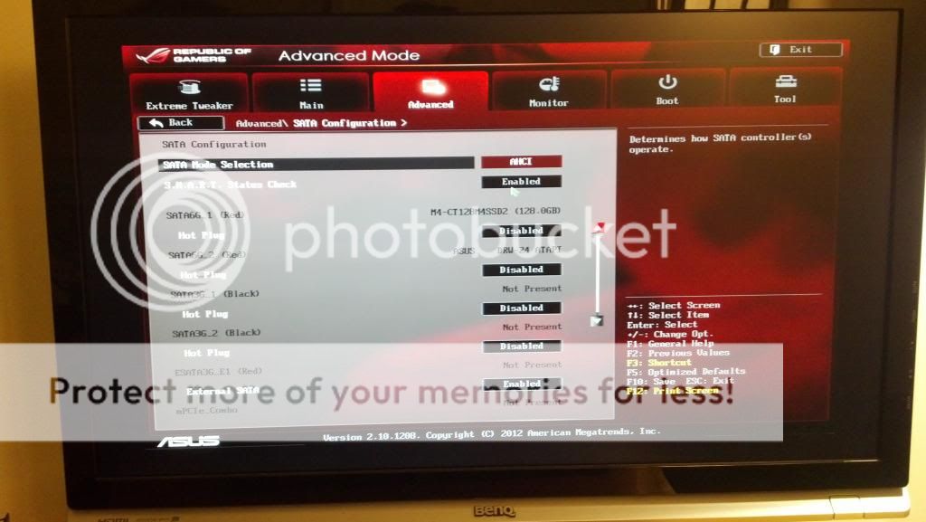

    Can you post a photo of BIOS settings showing SATA settings (where the hard drives are listed with the Hot swap and SMART settings) ?
  9. sixfootsideburns
    sixfootsideburns modeteer
    6 Feb 2009
    621
    9
    sure, does the "Print Screen" work even from BIOS? Or is there another way to do it?
  10. faugusztin
    faugusztin I *am* the guy with two left hands
    11 Aug 2008
    6,943
    268
    Plug in a FAT32 formatted USB key and press F12 on the screen you want to make screenshot of. Or pull out your camera and create a real photo :).

  16. sixfootsideburns
    6 Feb 2009
    621
    9
    In this picture I currently have the ROM drive plugged into SATA6 as you can see, but the strange thing is that the 2nd SSD doesn't show up in the Bios but it does once I start my computer...
