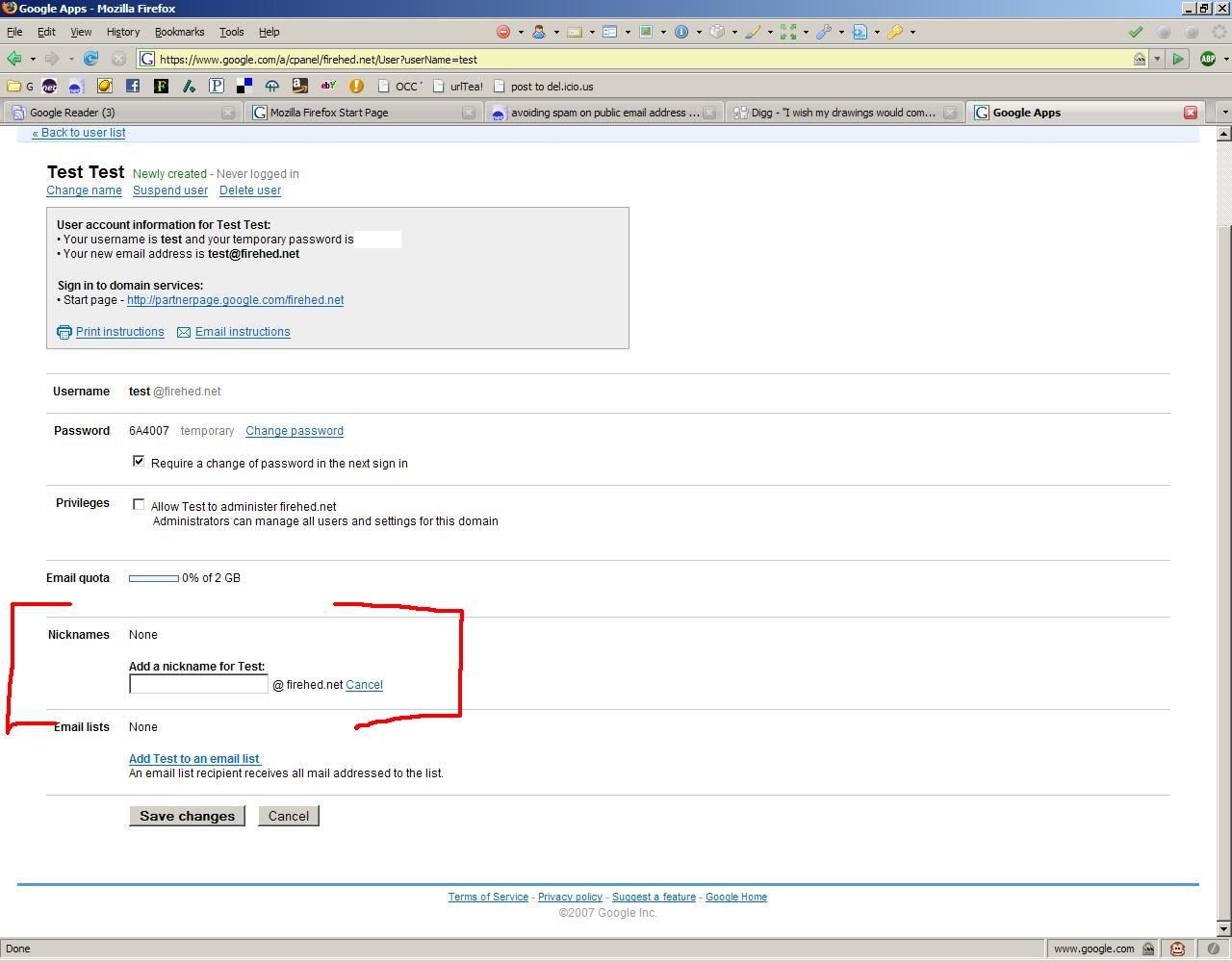

    No they won't - trust me on this one. I used to run a review site and had my mailto links set up like that. About 80% of new correspondence would end up in the catch-all mailbox.
    I'd suggest just using Google Apps for your Domain (google.com/a). Same spam filtering quality as gmail, plus the storage and docs/spreadsheets to boot. And free. If you're changing the recipient every year, it should be easy enough to use the "nicknames" option to have the current captain of the team get anything sent to captain@domain.com. Of course, it's not going to address the problem of not getting spam sent to the address in the first place, but it's too late for that already. Best bet is using better filtering, and I've yet to use something for free that works as well as Gmail.
    See: http://i3.photobucket.com/albums/y66/Firehed/googleappsemail.jpg
