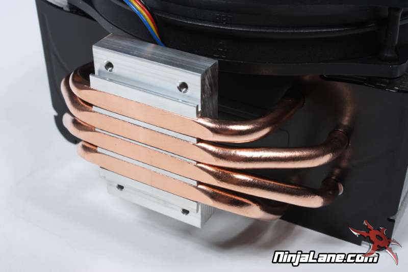

    If TIM acts as an insulator when it's too thick, then is it a good idea to pack loads in between heatpipes?

    'loads' lol I just put in enough so that you can't see the lines between the copper and the metal.

    But even if the gaps between the pipes and the plate is only a couple of mm thick, and possibly deep, I'd have though that was more than enough for the Tim to start insulating instead of passing the heat through, thereby heating the CPU up more in those places. Would have though Air would be the better option, at least some of the heat escapes.

    It doesn't work like that. We are not trying to cool off the chip itself, we are trying to dissipate the heat produced by the chip (hence why we use a heatsink). The fans will do the cooling.
    Good heatsink, doesn't have the heatpipe visible like that.
    Good:
    Good:
    Bad:

    That's what I mean, My Contac 29 is fairly decent for the price, apparently there is some advantage from having the heatpipes in direct contact with the CPU, but then there is the issue with the gaps in between the pipes and the plates.
    If Tim is too thick than instead of transferring the heat, it starts to act as an insulator, keeping the heat trapped, which is likely to happen in the areas where you're advised to fill with TIM to make a smooth surface on the plate.

    I laugh. How is it that BitTech raved about the titan fenrir? I mean, were they being paid off to say it was a good cooler? I get good temps with my fenrir. I'll just assume you mean 'for the most part' bad.
