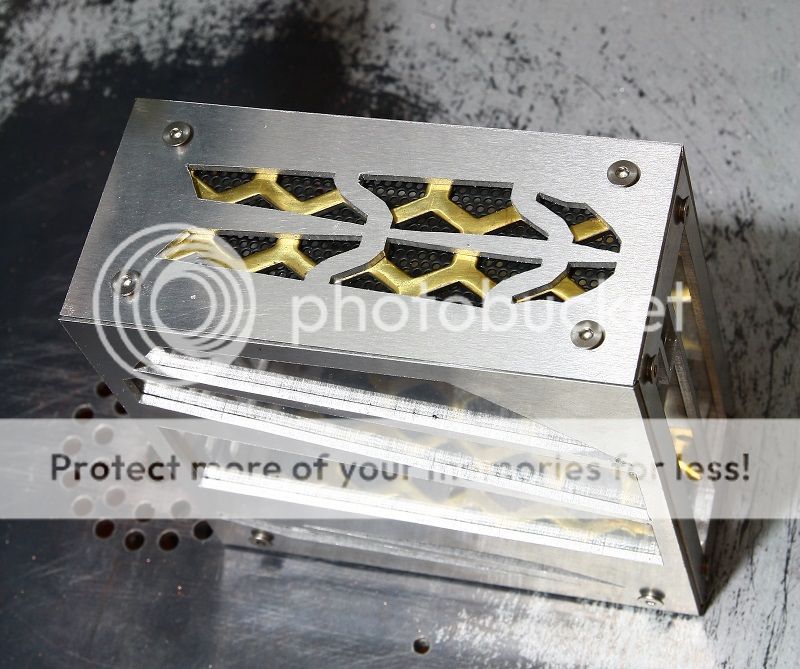

    This is incredible. Can't believe how small that case is. Definitely think you should keep the brass mesh that colour. Looks really nice.

    That color combination looks great together, and I like how you made the cooler.

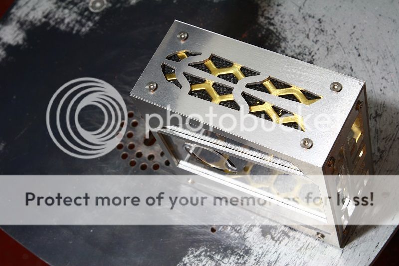

    It's a 3 way cross breed of the stock cooler, a titan & my own thinking, the titan is probably the best looking consumer GPU air cooler, I have revised it though now. :)
    I know, fits in the palm of my hand :D it's awesome & the brass won't be coloured, I like it too. :)

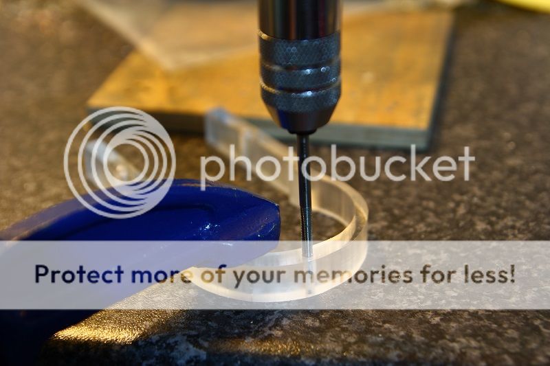

    Acrylic can be tricky, it's made me want to buy a compound table so I can clamp sheet materials while drilling with fine tuning of moving it about, high on my tools to buy list.

    I'd love a mill but layers work nicely too, thanks Mech, some colour tests will be needed on this because the silver alu does look good with the brass & copper, added turquoise to my dyes, almost got a complete set of main colours for making any colour now. :)

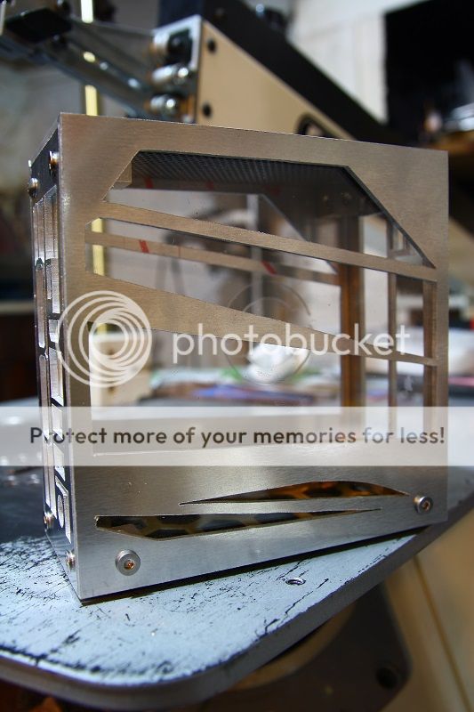

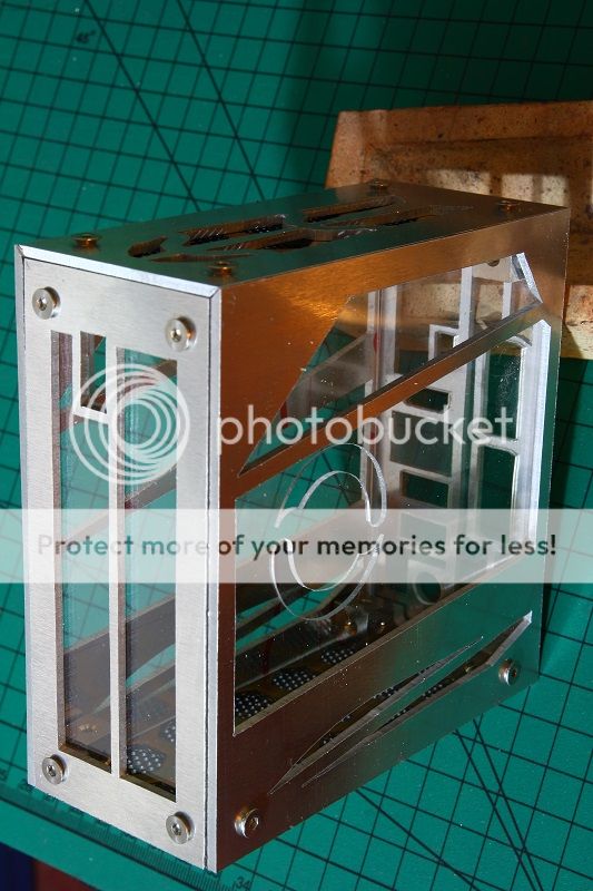

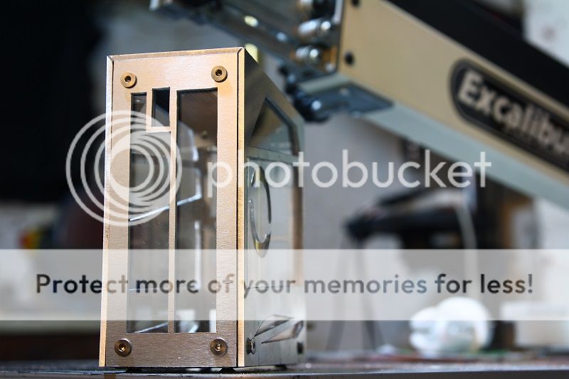

    It's about to change.
    But it's being improved.
    And I hope it's not just me who can see a surprised face in the original & a happy face in the remake. :hehe:

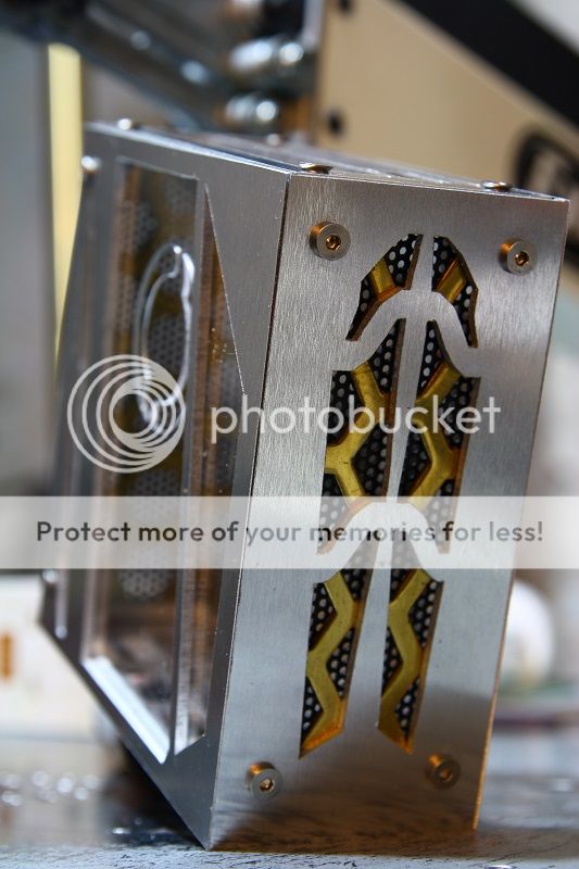

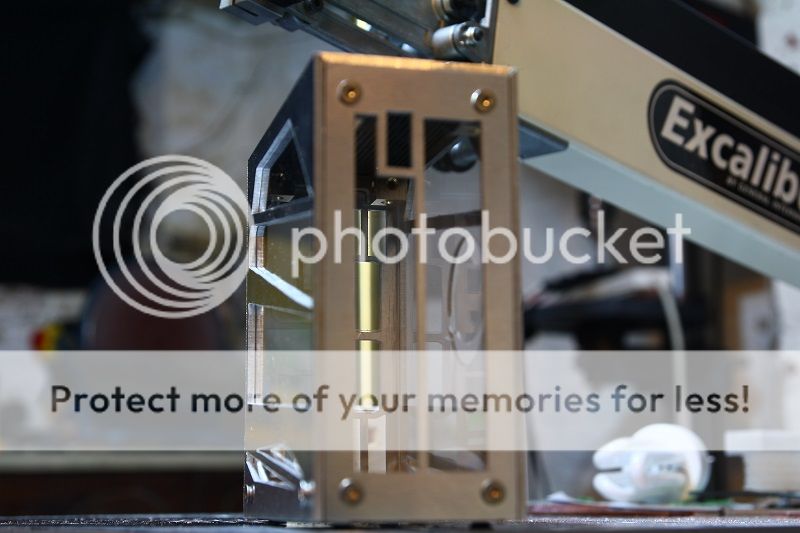

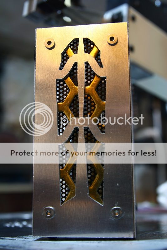

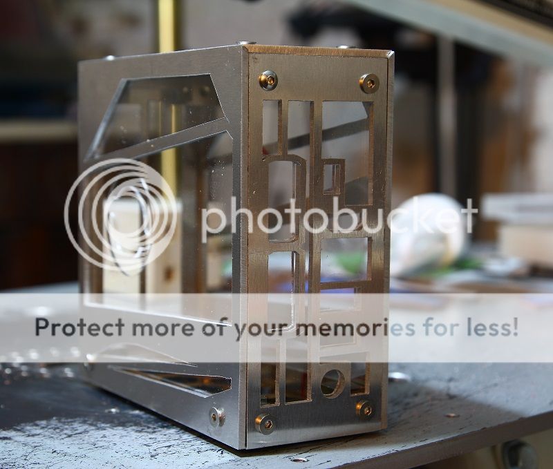

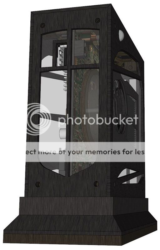

    This is the original front but with the USB in the correct spot, was 12mm too high so needed a remake, it's a remake so I wanted to make it better looking so it doesn't feel like Déjà vu.
    But before I found out some errors in the design I bevelled the top & side edges to see how it looks with the internal acrylic panels.
    And I tapped the cooler spacer so it can all fit together now as 1 piece, tapped it half way through from both sides.

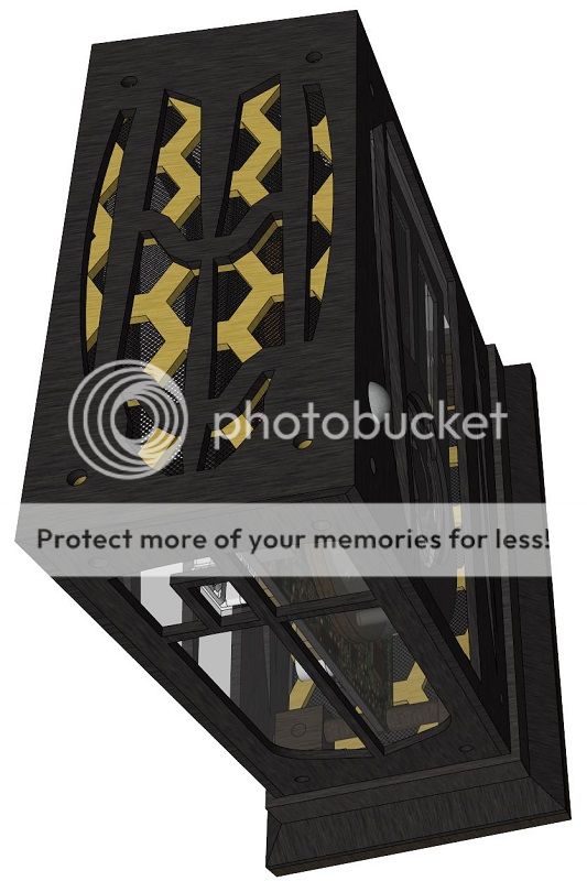

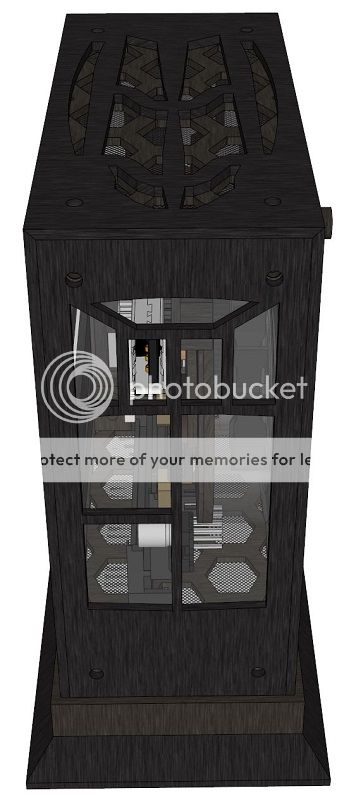

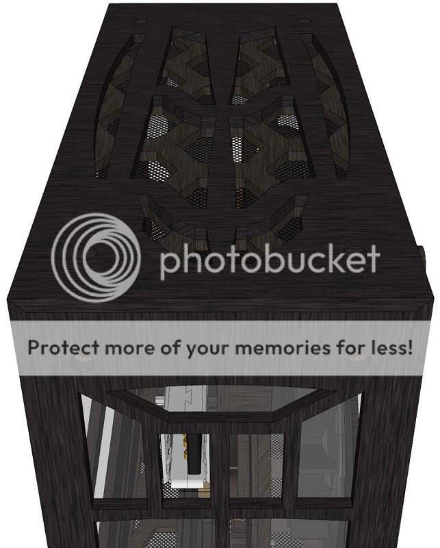

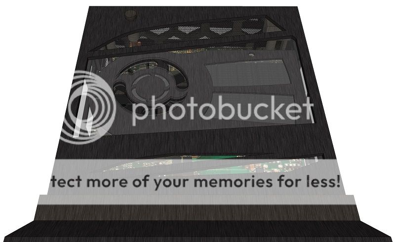

    Here is the original look for the last time before I make the new panels, this is with acrylic panels installed on all 4 sides complete with faulty placed front USB port & upside down HDMI lol.
    And here is the revised concept I'm about to make.
    Big session ahead.

    Looking great already. Are you planning to paint the aluminium?

    I have to admit I liked the original front panel. The square poking out of the top broke the "frame" of the square windows, and it was appealingly asymmetrical.

    I think everyone on here knows my feelings towards naked metal. :baby: Special feelings. Deep, uncontrollable feelings that when i see something like this i just want to..... Erm......:worried:
    Anyway, i think it will be difficult to find a colour that compliments the brass. A reddish woody brown maybe? Or maybe just a tiny smidge of black to dull the alu's brightness so the brass really pops out.

    Thanks Boorach, not painting but will be applying metal lacquer & dyeing it, I call it lacqodising because it's a really nice alternative to anodising that anyone could do, I still intend to make a guide for it. :)
    Thanks Mos. :)
    I was feeling I like the new revision but with you saying that & it being that which got picked I changed it again to be a bit closer to the original, I think you helped to make it better so thanks cheaps. :D
    Thanks Pranja, things are rolling on again now after the extra design going in. :)
    That's what I like about anodising & why I kept trying to work out an alternative since anodising requires dangerous chemicals & a good knowledge of handling them safely, it's transparent so keeps the look of the metal while giving colour control unlike paint which is like thick makeup completely covering the surface of the metal, I'll do a few colours & put a poll up for what people like most when I get to that point. :)

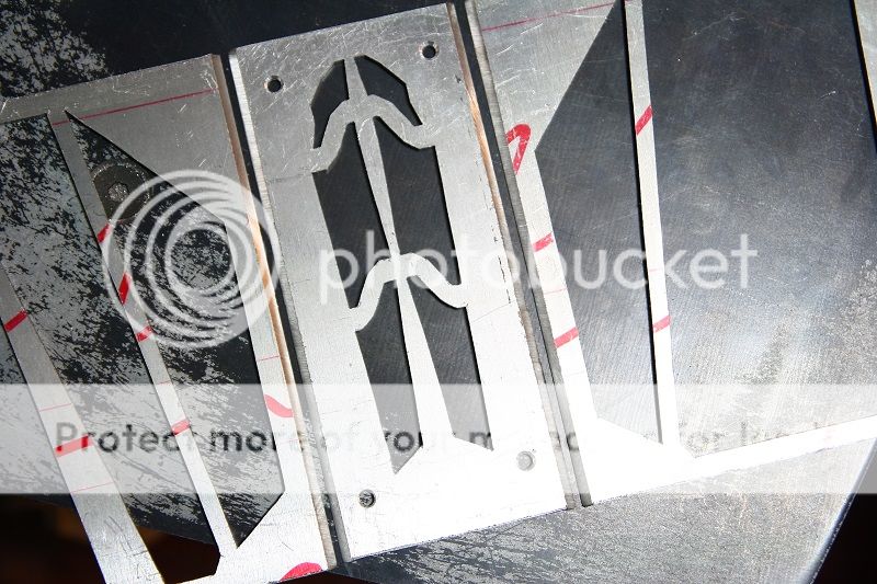

    Final changes.
    Entry
    Current
    Entry
    Current
    Entry
    Current

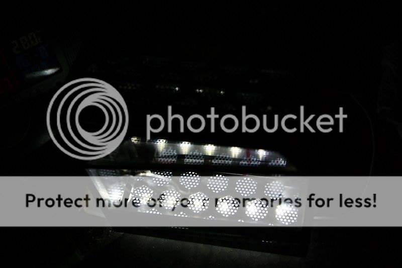

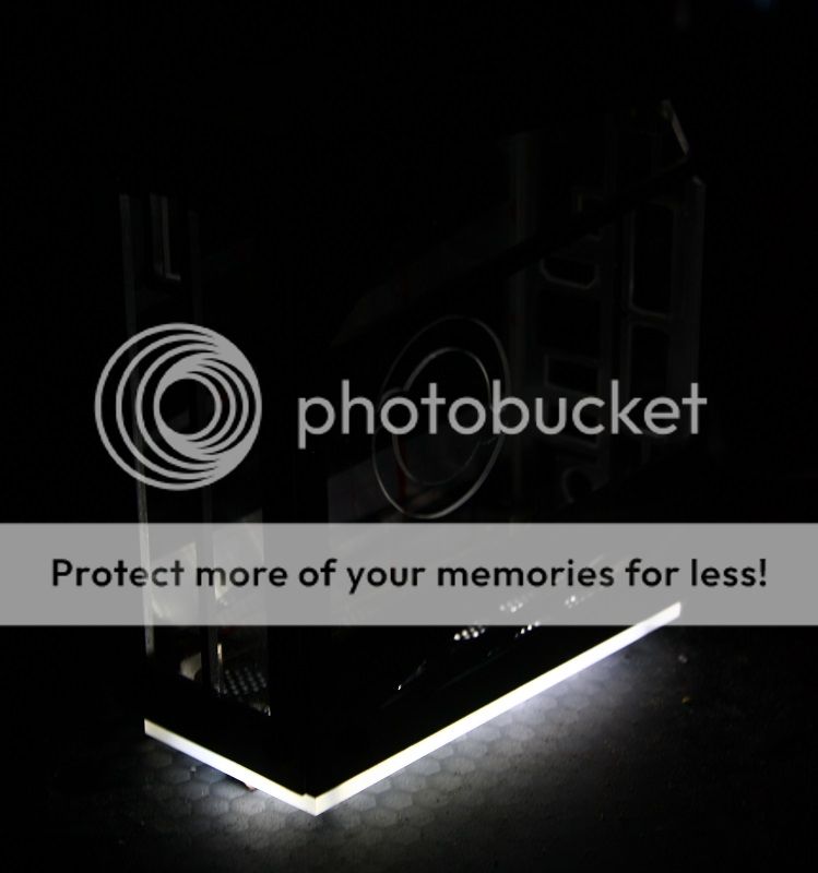

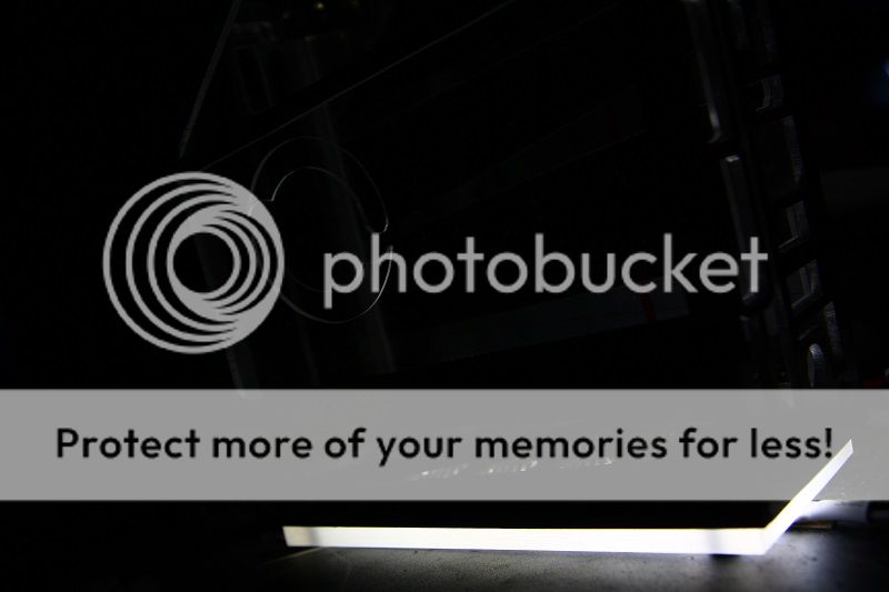

    Been doing a test with a 9v battery on a 100mm white LED strip & opal frosted acrylic, been running for 29 hours so far on a standard Duracell battery & it's still rated as good on the tester but it has noticeably dimmed a bit so would have dropped in volts but still plenty good enough to light the whole floor so I'll include this in the build.
    I'll be doing the external panels with 45 degree beveled edges so all the joining sides look near seamless, off I go to do this now. :)
