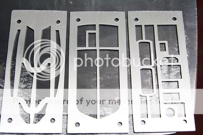

    Remade the panels so I'll get them uploaded in a mo. :)

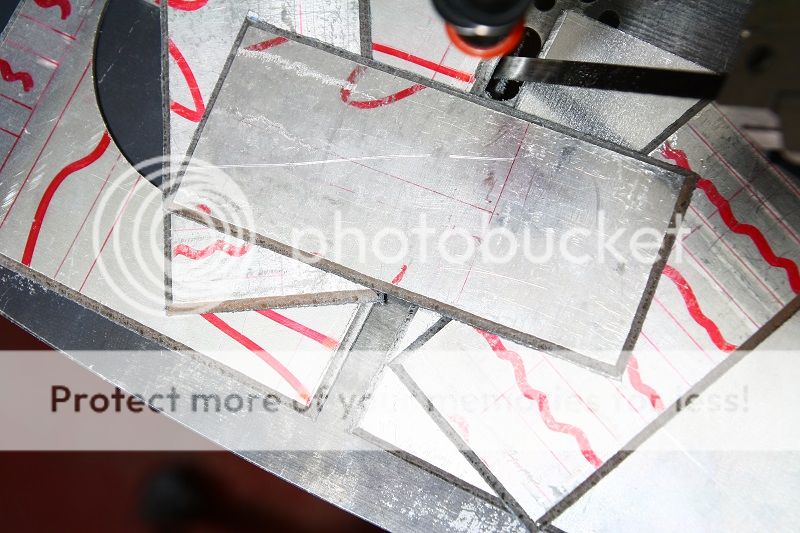

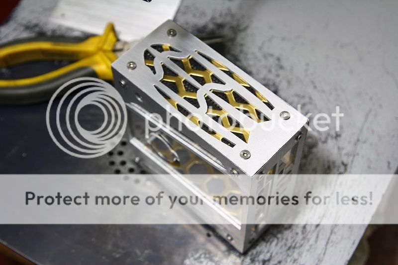

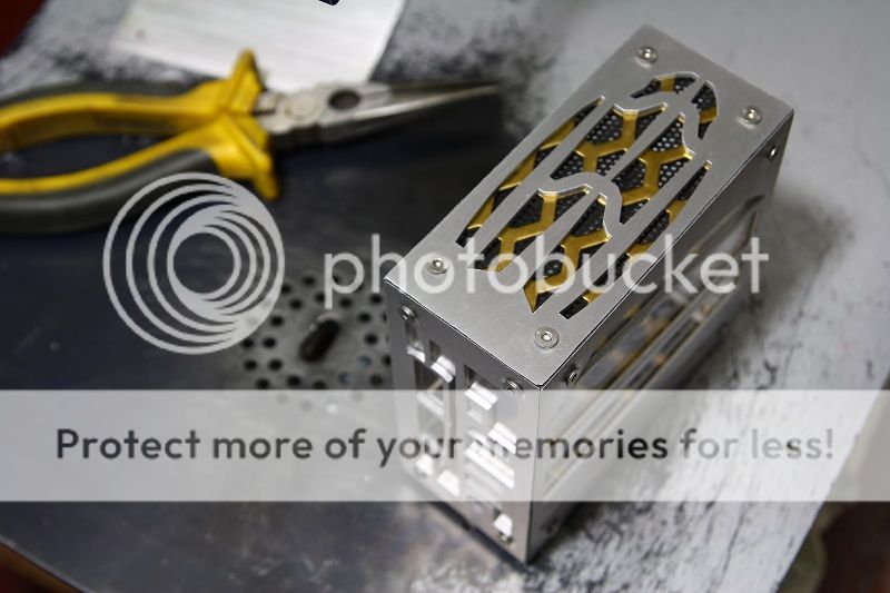

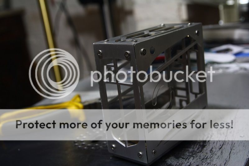

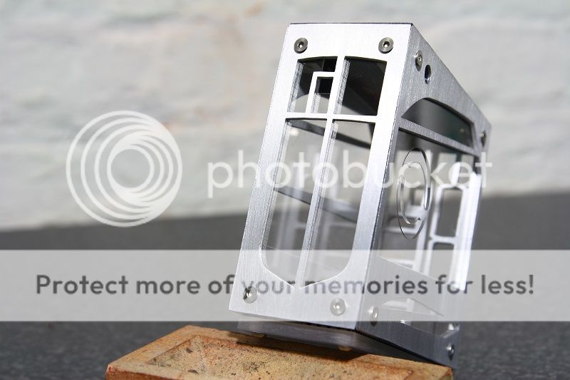

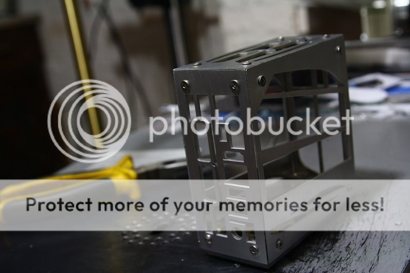

    Latest progress.

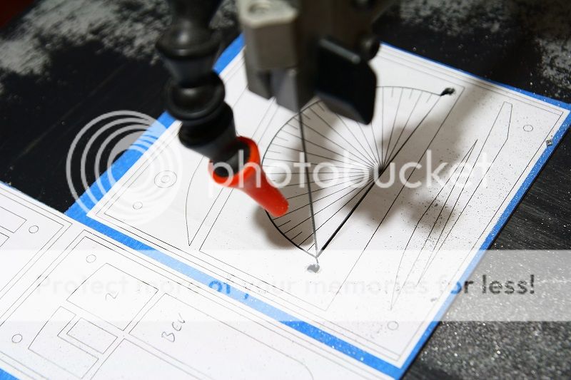

    Extension button, 8mm ball bearing, 12mm tube pictured next to my previous smallest ball button of 16mm.

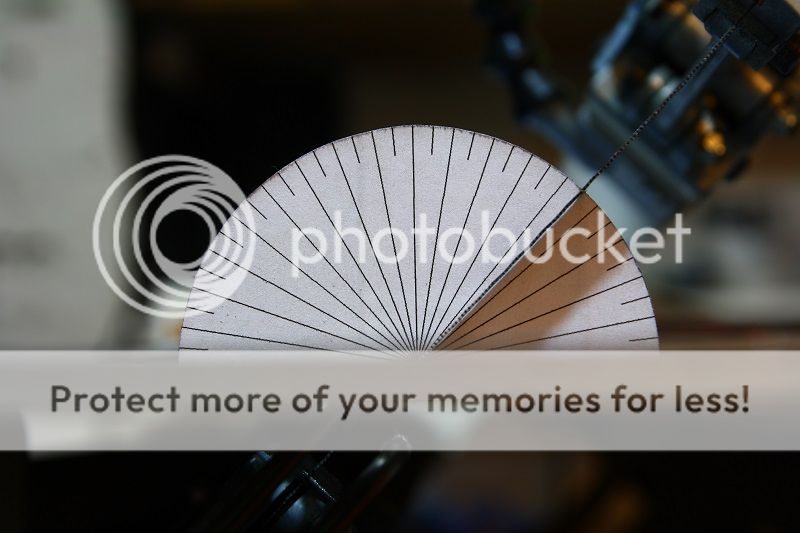

    Not got a protractor, it was the weekend but wanted to make double sure the angle was set correct so made one from a scrap piece from the future. :D
    Wasn't needed though, the angle was spot on from the machines guide.
    I officially do not like cutting angles though, rather than the worry about it gripping & flinging it up/down it shuffles it side to side ultra fast, far more difficult to maintain visual focus while trying hard to keep the cut straight. :lol:
    But I got the result. :D

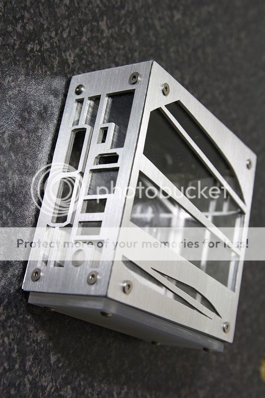

    Side panels after a quick rub down with satinising pads (does need more finishing), placed the 8mm ball where it will sit, the size is just perfect for this.
    Top, front & back.
    End of session shots.
    Got some size tweaking to do on this now so all the edges are close in together for an almost seamless look.
    The 9v battery light test is still going good enough to keep the floor lit up but quite a bit dimmer but it's passed 58 straight hours so far so will do even better with a duracell ultra. :D
    More soon. :)

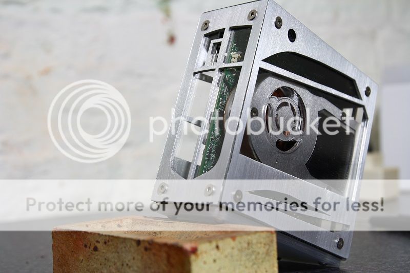

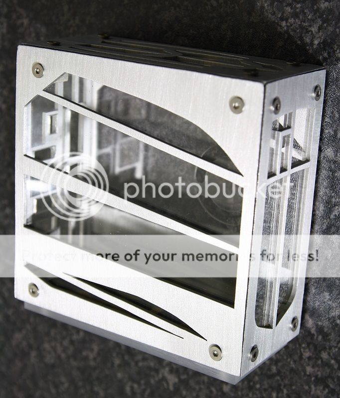

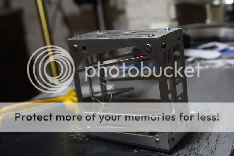

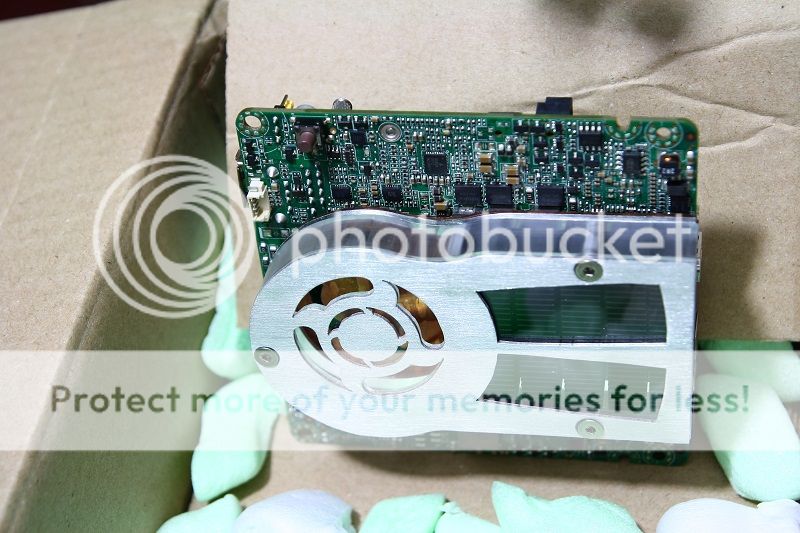

    Done a test fit of the NUC & the cooler before I go into getting the edges closer together.
    This was a .5 update. :D

    Thanks Maki, I'm just leaving them like that until I make the fit perfect & then I'll countersink, I'll also colour them the same as the case so they aren't as noticeable.
    Still need to remake a few bits & then shave some bits off here & there so it all fits nicer, then I can start on the base.

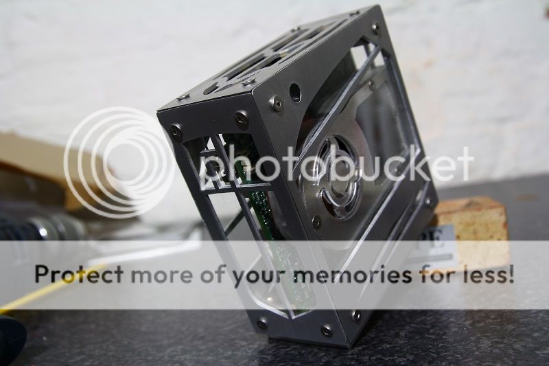

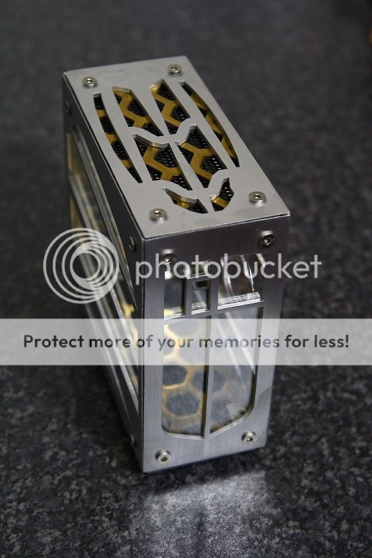

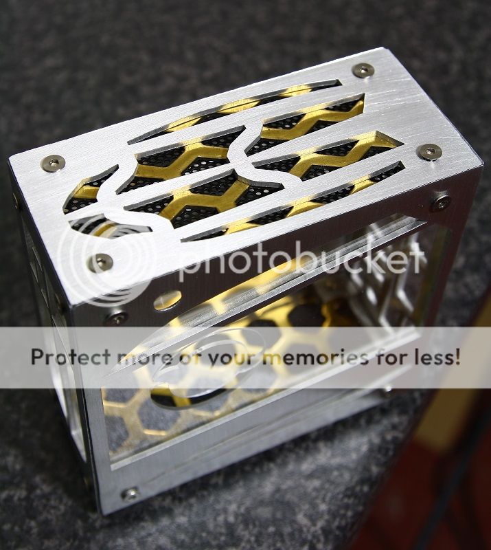

    Made the new 2mm cooler spacer to replace the 3mm one, made the new top plate for the cooler, the cooler still needs a few things doing.
    Made the new front & back window panels & done a load of time consuming fine tuning to close up the edges which still need more fine tuning but they are a lot closer now. :D
    Blah out the way, some pictures. :D
    More soon.

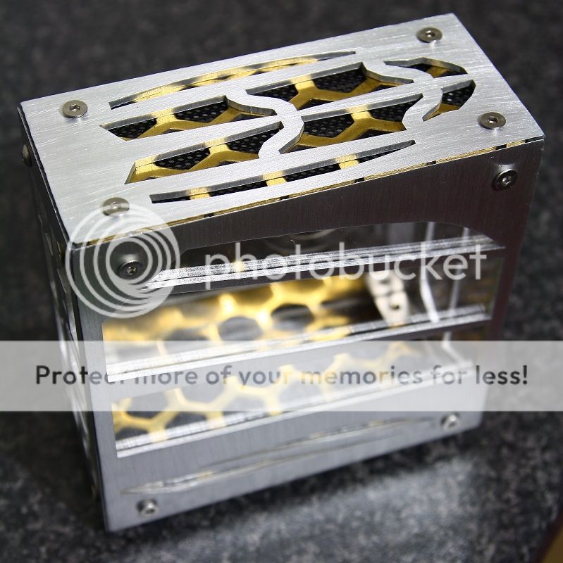

    I'm really impressed about the precision of the cuts you have done on the heatsink plate and plexi.
    I don't know if you noticed that, so I prefer to warn you, don't forget that the CPU die and chipset die haven't the same height! Don't forget to use a thermal pad on the CPU die if you plan to keep your heatsink base flat.
    You can see the height difference on this heatsink base of a NUC passive case from Impactics
    It's a detail but it could ruin the expected performance increase of the heatsink mod, considering the hard work you have done on it, it would be regrettable.

    Got 3 options for the heat sink contact levels.
    Stick with the rough mill drill job I done which works but is very rough. :D
    2 layers stuck together with thermal adhesive.
    Buy a compound table & clamp set to make for better drill milling.
    Time to do another session, got to get those edges closed in together. :dremel:
