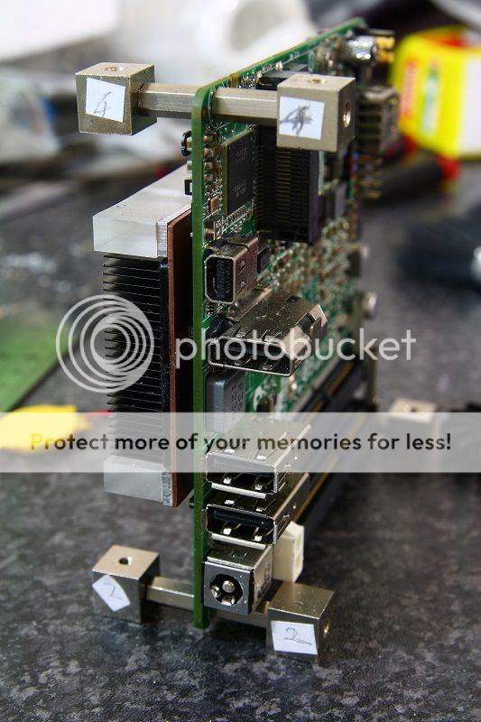

  9. Waynio
    Waynio Relaxing
    20 Aug 2009
    5,712
    211
    Update.
    Better look at the battery space in the base.
    Numbered the cube spacers & scratched lines to indicate the number so it goes back together nicely.

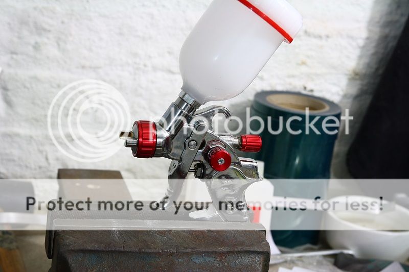

    24L Air compressor I bought a few weeks ago so I don't have to do the lacquering in the garage.

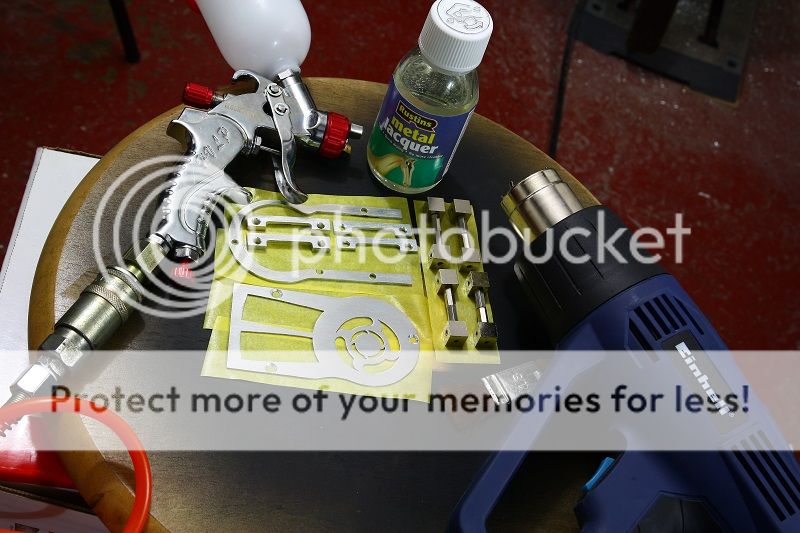

    Spray gun, metal lacquer, heat gun & first parts ready for lacquering on the lazy susan for ease of spraying from all angles, heat gun is for drying it faster.
    Spray gun holder. :lol:

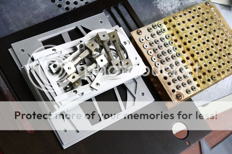

    More parts ready for lacquering.
    Lacquered screw heads, spacers & panels, not doing the internal sides because I need a dyeing tank to hang parts in, I'm using kitchen pans so can only do 1 side at a time.

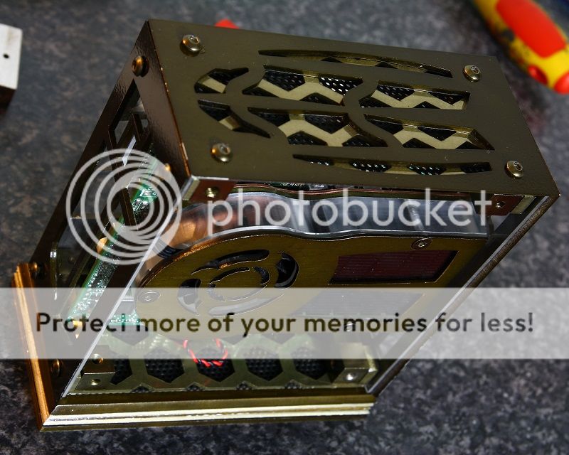

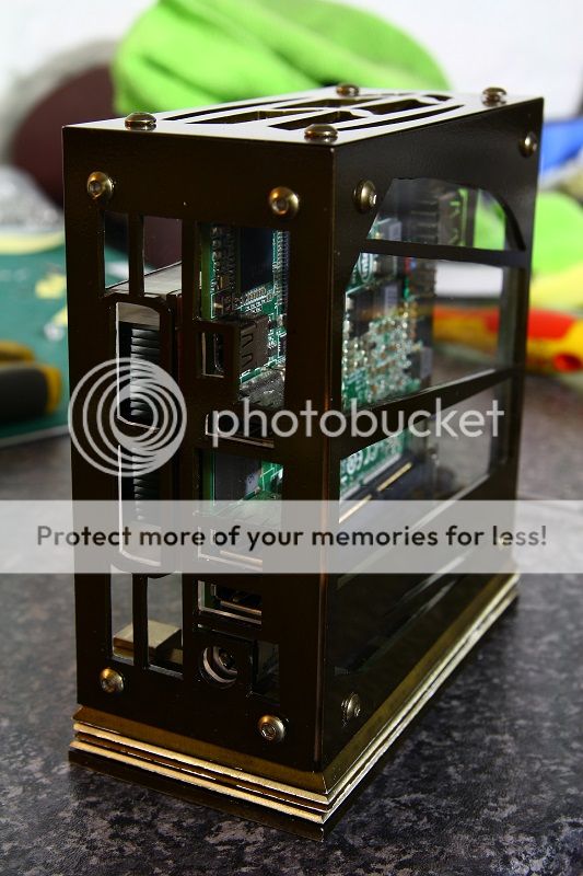

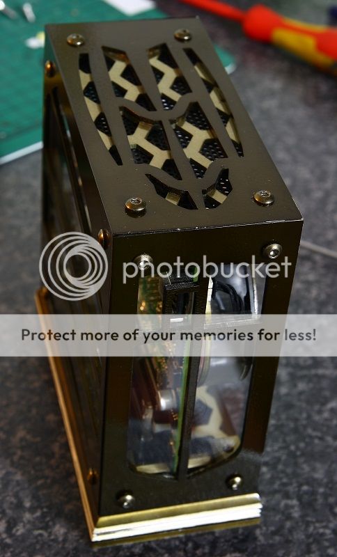

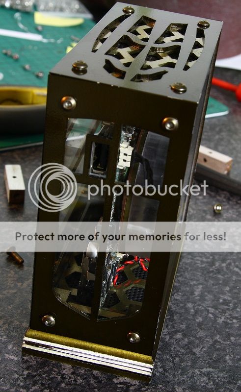

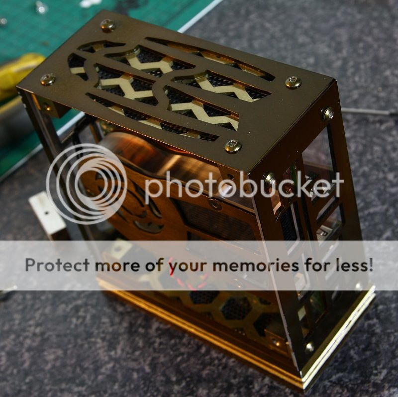

  19. Waynio
    Waynio Relaxing
    20 Aug 2009
    5,712
    211
    Here's the few pictures I said I'd post.

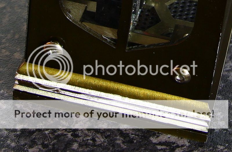

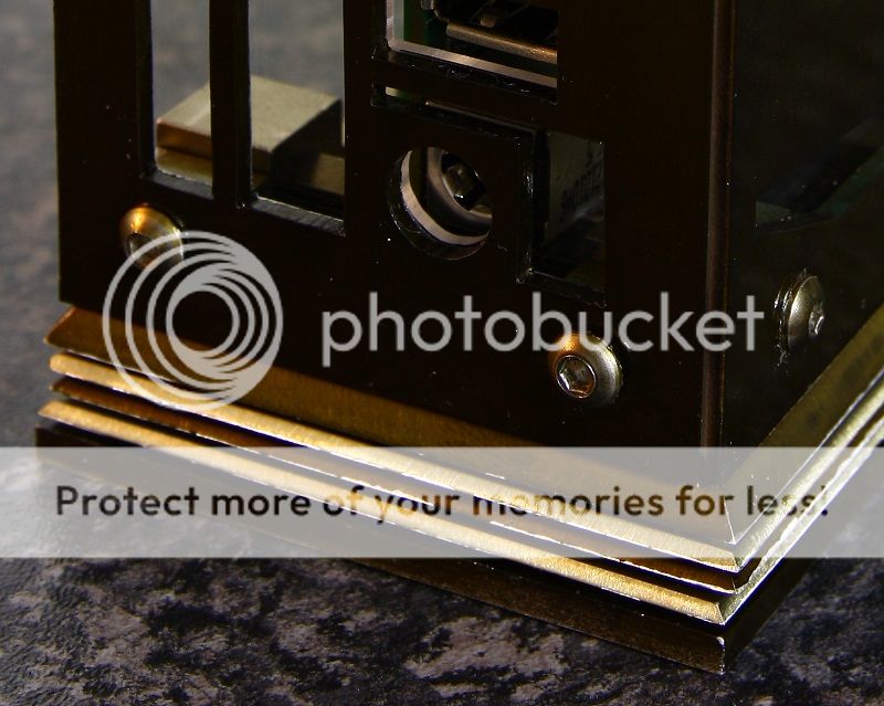

    Looks pretty sweet to the eye, not bad on camera but will be better on final photos with backdrop stand & lighting done right.
    But there are some flaws with the sharpest edges not taking the lacquer, well everything took the lacquer but I made a mistake on the application where I had to cut the panels away to free them & while cleaning off the fray bits with a brush quite a bit came off some bevels so I'll re finish them, this also means the internals will now get coated too but only lightly.
    Getting the cube & hex spacers to align correct is tricky but I think I'll get it right, first I need to sort out the flaked bits & round the very sharp edges so the lacquer can grip better, I'll get them ready for spraying in the morning.
