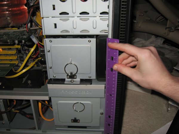

    It will fit in the lower front if you ditch both drive cages then de-rivet and remove the divider plate. Then possibly cut the front steel of the case a bit so that the upper fan on the radiator is unobstructed. Unless of course you made a shroud that adapted the stock fan mounts to the radiator.
    Here's me pointing to where 301mm is in relation to the bottom inside of the case.

    So, kenco_uk, are U saying that the size of the top compartment is 35cm (18 + 13 + 4)? That means I should have room for one DVD-RW drive in the top slot (35cm - 30.1cm for rad = 1 Optical drive)
    I want to leave the lower hard drive bay intact, so I basically want to install the rad directly above that. Could U possibly take another photo with ruler measuring from the top of the lower hard drive cage. It would be much appreciated.

    I'd say it's possible, just. Very little margin of error allowed, even if you give yourself as little clearance as possible above and below the rad.
