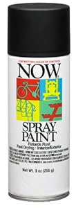

    For the paint job.. I used spray paint and I chose White, Black, and the famous Camouflage colour.
    Here. I cut some papers randomly for Camouflage patterns.
    And now for the results..
