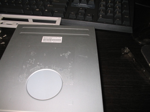

    Here we have out victim waiting disassembly
    Pulled apart and ready to go.

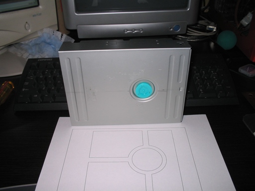

    The lid and my template I drew up in Autocad. A little bit of spray glue and the template gives you a great cutting guide.

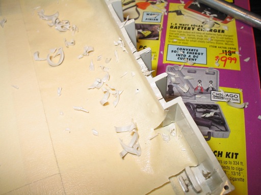

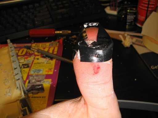

    This part kind of sucked. In order for the plexi to clear the case I had to remove a tenth of an inch of plastic from the base. Lacking the correct tools and it being too cold out at the time go outside and do this with a sander, I used an X-acto blade. It worked ok . . .
    Yeah the right tools would have been nice. Well I guess its not a mod without blood.

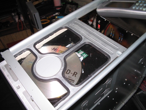

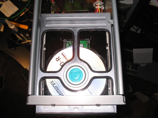

    Doesnt look bad here. Heres a fun fact: I couldnt find any edging that fit the drive correctly and I didnt feel like waiting and ordering any ( I was on a roll ). So I made my own. I took screen door spine ( the stuff used for holding window screen into its frame ) and just cut it lengthwise with an Xacto. $3 gets you like 20 feet of the stuff.
    Installed in my chassis.

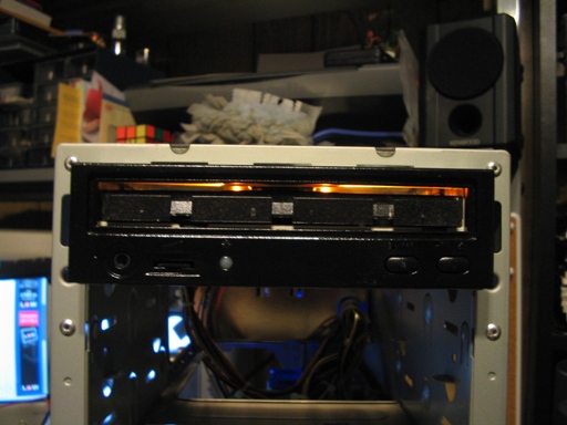

    In person the lighting effect looks awesome. The whole interior lights up and illuminates the spinning disk. However my camera doesnt pick it up too well. Here's a shot through the front to show the LEDS. I like the orange color alot in the case.

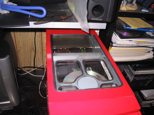

    Here it is installed. I've tested it by burning a few CD's and installing some software with it. So far works like a champ.

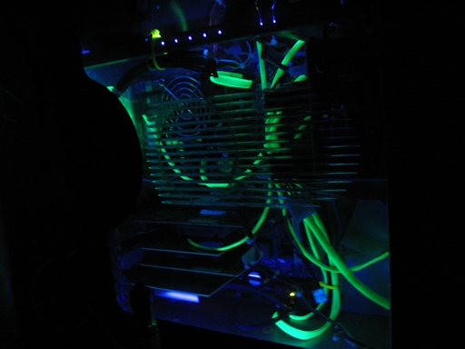

    And for fun a night shot of the case. For some reason my UV cathodes show up way bluer than they really are. This is before I finished sleaving the rest of the PSU. All thats left in the works is to add a blowhole in the top plexi and to shuffle some more cables around. I'll post some more pics in a few days.

    Nope one piece of plexi. I cut out a rectangle and then put a hole in it with a hole saw in order to clear the spindle support. The black stripping is just window screen spine that I cut down the middle to make a slit. I ended up making a little jig to do it with to make it easier on my hands. You could probally use any rubber tube thats like .150 inch in diameter and has a hole in it.
    Yeh I like nice simple geometric shapes for windows. Im big on cheap / simple / pleasing mods, and I think this one fits pretty well.
    And ellipr97 I cut out the window in the CD-ROM with a cut off wheel on a hand grinder, and then cleaned up with a dremel clone and files, and the window in the case itself was cut using a Jigsaw and cleaned up with a dremel. The computer case is thick steel so the jigsaw was a must. It only took me 10 minutes of cutting and cleaning for the computer case. Wish I could say that for the CD-ROM, that was a lot of dremel and hand file work.
