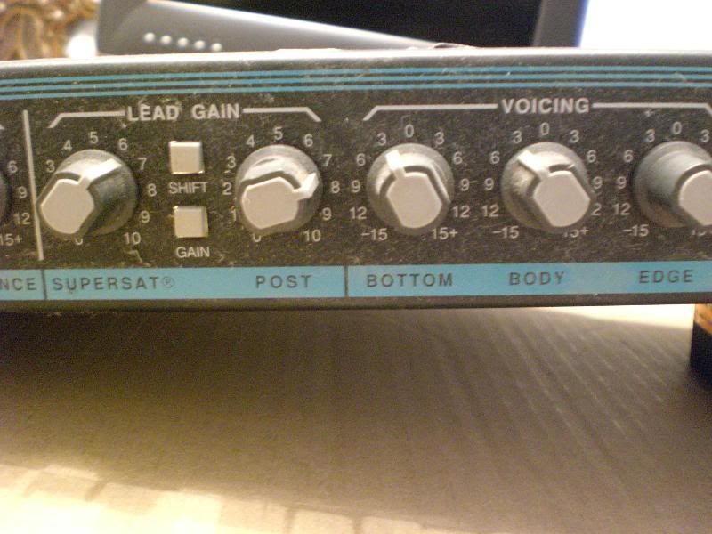

    You're right! My bad!
    I also forgot that I'd like help with cleaning the control panel of accumulated gunk:

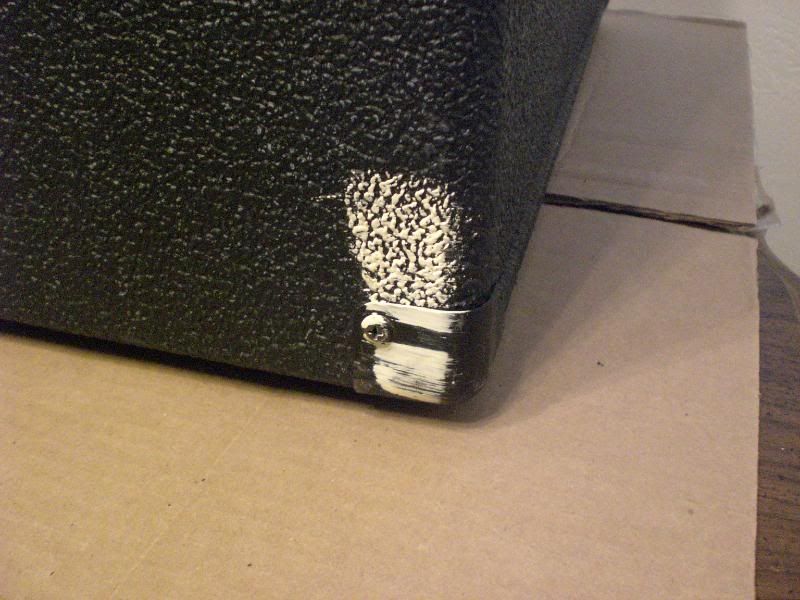

    Exterior stuff:
    @matticus- I'll try the soapy water, can't hurt, eh?!

    Better. At least it's not one of the red vinyl metalflake amps. These cases are usually pretty durable. Soap and Water first, the try a mild plastic cleaner like those from Plaskolite, after that try an Automobile cleaner wipes like the tire wipes. I forget the name but they have vinyl interior wipes.
    john
    /edit
    Armor All Cleaner - not the stupid fake looking "make my stuff shiny" bottle. The leather cleaner works great on leather seats without changing colours but be warned - makes them slippery.

    If the paint dab on the side is latex, then Dow bathroom cleaner (scrubbing bubbles) on a toothbrush will remove it. If it is oil-based paint, use mineral spirits.

    I was removing primer and polish from the same sort of surface, a sort of bobbly plastic on my old moped, bit of white spirit did the trick
