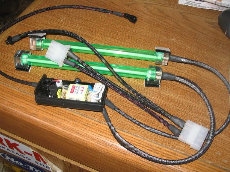

    Hi,
    i buyed TRUE-GREEN 6" *DUAL TUBE* Cold Cathode Light KIT and i just unplug the wire to put this black thing that you can see on the picture and i remember where the wire had to go but the cathode doesnt work anymore :duh: Anybody know what could be the problem ?

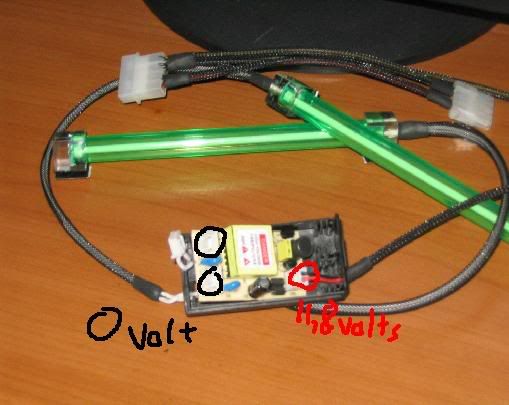

  11. Well33t
    Well33t What's a Dremel?
    13 Jun 2004
    97
    ok, i think i found the problem :
    but i dont know how to resolve it :duh: you see that there is no volt in the little card. So, somebody got an idea to repair this thing ??
  12. coorz
    coorz Miffed
    25 Apr 2003
    1,382
    Well you could just buy a new inverter, they cost very little.
