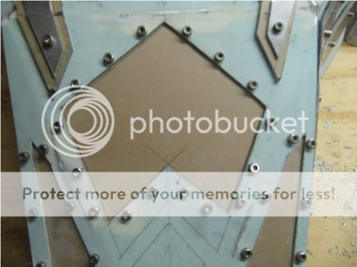

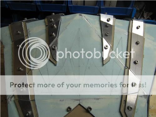

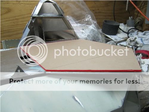

    Update: Window Pre-Design
    Hello. So I'm moving onto the windows of this case. I put a poll up to get a feel for how people are viewing this case from a design aspect. I'm really torn on whether or not to put windows in. I originally did intend to do so, I took a step back and I am really wondering now.
    I did some sketchup on the case though with a pencil....
    That pyramid triangle in the middle will be an opening for the fill port. The rest will be windows.
    my tools of the trade.
    side windows.
    Now jus what to do???:wallbash:

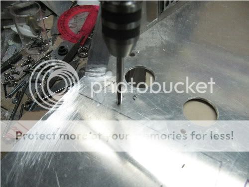

    Drilling for the motherboards mounts
    Got all the mounting done.

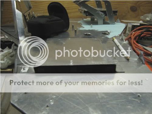

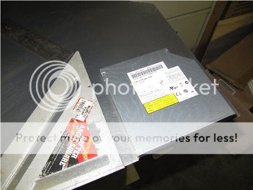

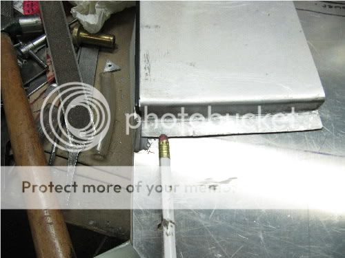

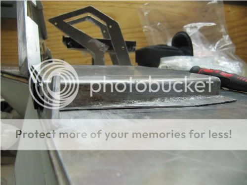

    Aelro Dynamic: CD-DVD work
    Where has the weekend gone. First it was the time change this morning and now I have run out of room on Bit-Tech for image hosting:nono:!! Onto Photobucket...lets get to the log.
    I know I have jumped around a bit in fabrication, though I did a general plan from the beginning and as I fabricate I move to the final position of where everything is going.
    Today it is the CD-DVD burner.
    It is a Lite-On burner that is 5"x5"X.5"

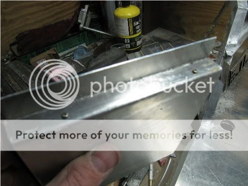

    tracing and cutting for a bracket to go around the burner. I may add a window in.
    Bending time. I tryed using my small by hand bend press. It worked only for the one bend, the other bend I had to do it the old-fashion way with a hammer and some heat
    final result
    jus got to notch this corner out so it will clear the hold down bracket. I forgot to take a pic. I get one though:wallbash:
    Measured and drilled
    Looking like it is going to rock and roll
    bye bye
    Used a small cutting disc for more control and it gives a straighter cut.
    It fits:clap:
    Now jus to mount this burner down
    Glad that is all in. Though I'm not done yet with these pieces
    Enjoy.

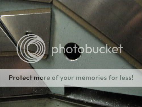

    Update: Backlighting the Motherboard
    Update:
    I going to be backlighting the motherboard, but first I had to cut some holes for watercooling tubes for the pump and power.
    the holes that need cutting.
    the hole that was cut for the watercooling pump's hoses.
    time to backlight that motherboard
    This is going 2 be awesome:jawdrop:

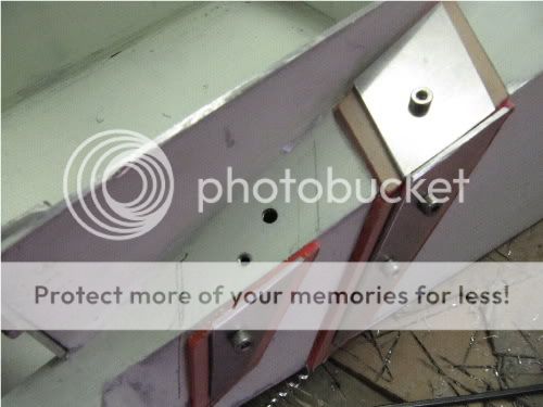

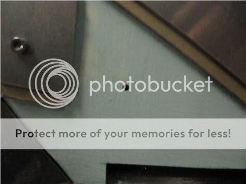

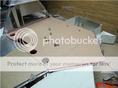

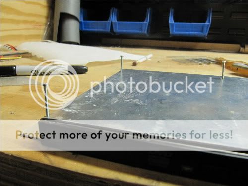

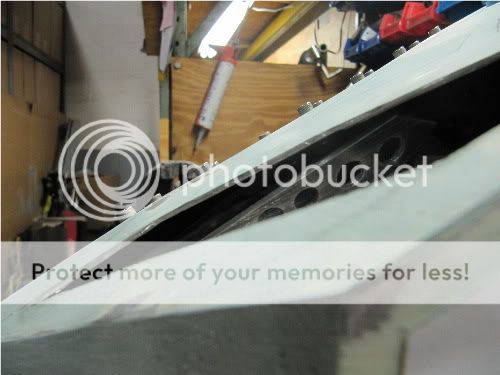

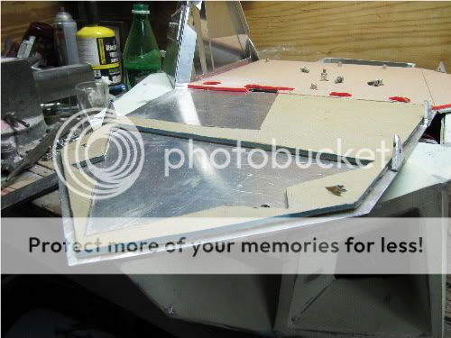

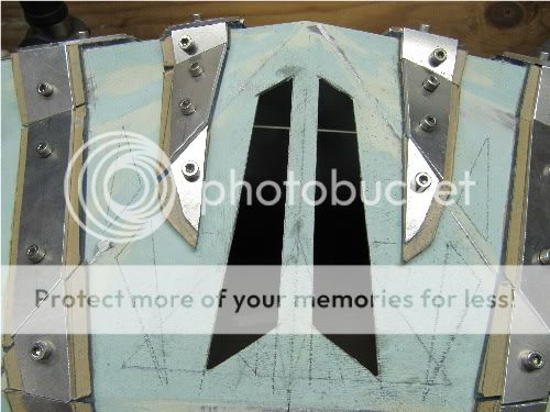

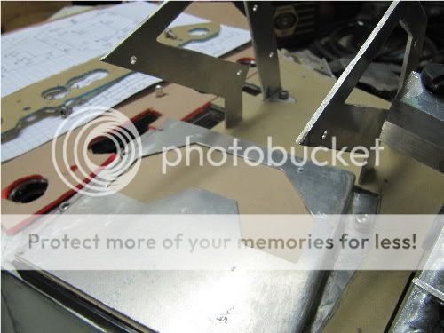

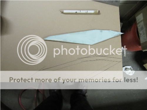

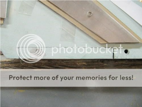

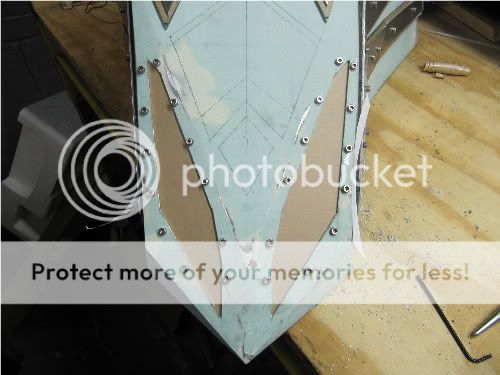

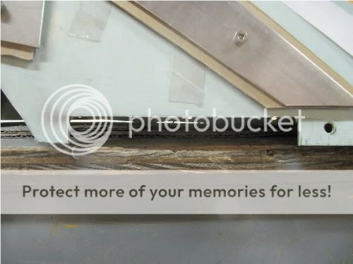

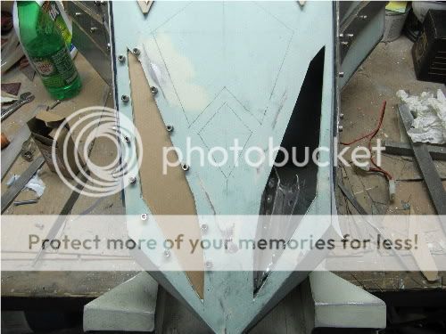

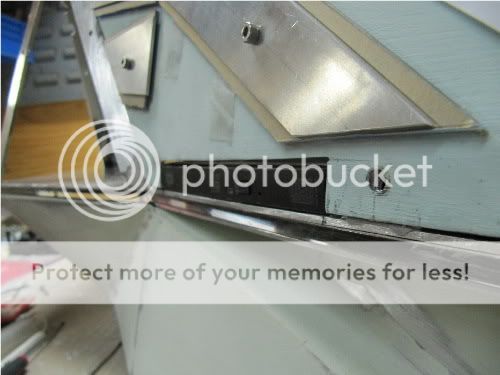

    Update: Windows Part 1
    Hello! I've been very busy with real life stuff and working on this case. I'm just going to start with the Windows...
    So I ran a poll and I decided to put windows in. Lets hope I'm doin the right thing. I dont want to have to refabricate this cover.
    I cut the first piece out and traced it. There is a 10mm gap on the outside edge for the bolts holes
    Drilled and Mounted. This is looking Great!
    Wow, the Resvoir just fits.:thumb: I think I got a 1/16th of clearance
    The holes are drilled for the other side. All I do now is jus cut the piece of Arylic and drill the holes out after I marked them off with a pencil.
    Looks Great!:rock:
    Whats up next...
    Enjoy

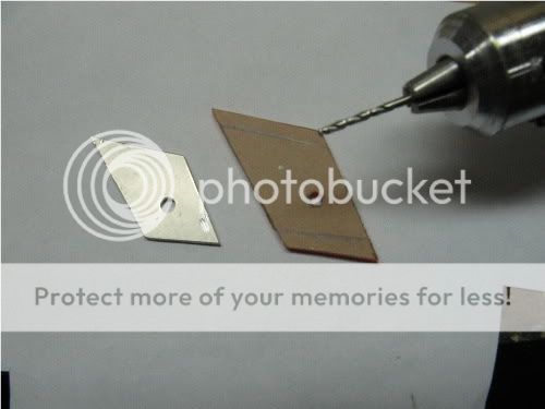

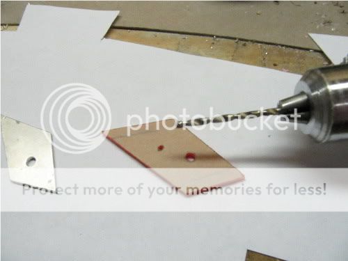

    Hello! Time for a big update.:clap: Been busy fabricating with the case. Haven't had much time to sit done and do some logging. Thanks for all the comments!
    These are the back lower accents. I doing some mounting and drilling for the LED holes.
    Drilled the pilot hole in the pic above this and than traced the hole to the frame and than drilled this hole
    There are two holes one for the bolt to mount the accent and the other for the LED
    As you can see there is other accents already done. I jus chose to show how one was done and the process is the repeated the same after that.

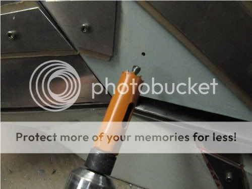

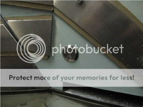

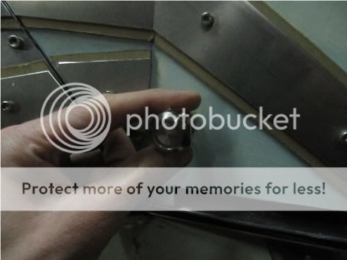

    Power button!
    Pilot hole
    3/4" hole saw. Did the trick:dremel:
    Final hole cut
    Installed:clap:

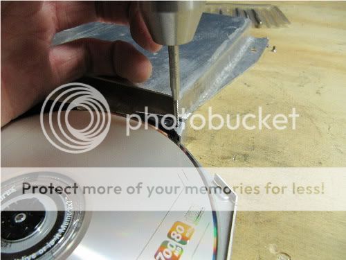

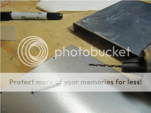

    Time to window out the Slim Dvd Drive. I am a WARRANTY VOIDER!:nono:
    First I have to drill the old holes out so mine can accept newer bigger screw heads
    That is a 1/16th drill bit
    Taping with 2-56 tap.
    Looks great. These screws heads will be cut down.
    Cut out the window hole. Simple design.
    Completed Drive with window.
    Enjoy

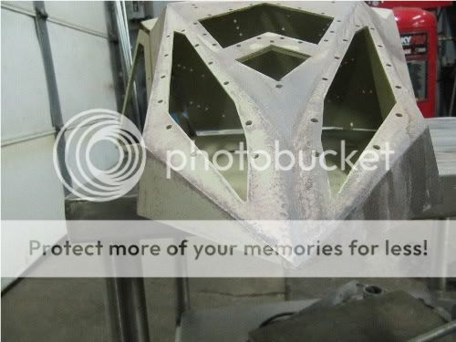

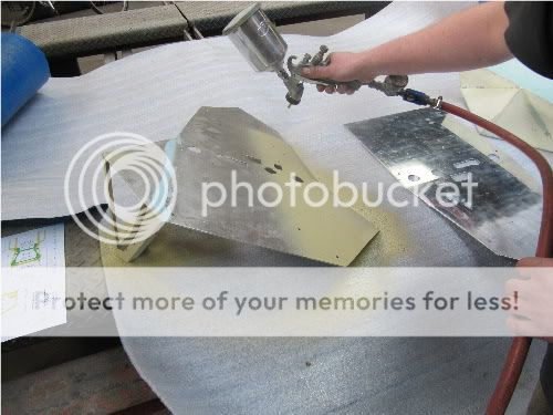

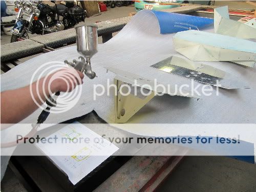

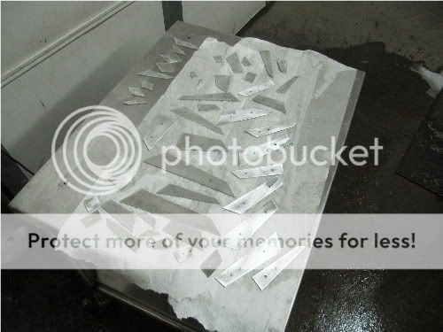

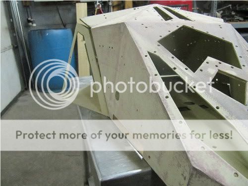

    Update: Paint Part 1

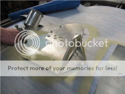

    Hello. I have been gone for a minute it seems like. Been busy doing small stuff to the case, though the time has finally come to Paint:clap:
    A HUGE THANKS goes out to Rex Auto Body for helping me out with all my Case Projects!!
    Lets go....
    Outside the shop, feelin the hangover from the night before

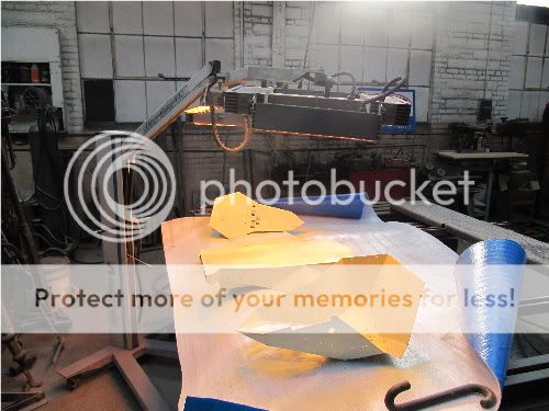

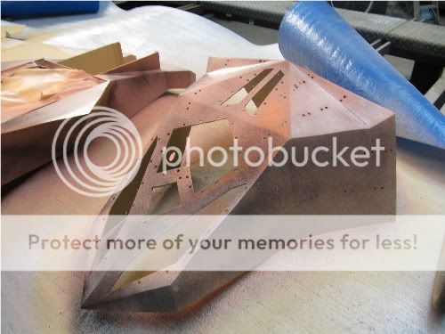

    Put the case in pieces on a lift and started to shoot some primer
    Did the underside of everything first, let it dry under the lamps and flipped it over
    Curing under the lamps. Those things are sweet.
    Shooting the top of the case
    After the top was done with primer, we went back and shot this Glide coat, so when I sand
    I know where I am at with relation to the metal and bondo.
    Time to sand out the primer and get it ready for paint next
    Stay Tuned I got some awesome One-Off custom colors:thumb:

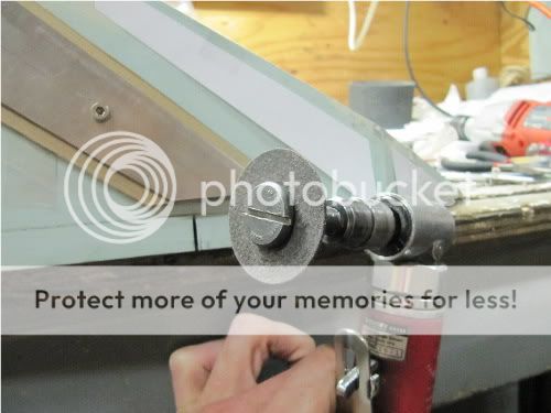

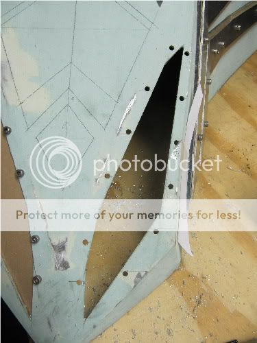

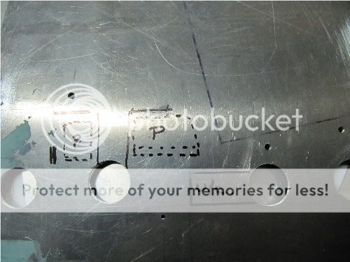

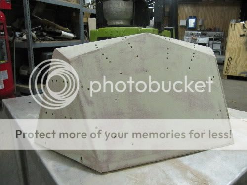

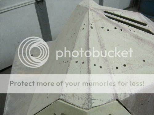

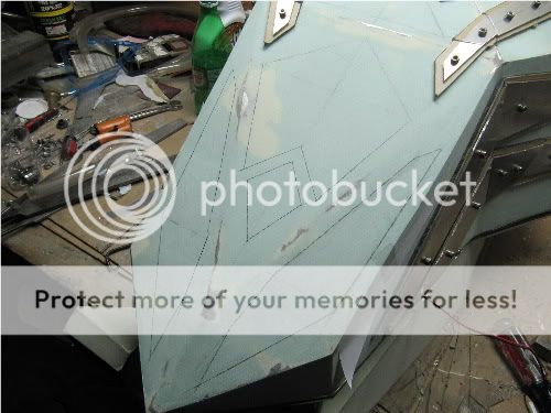

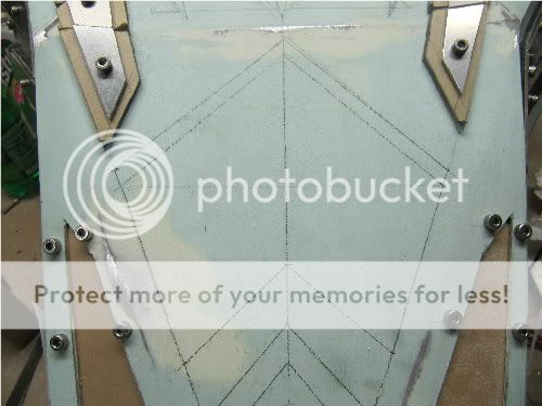

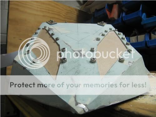

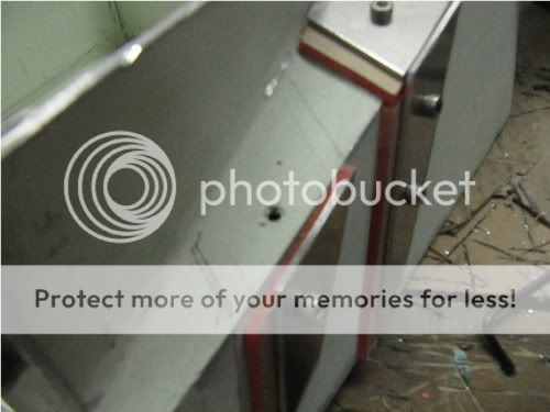

    Update: Sanding Primer
    Update: Sanding Primer. I left off with the glide coat on needing sanding off. Some of the pieces did not have the glide coat so they just got a regular sanding. I am using 220/320 grit sand paper. The final sand will be wet sand with 400 grit.
    I started sanding. I wanted to show the difference between sanding the glide coat off and the glide coat still on.
    Went to town on the front of the cover.
    As I made my way to the back of the case. You see that I left lines on all the seams. This is for
    when the case gets painted. At least that is what I am told.
    Leaving the seams with a little raised edge is really going to give this case one hell of a look.
    Down the sides...
    Lastly....
    I will be putting these all on a wire to get painted...Stay Tuned
    Enjoy
