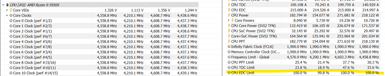

    They're doing prime avx and base limits of that, loads you likely never stress too, though maybe tesseract is, that prime run was what I did the other day to test my pump, my 105w chip was sucking down 260w according to hwunfo, with a bit of PBO, CO and a SOC bump, it never sees anywhere around there normally even when doing full bore video processing.

    You are probably doing well and Tessseract is just an intensive load, I see similar doing stress testing with my 5950, low loading chip is happy in 4.7-5Ghz range but all core is obviously a lot more taxing, some loads pull that clock down, I just fired up my a stress test on mine for half an hour and reset hwinfo to see its behaviour and yup it too drops quite low on some workers, 4.2 in my case, my machine is sat at its EDC limit 100%, thats fine, I could up EDC a few more Amps but I think 270w PPT is enough, if I want more power there are better chips out there.
