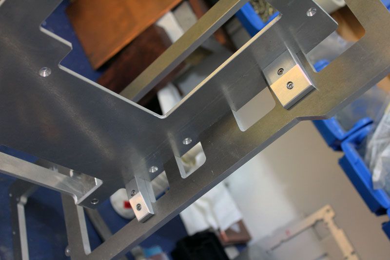

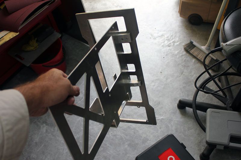

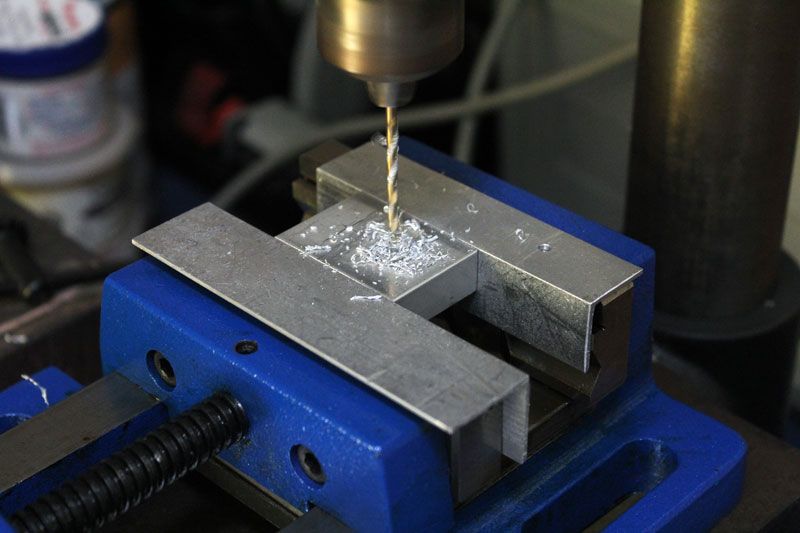

    Mounting the central plate to the bulkheads was always going be 'drill and screw' directly. But as you can see there is not a lot of room to get a drill in. I looked at some right angle adapters but these fit to a power drill and would have been unwieldy to use and get an accurate result. Anyway, I decided to make some mounting blocks and this made the job a lot easier (though much more time consuming).

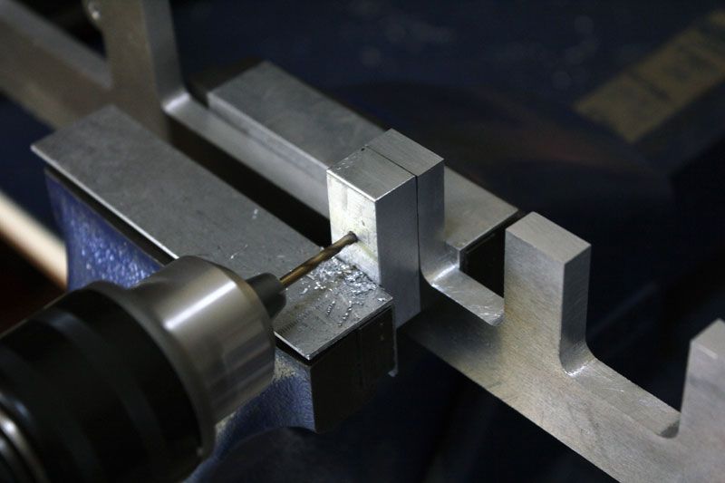

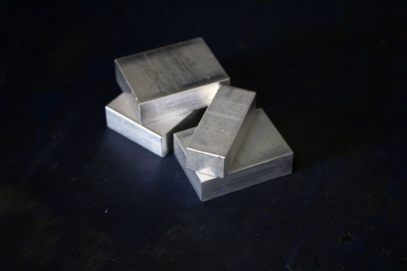

    Some blocks were cut from a piece of 12 mm bar I had laying around. Filed and drilled.

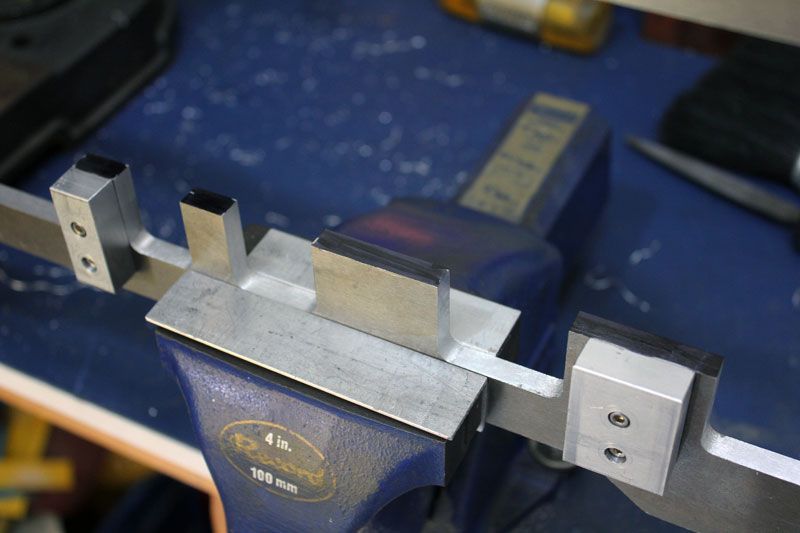

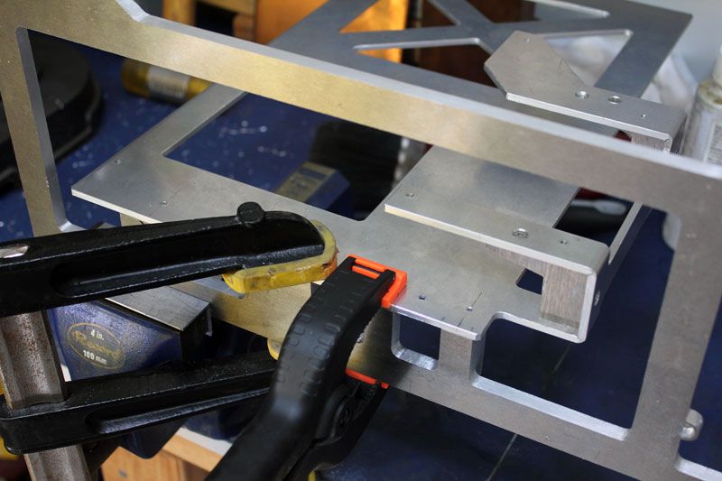

    These were then clamped together with the two bulkheads, just a fraction higher so that it can be filed down level later.

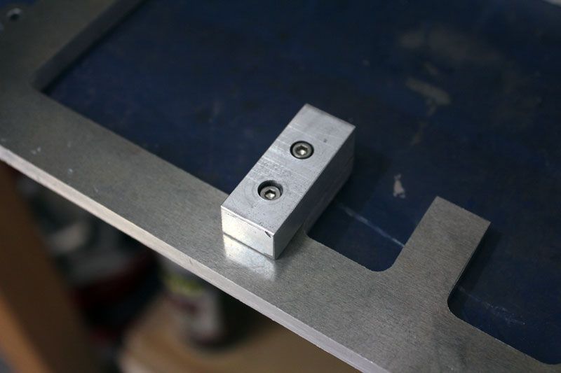

    After the blocks were mounted, they were filed level. Here I've used a marker pen to give me a clear picture of the progress.
    Then some holes were drilled in the central plate.
    And the blocks made more interesting.
    And yes, it's very strong and not very heavy. :D
