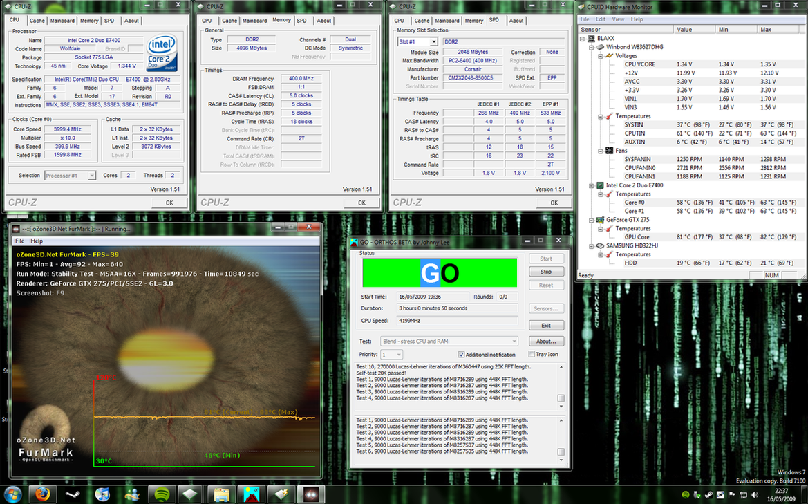

    Right, got this to happen :p
    Strange thing is Orthos and W7 Say my CPU Speed is 4200Mhz, but i know its 400x10 and CPU-Z Shows This.
    Only thing is, the RAM is now running at 800Mhz, not 1066, Dunno how to make the RAM Run faster, and if i would see a performance increase anyway.
    Was just Running FurMark to see what temps i Would get at Full Load.

    thats perfect, I'd keep that fsb at 1600.. 1:1 at 800- what I mean by tighter timing is.. try 4-4-4-15 on the memory and see if she stays stable.. you can keep playing with this for the tightest ram timings at 800 instead of trying to run @ 1066 and looser 5-5-5-18..
    keep the 2T command rate too.. you can usually get away with 1T at around 750 and under only
    if you type winsat mem into the cmd console (run as administrator) you can get an idea of what your memory copy speed is like with different settings..
    alot of newbies think.. oh it's running faster speed therefore it must be faster- but if you look at the looser timings, it negates the performance you just gained alot of the times using tighter timing, lower speed.. winsat will give you a good idea of your actual performance
    have to say gj =] pretty good oc for a new guy

    Nope, the Voltage is set to 2.2, higher than what the RAM says, but 2.1 didnt agree at all.
    And i save settings to the OC Profile if they are stable, i have one set basically default, and one set at my last stable settings.

    Of Course i have controlled my CPU Voltage! Thing would probably be fried. Its set at 1.32, it was stable at 1.3, but unstable at 1.29, so i bumped it up a little.

    Oh ok, i dont think i mentioned it, but it can be seen in the Screenies.
