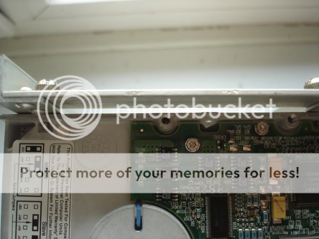

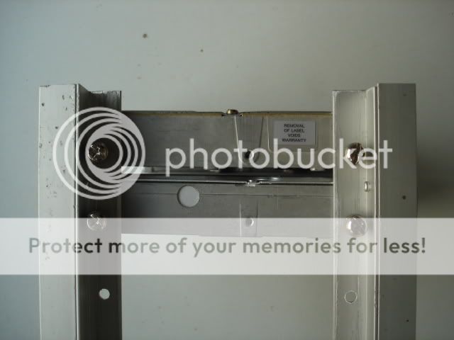

    The rail where the HDD's are mounted on is finished. Finally, took too long because i hate metal work. here some shots of the rail.
    As you can see in the following pictures the first HDD is a tight fit. The first HDD is 4 mm away from the rivet and i mounted the aluminium strip on top of the L-profile. If i did it under it the HDD wont fit.
    Also the HDD's are really tight together. This isnt gonna be a problem because the HDD's are gonna be cooled by some fans.

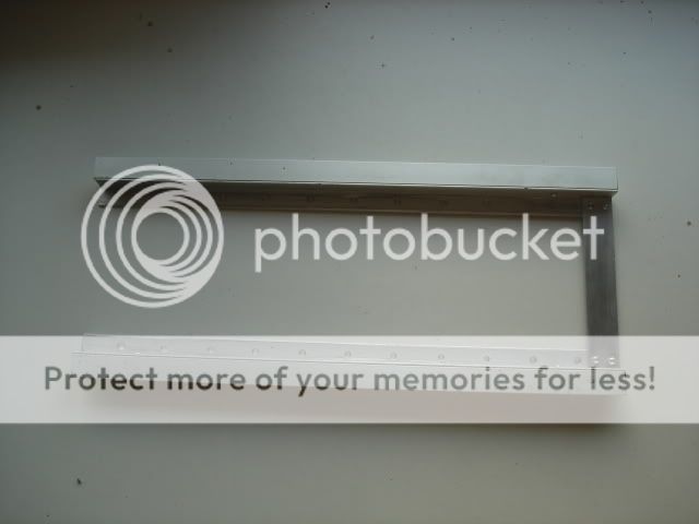

    Today i completed the HDD rack. I needed to make parts:
    These parts.
    I have mounted an aluminum L profile on a piece of wood. This was because i changed my plan (thanx maRiio!). I first wanted to hang the HDD's against the mobo plate, that wasnt a good plan because i dont trust MDF as secure mounting of the weight of 11 HDD's.
    So this part wasnt needed anymore. So this part has been re-sawed (is that a word?) for the wood parts.
    During transport the HDD's still need to be kinda secured. So i made a aluminium L-profile onto the wood. There is a little space for mounting.
    The HDD holder slides inbetween the wood and the aluminium.
