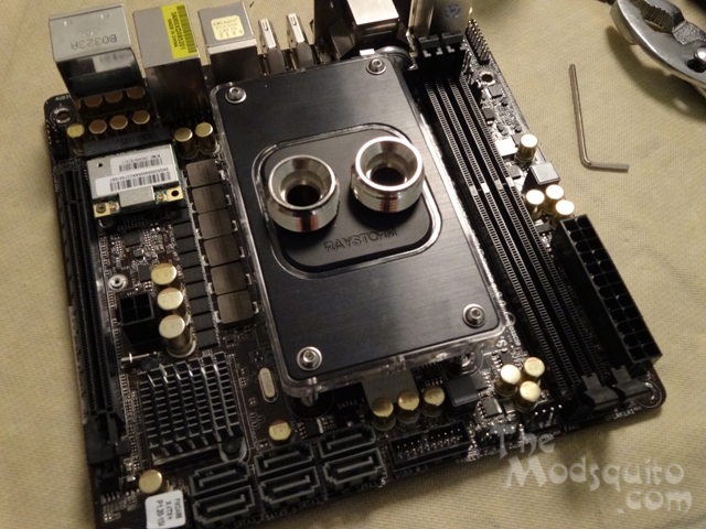

    Ok, it's been an unexpectedly very busy last couple of weeks, so I apologize for not getting an update out sooner.
    Things are coming together quickly, in the few times I’ve been able to make actual progress.
    First, time for some hardware. Picked up an A10-7850k from Micro Center when they had them on sale ($129.99 is hard to pass up!)
    Unfortunately, Micro Center didn't stock any of the ITX FM2+ boards at the time, and newegg was out of stock on Gigabyte boards.
    I ended up going with the ASRock FM2A88X-ITX board. All in all, I think it'll do alright. I like the HDMI in as an option.
    The ASRock board comes with the crappy push in clips for holding the bracket on. No back plate like other boards have.
    I used a back plate from a different motherboard, but it hit a few IC's on the back of the board.
    I just used some washers and screws instead. Overall I kind of like the look better anyway.
    I was undecided as to whether or not I'd use the WiFi that it came with, but decided to install the antenna posts anyway.
    The wires were just long enough to let me run then under the motherboard, and in front of the PCIe slot. Keep it clean; I like that.
