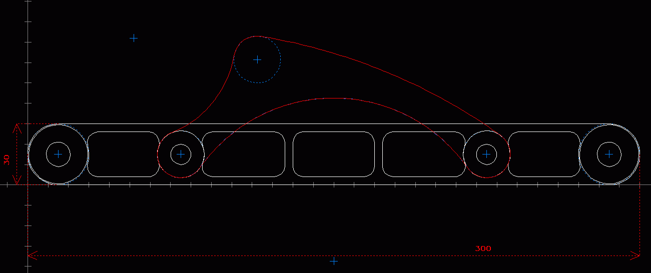

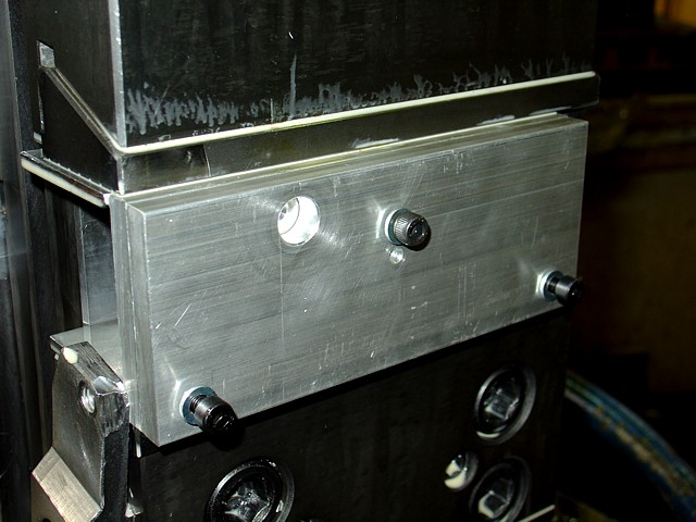

    The lenght of the particular on the photo is 300 mm.
    ZOOM!
    The red profile on the image is the next piece of the support. ;)
    Thanks to you for the explanation post. ;)
    The adjustable support is one part of the DBRS Project, it's only my construction way of the traditional mechanical parts. I love the mechanical elements! ;)

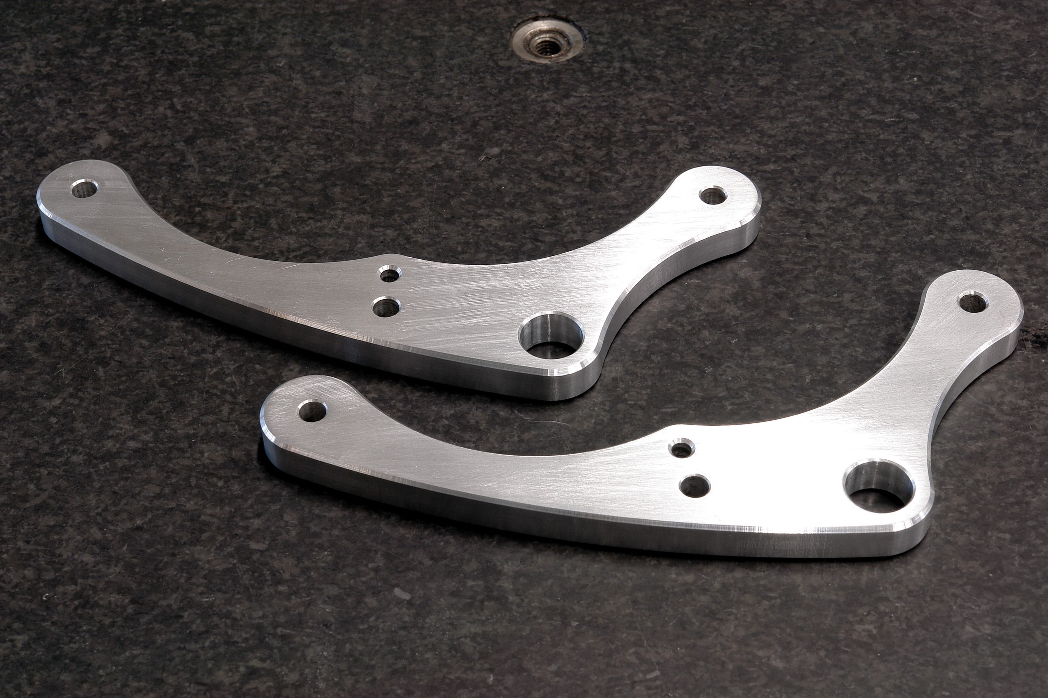

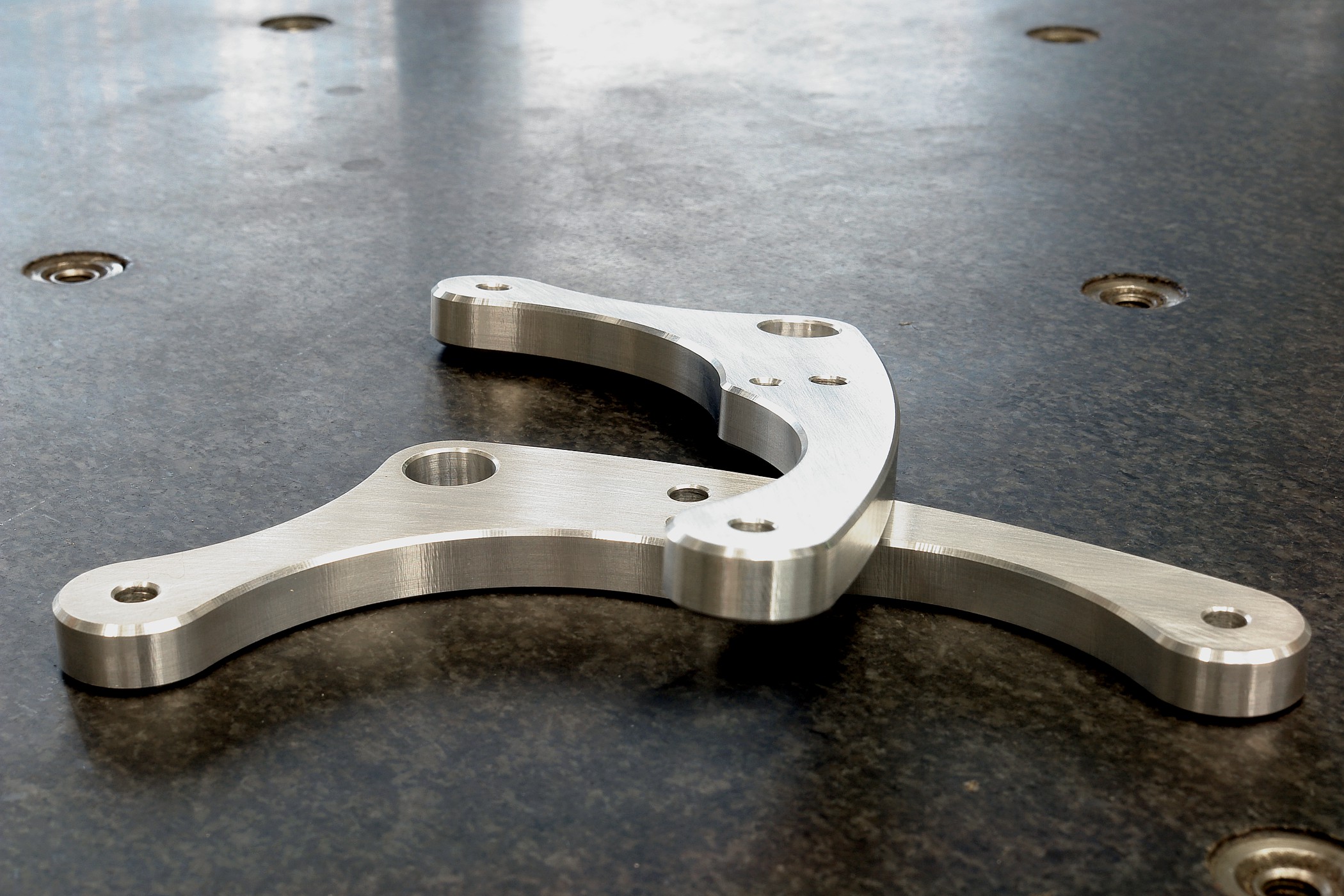

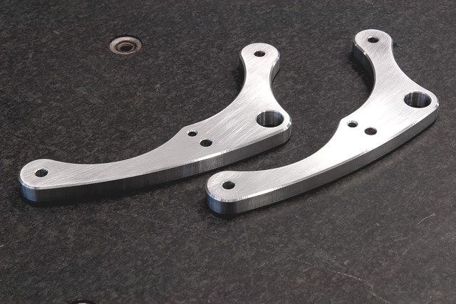

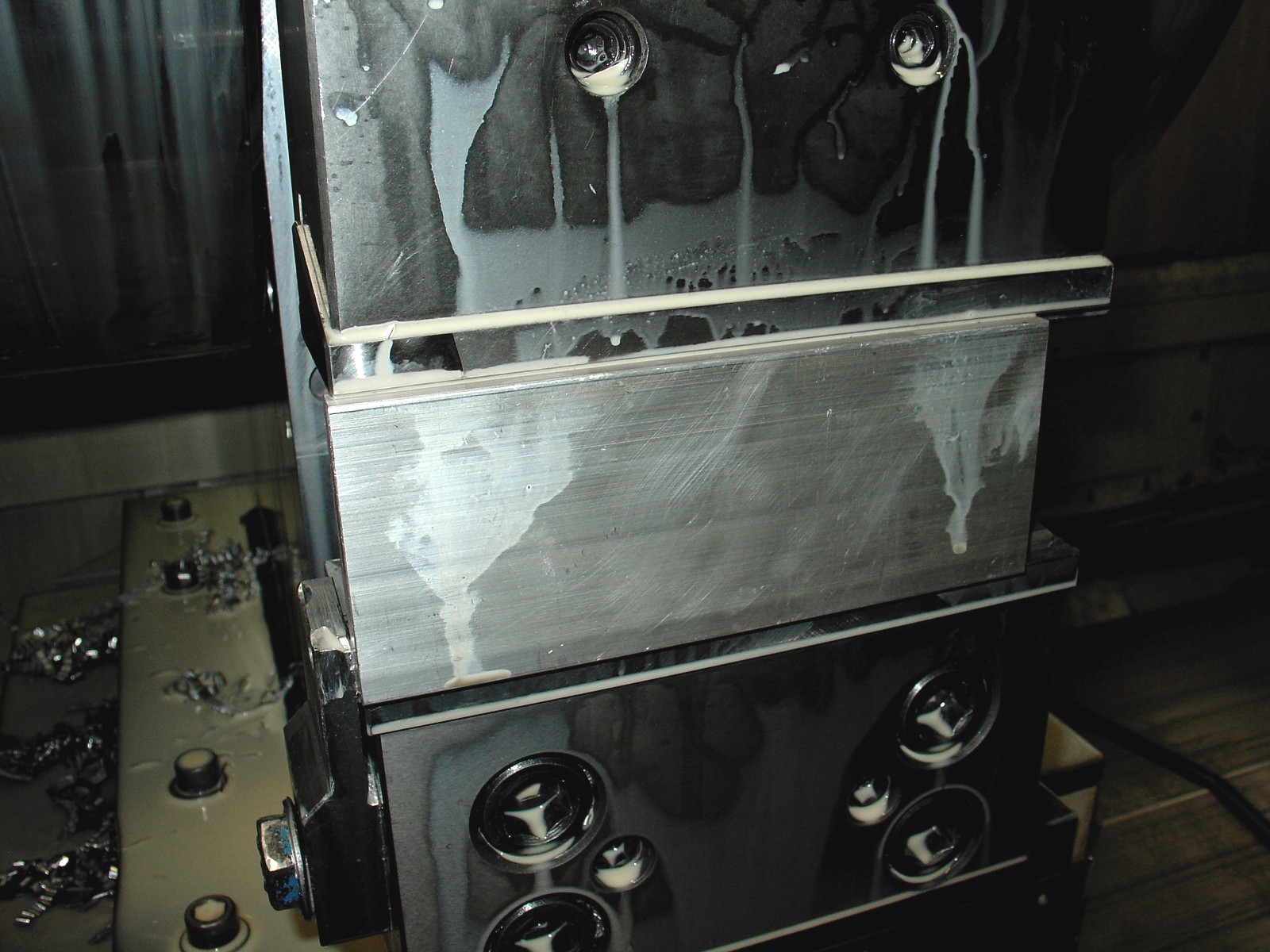

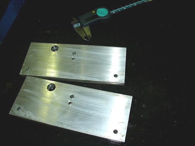

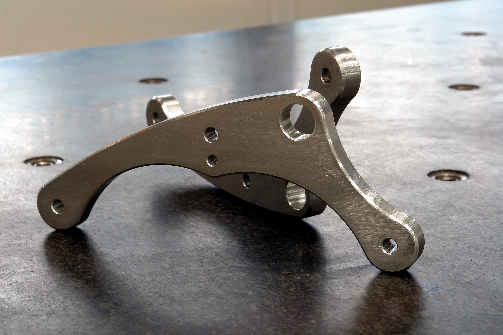

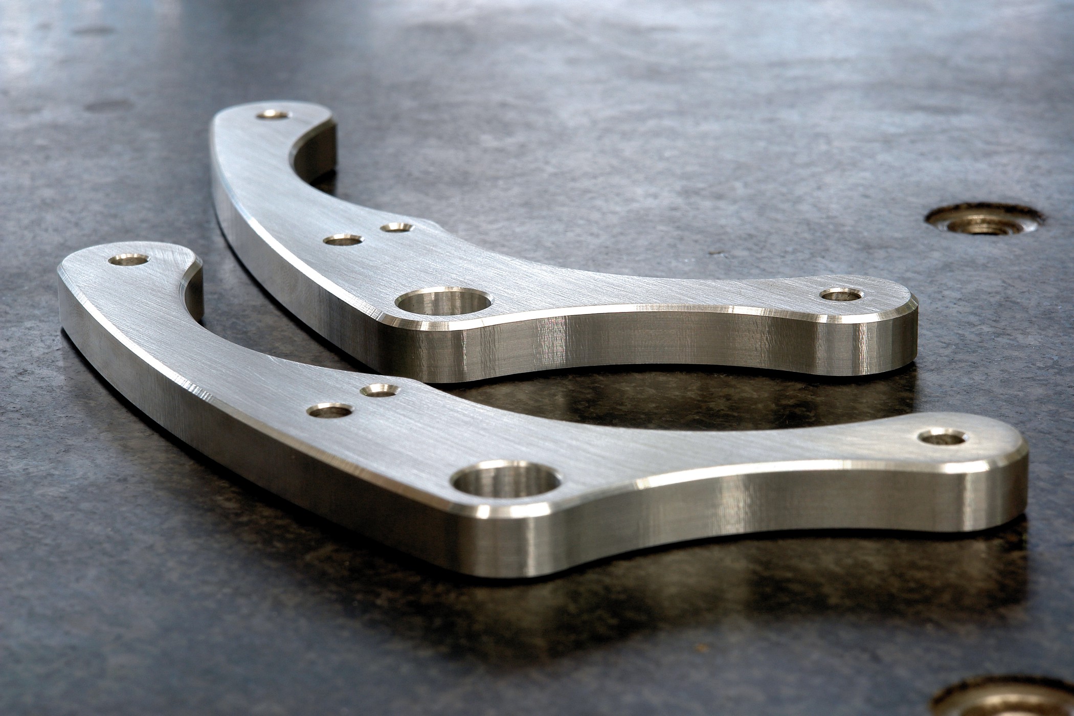

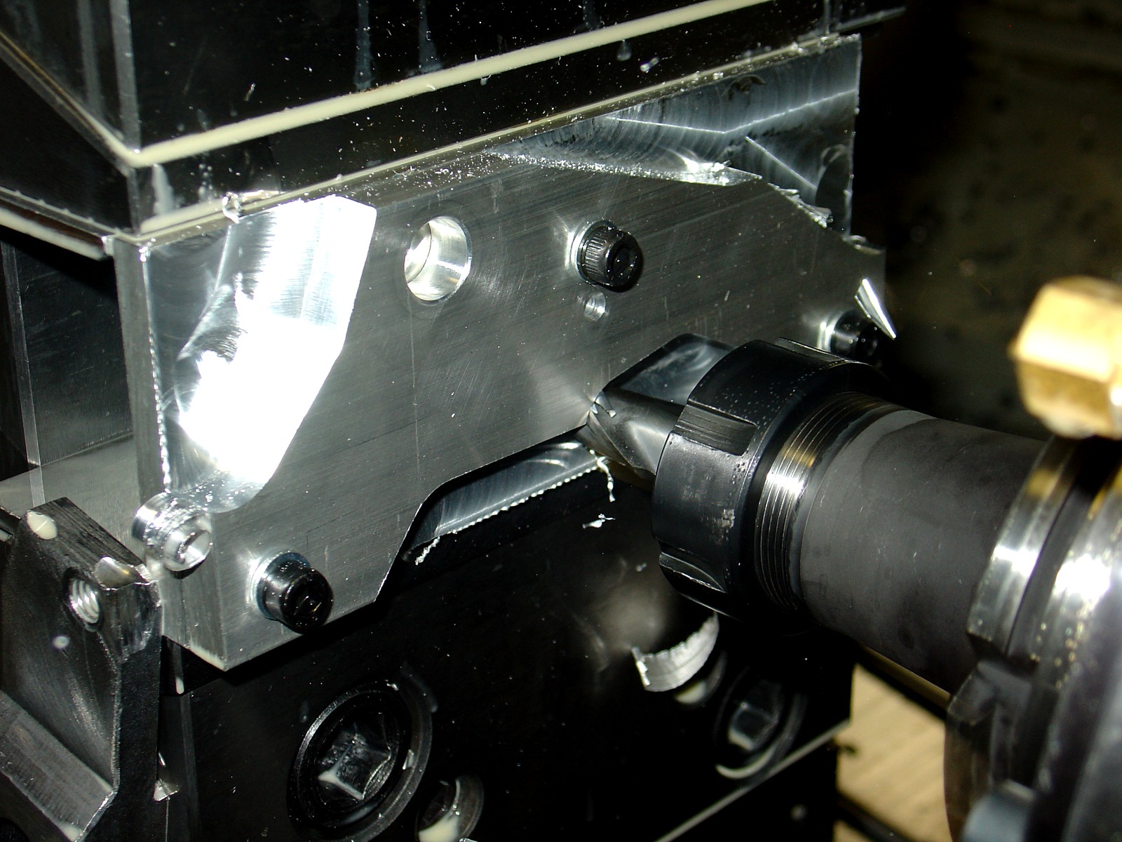

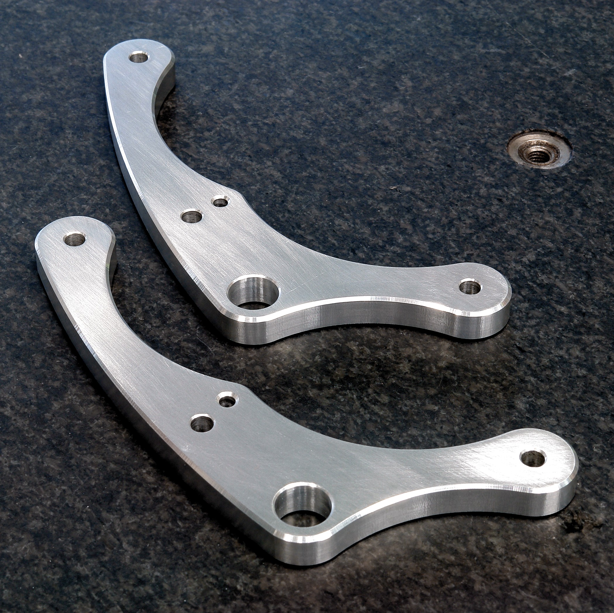

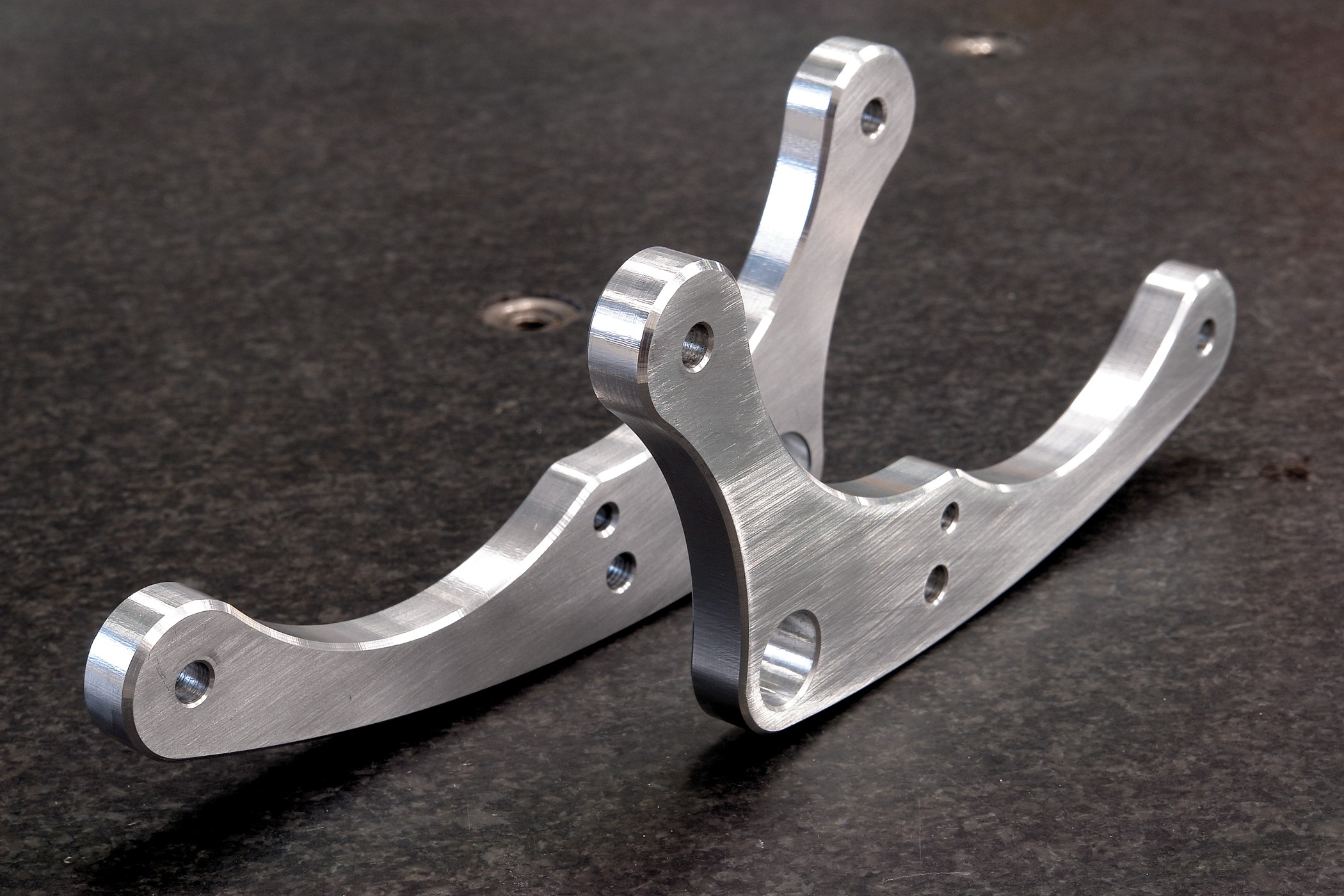

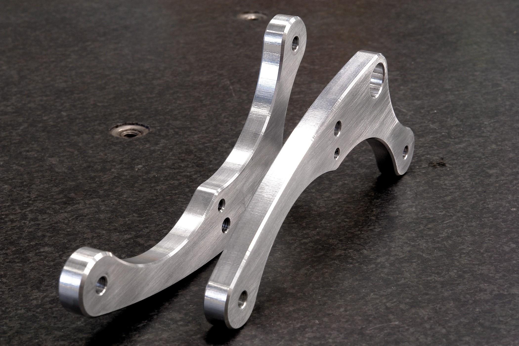

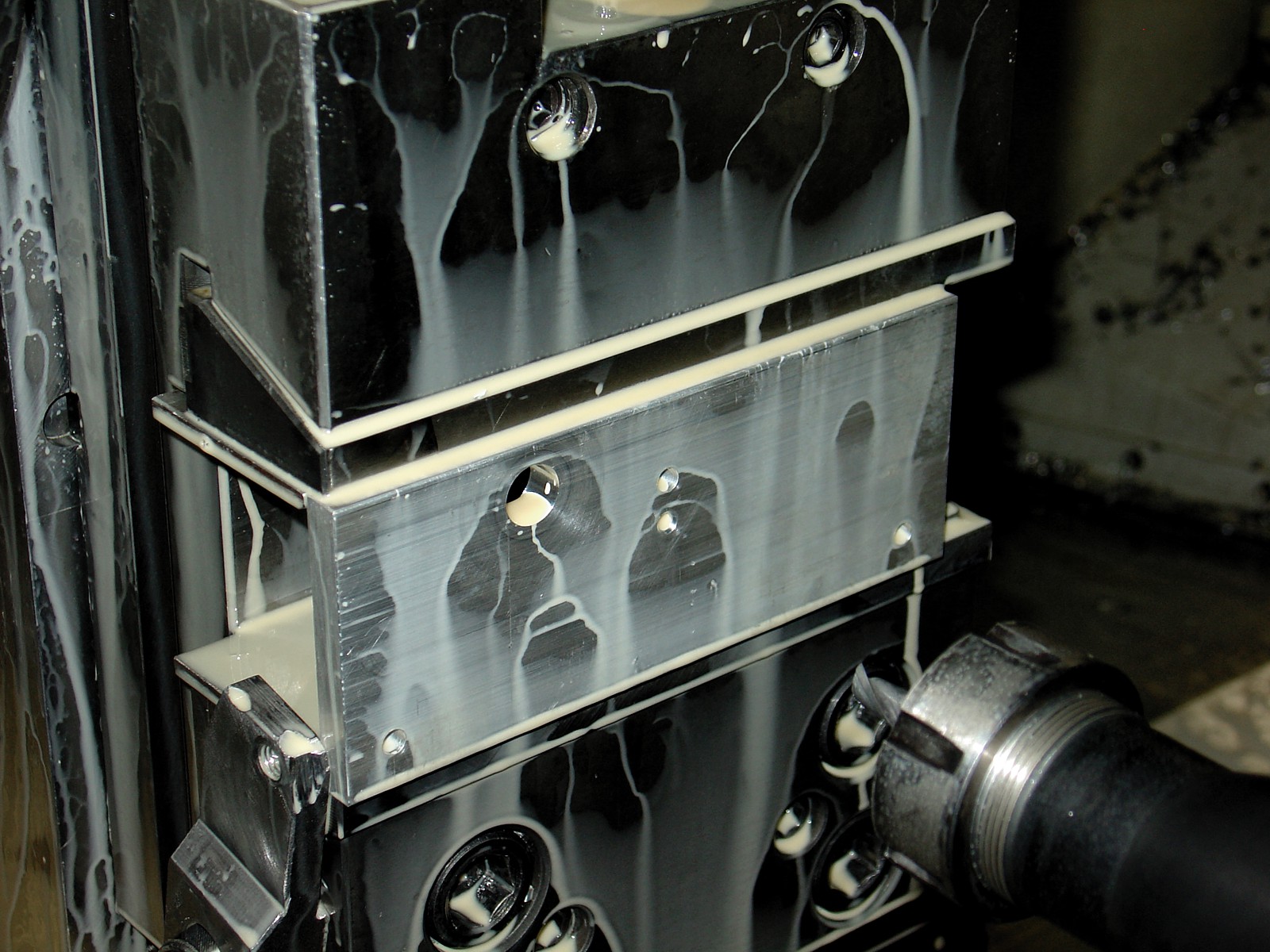

    Adjustment levers of the support.
    Another small update. The two levers of the support in raw aluminum 10mm thickness, two important parts of the manual adjustment system.

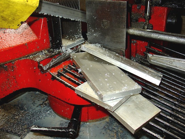

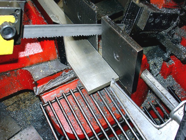

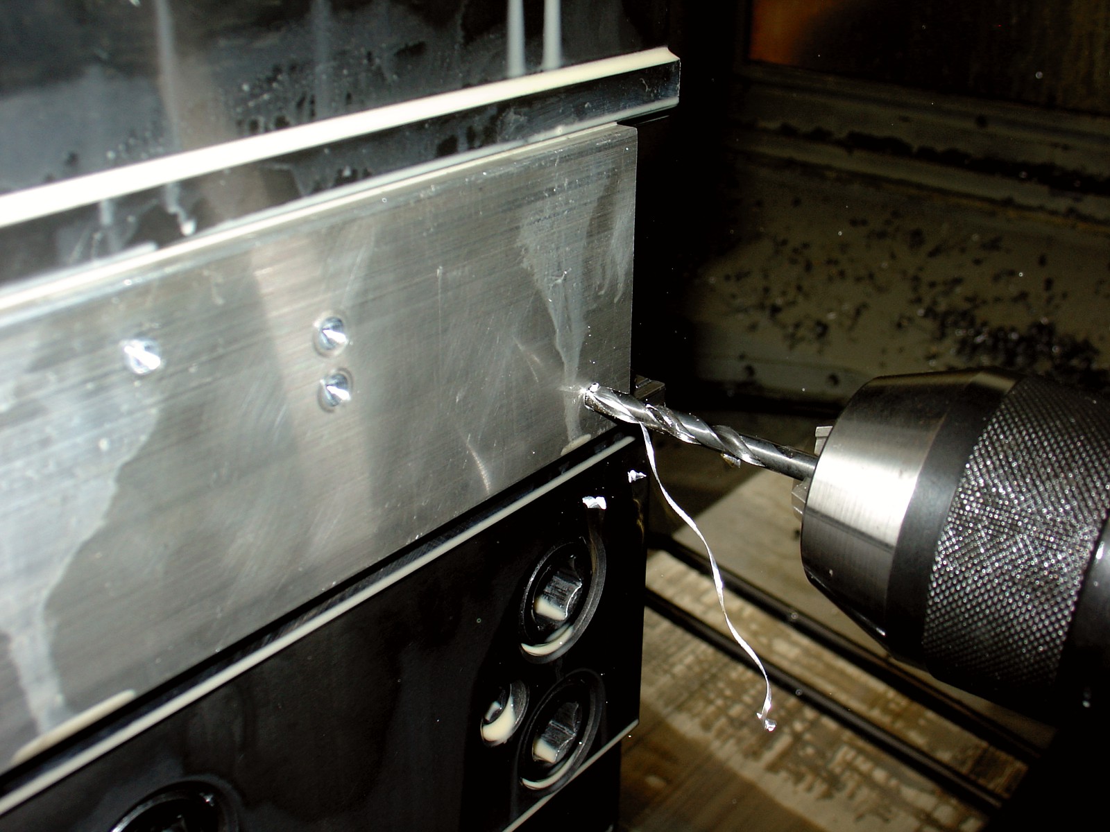

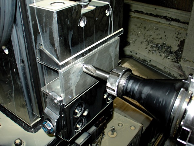

    Some images about the cutting of the aluminum flat with band saw (Aluminium type AC100 70x10mm)
    ZOOM!
    ZOOM!

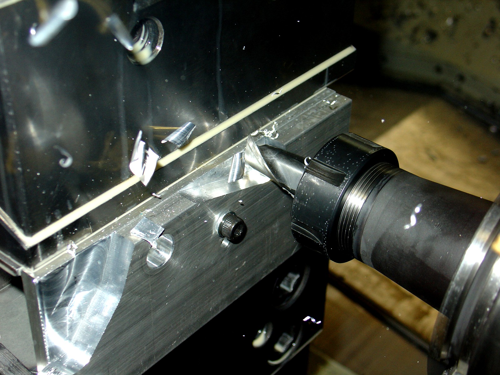

    Some images of the first working phase.
    ZOOM!
    ZOOM!
    ZOOM!
    ZOOM!

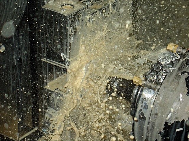

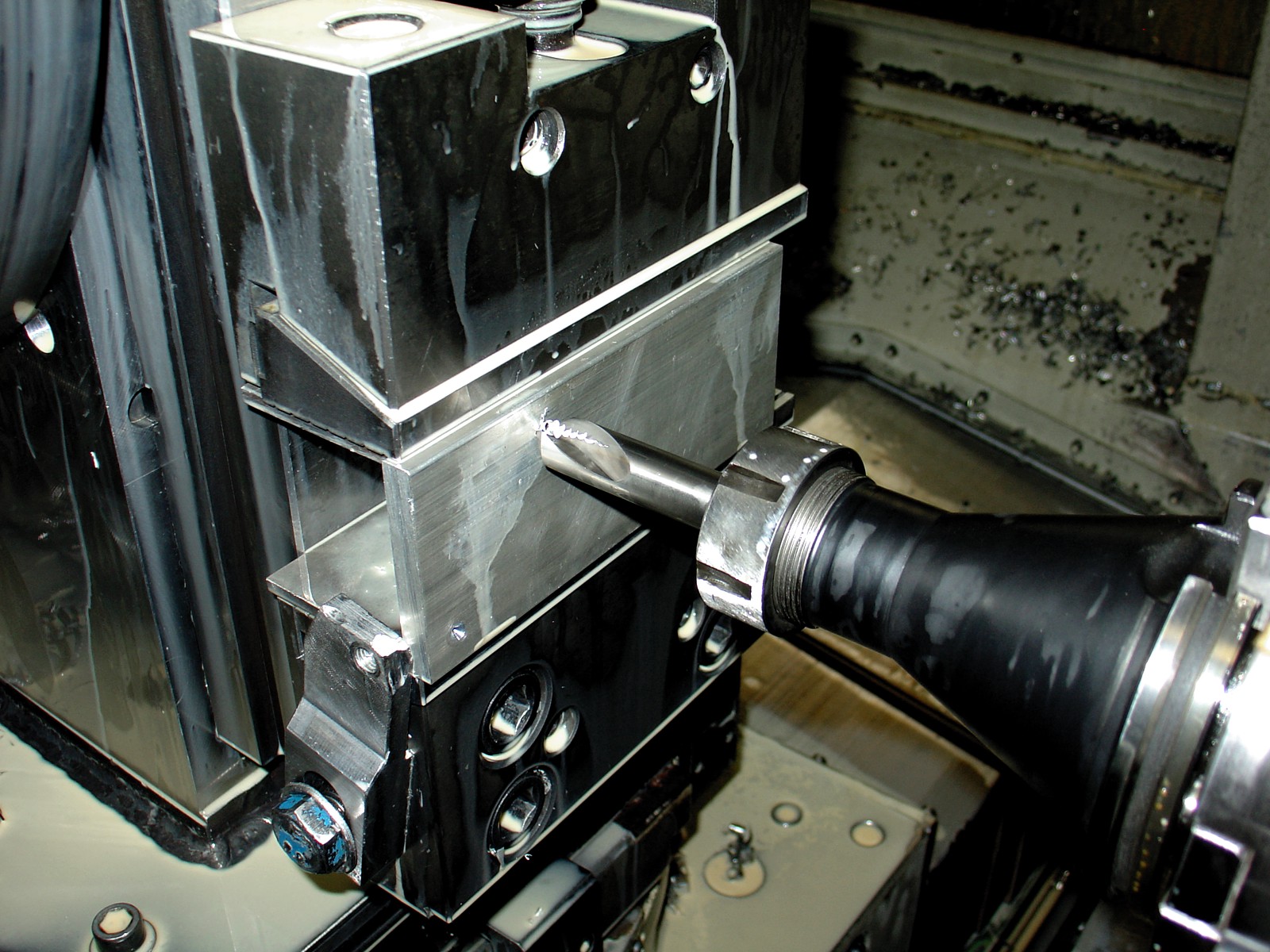

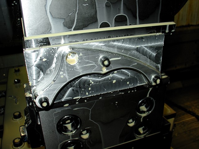

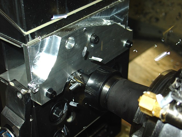

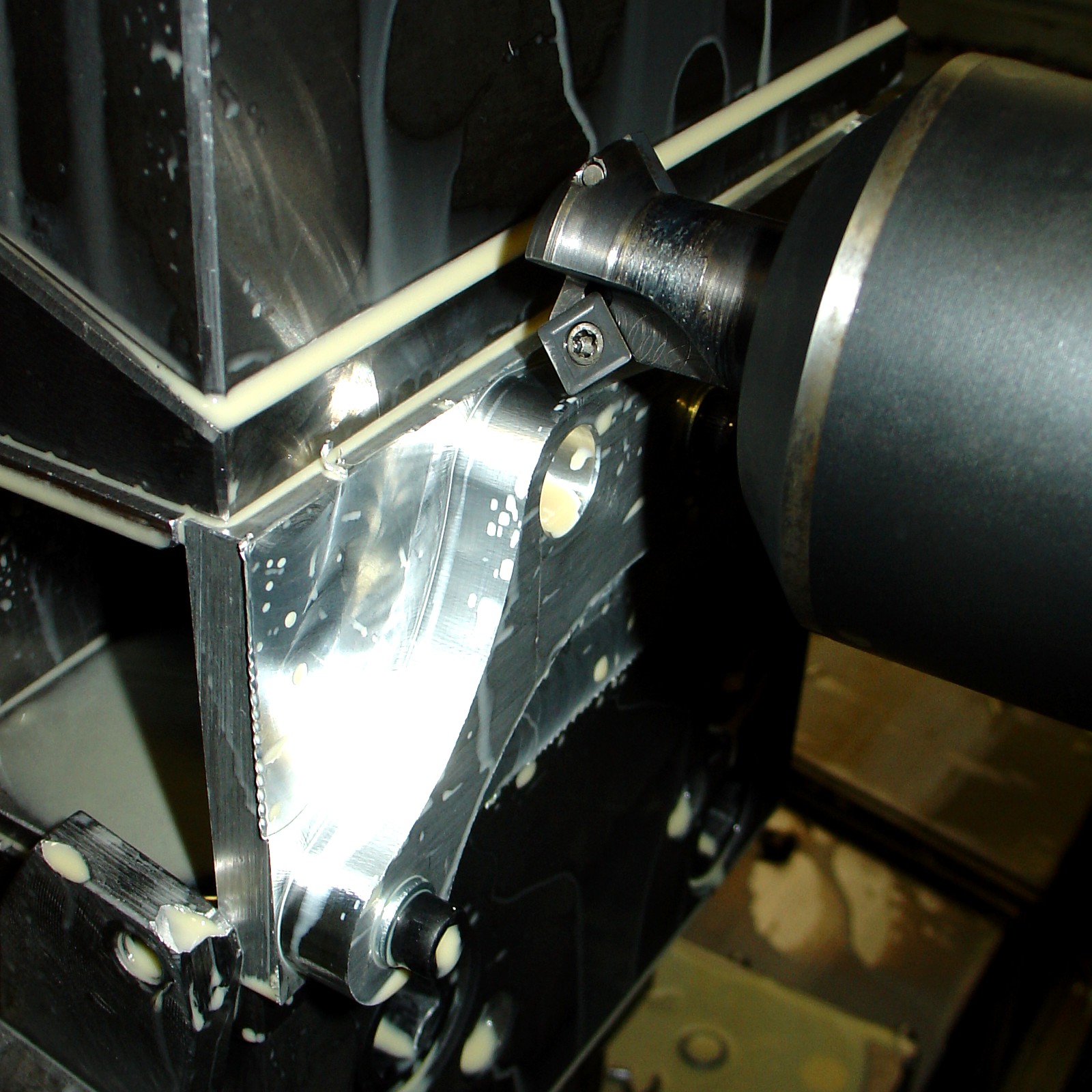

    Some images of the second working phase.
    ZOOM!
    ZOOM!
    ZOOM!
    ZOOM!
    ZOOM!
    ZOOM!
    ZOOM!
    ZOOM!

    I use a Italian CNC machine, the horizontal machining center Mandelli type 5.
    10 pallet changer and tool storage capacity for 80 tools.
    6000 rpm rotation tool, 35000 mm/min axis velocity.
