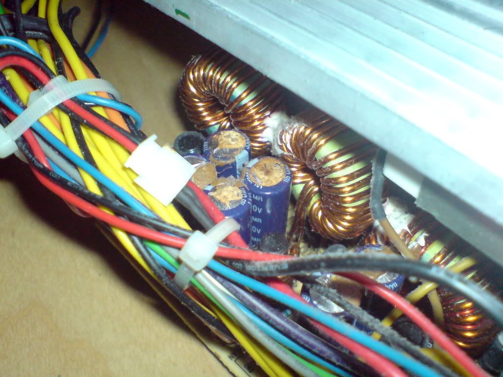

    It's dead. Old Antec PSUs use really crappy capacitors; if you open it up, you'll probably find at least one leaking and maybe another blown apart. On the plus side, your hardware is probably fine - buy a new Corsair, Seasonic or Tagan and you should be good to go - though it won't be covered by your CEW if it isn't.
    (Pics are from an Antec True380S that blew up in exactly the same way a few months ago.)
