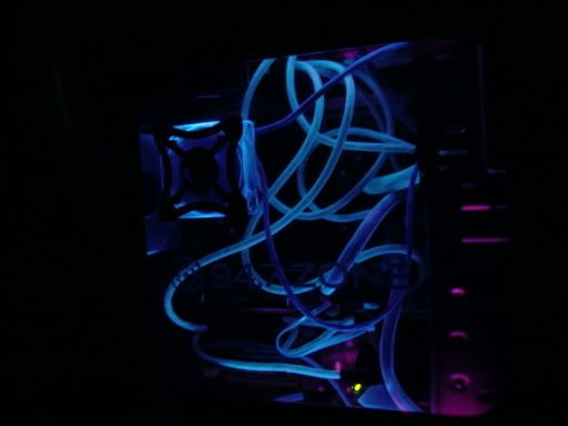

    Well i got a 400 watt X-connect :D and it looks and performs flawlessy :thumb:
    it looks too good for word so i'll let this pic do the talking [​IMG]
