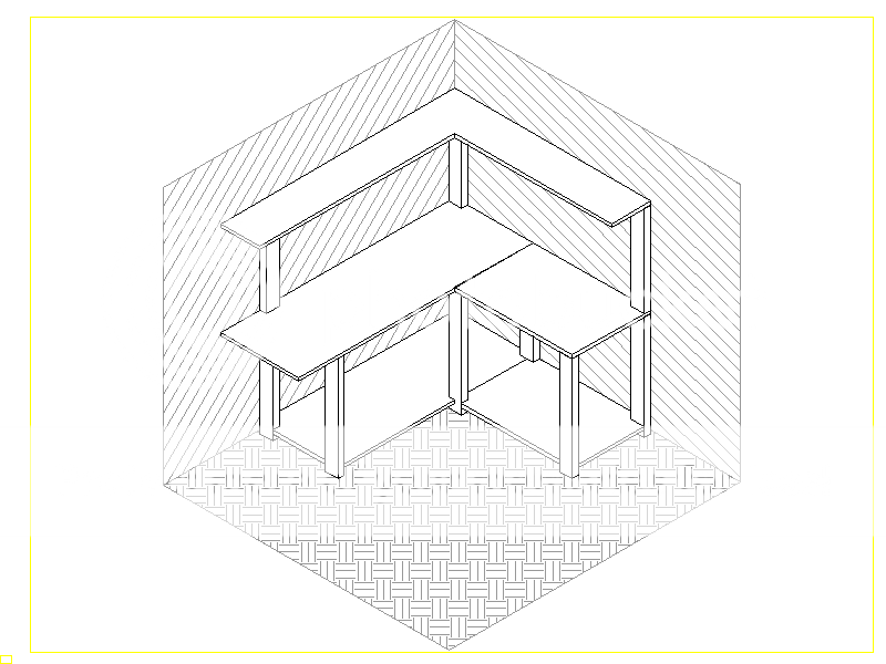

    So, since no one was biting I went ahead and did some designing of my own. It's pretty basic but that's what happens when you're a sloth. Thinking of running a little rail along the bottom of the upper level and mounting my monitor to that so I can slide it out of the way and don't have a pesky stand taking up space.
    Imagine this:
    On the bottom of a keyboard tray sitting up there.
    Also here's a little isometric drawing I made. Sketchup is for pansies.

    I'd set it up like so:
    The main desk would be rather deep - say 80 cm, mount the screens to the wall behind with some Z-stands so you can push them further back to make more desk space when needed. The shelf on top for printer/network gear, what have you, and the desk on the right just for some table estate.
    Some random points:
    - Have the desks a few inches from the walls so there's enough space to pull cables through
    - You do NOT want to have a table foot in where you pictured it, in the center, you'll end up bashing your knees there a lot
    - Large corner desks have lots of unusable space in the corner. Trust me, I use to have one. You just can't reach the corner and likely just end up having a screen there with half a squae meter of un-used space behind :wallbash:

    I looked around at the local hardware store and found some fancy little supports to get rid of that center foot. My knees and toes will probably thank you!
    I like the idea of having both sides be the same depth so that I could have two individual work stations which one chair can swivel between, going to try to think of some special method of using up that spare space that would result in the corner. Gotta be something a nerd with a dream can do to half a square meter! :D
