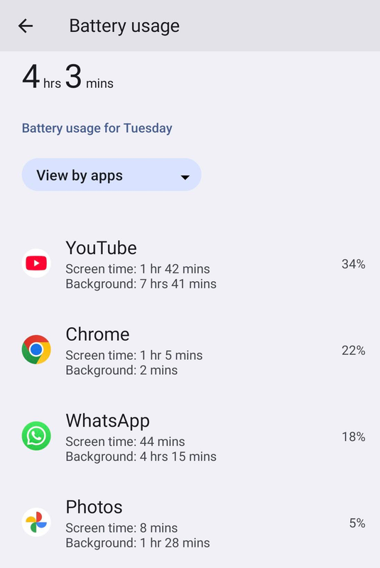

    Right cheers, that's what I was looking for and failing to find. Can anyone compare this background use to their phone? It strikes me as high, especially for Photos that really ought not to be doing anything, YouTube shouldn't be anything like that either. WhatsApp perhaps, as it's always "live"?
    I've just wiped a couple of gigabytes of cache from Photos and YouTube in any case, it's a bit of a slow process this but I'm keen to get it sorted.

    I've not really used my phone today having just rolled out of bed, holiday mode :D so perhaps not so useful but if you click on each of those do you get the power use, long number of hours, doesn't mean it has used a lot of power, if your OS doesn't show it there is probably an app for that.
    Generally if you allow notifications etc, there might be a lot of syncing going on, and phots will often upload anything you have taken, this can be set to only do on wifi

    Ok thanks; 45 minutes of YouTube in bed while off work with ten seconds of background seems entirely fair to me, it suggests mine is completely shot!

    That’s an absurd amount of background usage for YouTube.

    Do you happen to have youtube premium? If so, together with autoplay, it may just keep going without you explicitly pressing pause before closing the app.

    I have Premium but autoplay is disabled and I would know if it was playing; checking today's use it has it down as less than a minute of screen time and 1hr 47mins background. I've not used it at all today

    That's actually 24hrs usage from 11am to 11am, I have been doing healthy family things and so rarely used the phone in 24hrs :eek: marked difference to normal :D
    I don't have premium and I don't allow YT notifications.

    Something is definitely running in the background. Maybe "intelligent downloads" of videos you may want to watch. Either way, now you know the culprit.

    Hmm, smart downloads and recommended downloads are off; I'll monitor it for a few days with the cache cleared, maybe it had just gone rogue? Photos was much higher than expected as well.
