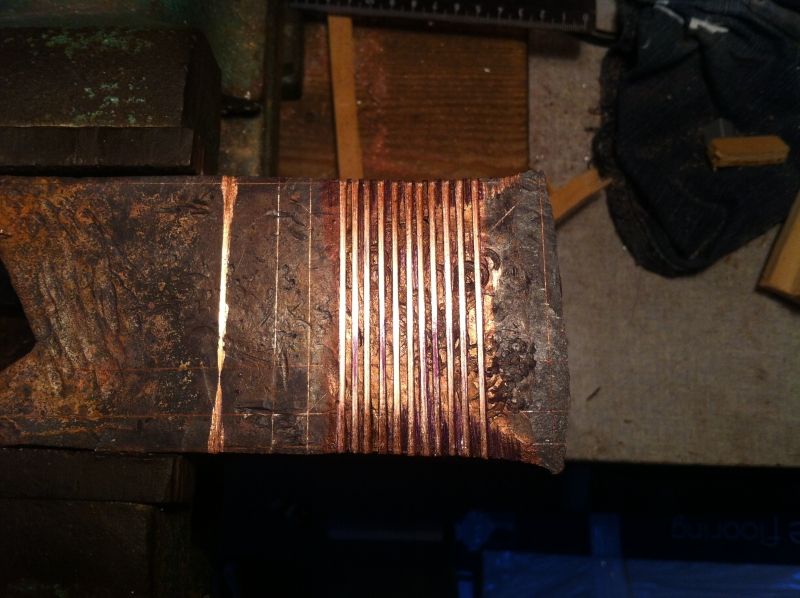

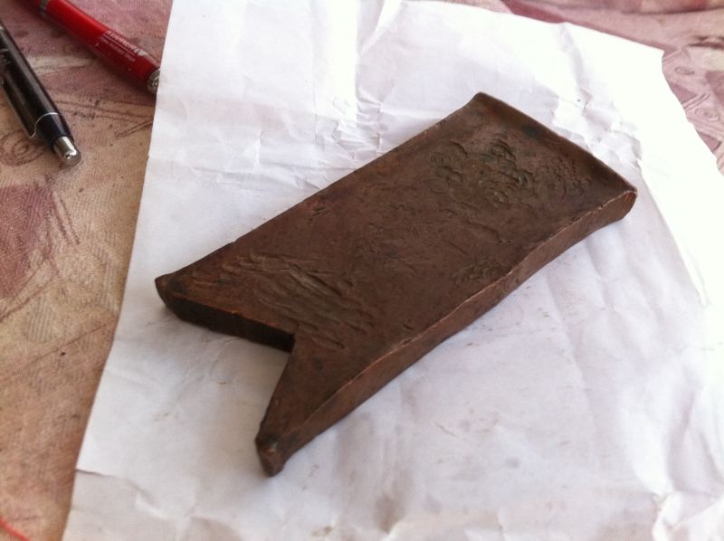

    So i got my hands on a piece of copper about 8mm thick.
    After sketching what i wanted on the piece of copper i used a hacksaw to cut the grooves for the water.

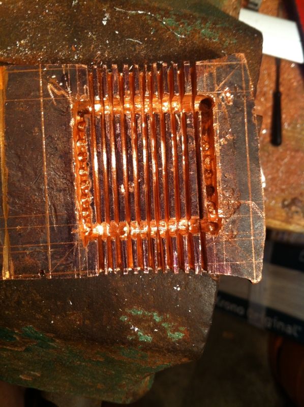

    After that i depened the grooves untill i had about 3 mm of copper left.
    And then i made a channel all around the grooves.
    Next part of the plan is to solder the grooves on the outer rims shut, and start shaping it ito a square and so on. On the top i plan to add a thick piece of acrylic with chanels for the jetplate equivalent.
    Do you guys think this will work at all?
