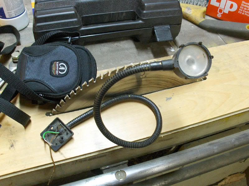

    first, a broken race car lamp by osram
    nice and bendy :naughty:

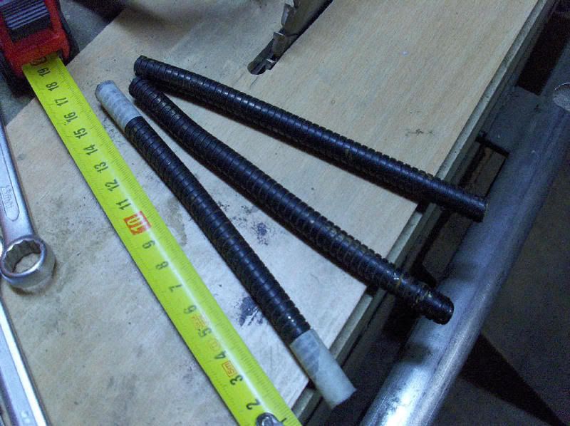

    removed lamp with a screwdriver and the other end had to be cut off with a saw

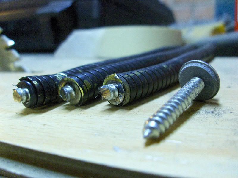

    gut it in 3 with an angle grinder, 3 x 16cm
    screwed in some screws, and gut off the excess parts

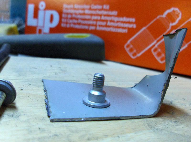

    a piece of metal sheet from a volvo and a random bolt

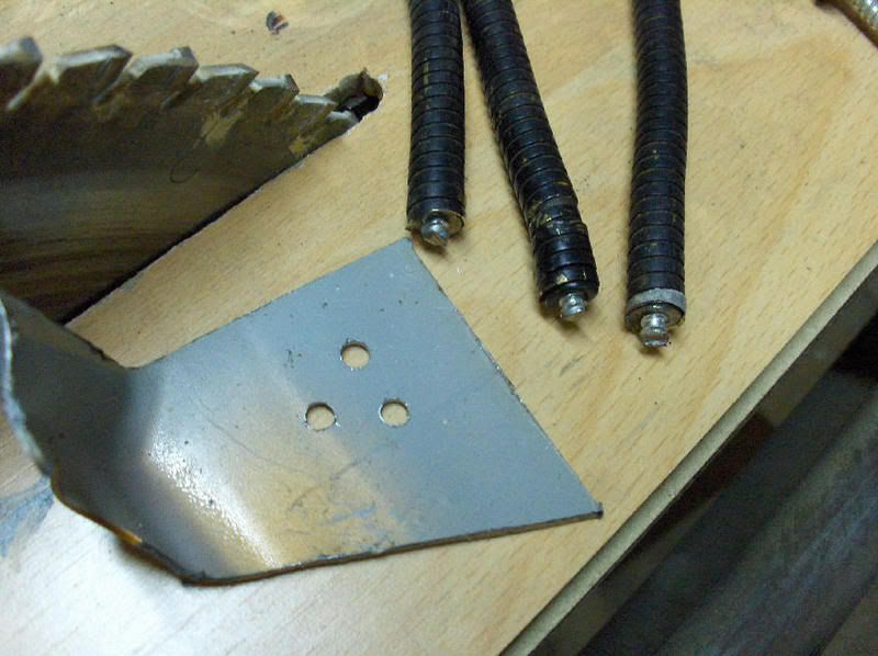

    drilled some holes

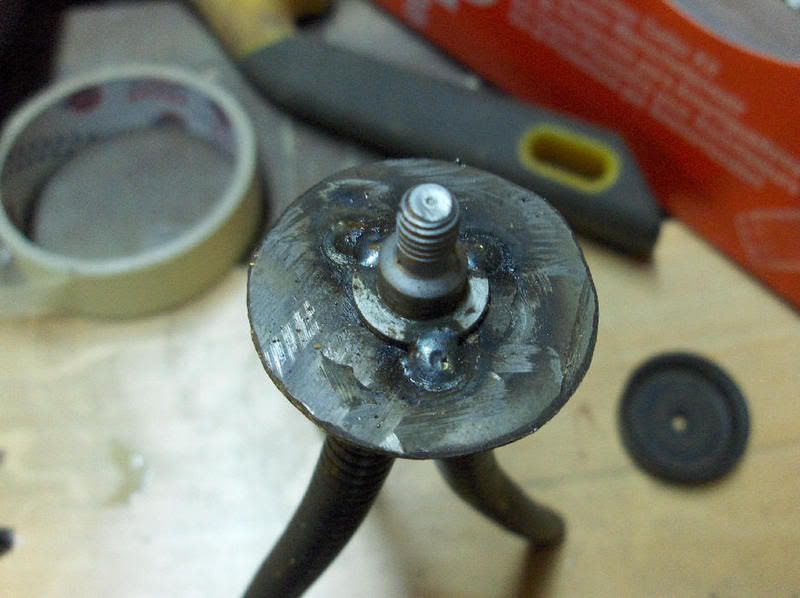

    and dad weld it all together... im a bit crappy with that tool

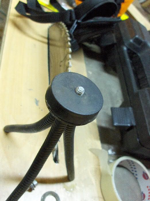

    added a shim and and some rubber thingie as the base

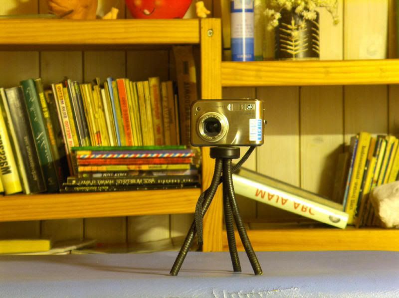

    and used some electric tape to seal the edge.... a bit ghetto but it doesnt look that bad, the final result is this(well, actually i still need to find some rubber legs in the daylight tomorrow):
    works quite nice but as it doesnt bend as well as a real one(and is a bit bigger).... i will probably still buy one.
    but until then, i think it will do the trick:
