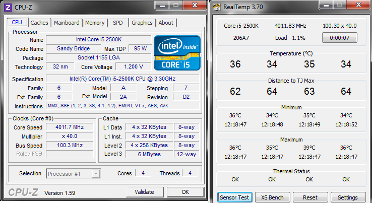

    load temps were like: 61/59/60/65

    Heres the low down at idle, with the comp being on a few hours and after about 6 unsuccessful attempts @ 4.2ghz with IBT maxed. Got vcore up to 1.260v but didnt want to increase anymore until I got my new paste applied. So downclocked to 4ghz @ 1.215v, stable
