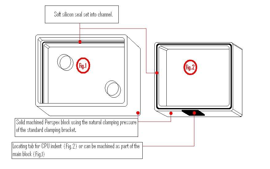

  20. Jux_Zeil
    Jux_Zeil What's a Dremel?
    30 Apr 2009
    493
    17
    Has anyone thought of using the CPU as the baseplate. You have the equipment and obviously the skills. The best way I can say what I mean is with a quick Paint drawing;
