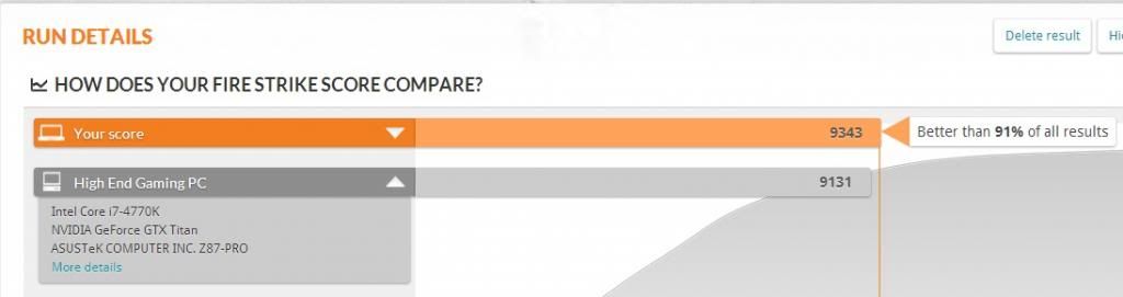

    How can it be possible to go from just over 9000 points in 3Dmark (13) to this -
    http://www.3dmark.com/3dm/1182124?
    When dropping from X16 X16 SLI to X16 X4?
    Could it be my newer (and faster) SSD coming into play?

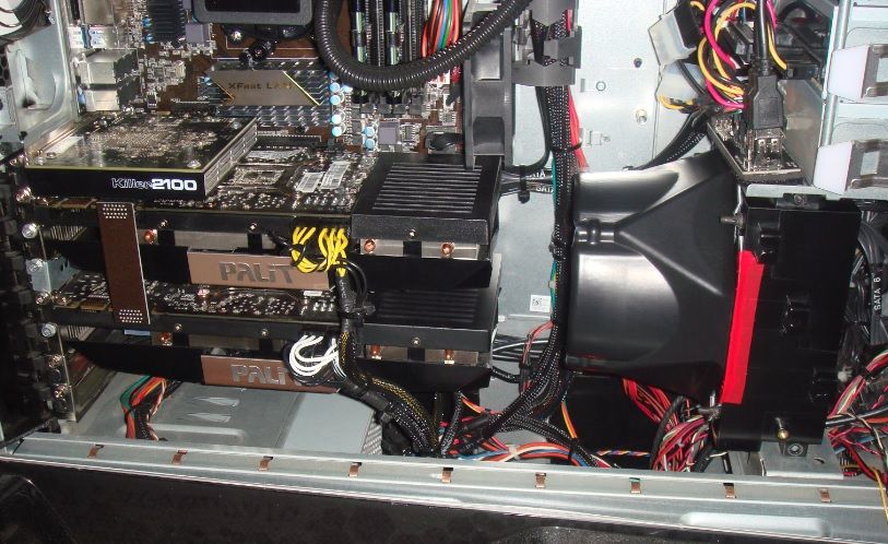

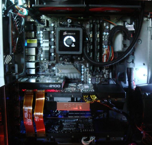

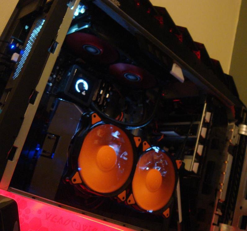

  8. AlienwareAndy
    AlienwareAndy What's a Dremel?
    7 Dec 2009
    3,421
    70
    With the cards packed together (well, this close...)
    And with the duct fan at 50% I was getting temps of 83c max on the top card. I wasn't best pleased about that (I thought Kepler were cool cucumbers) so I added these, then turned the duct fan down to 20% so I couldn't hear it at all, then I was seeing 79C top card.
    Oddly anything over 40% on the actual card fans (pair of 80mm or something) made no difference, so I was able to tweak everything so that it was quite well behaved sound wise..
    Now running them like this.
    Has made literally no difference to that. In fact, really heavy stuff will make the cards run to 80c still.
    As mentioned yes, I've had to run the cards X16 X4 as it was the only way to fit the Revodrive and to do so I had to hack using HyperSLI as SLI does not run on anything less than X8 lanes.
    So yeah, only difference apart from the 'massive' (he says without having a clue what he's talking about really) drop in bandwidth the only difference is the Revodrive.
    Both runs were done on a freshly installed version of Win 8, here is the X16 X16 run.
    3Dmark 11 has dropped.. Here is the X16 X16 run.
    And the X16 X4 run.
    http://www.3dmark.com/3dm11/7121909
    Though let's face it, it's not exactly hurt anything and the power on offer is still pretty barbaric. Which makes me wonder why Nvidia are so bloody shirty (no offence bra :D ) about allowing SLI to run on X4.
    I mean yeah, quad SLI Titan ? I can see it causing issues. But why rob yourself of extra GPU sales over 300 points in a benchmark :S
