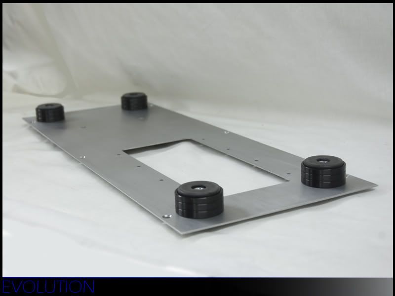

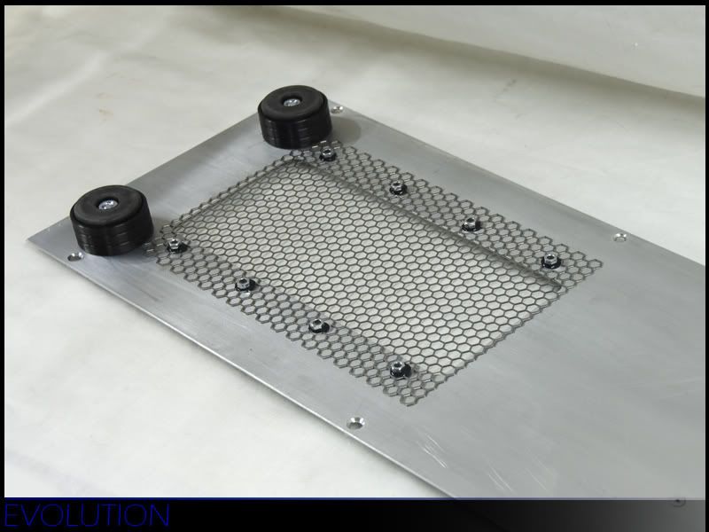

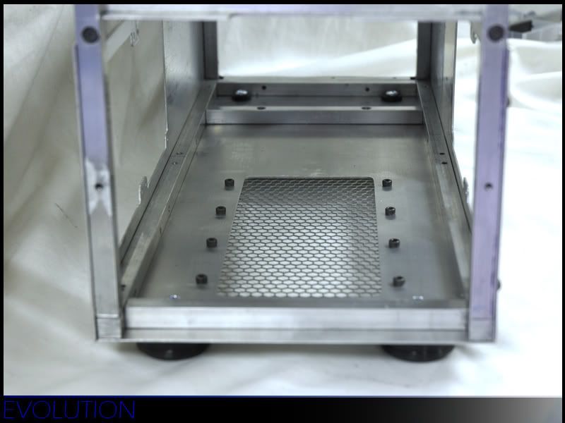

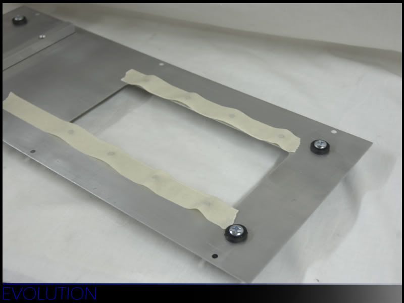

    Tis update time again :clap: today's victim... the bottom panel.

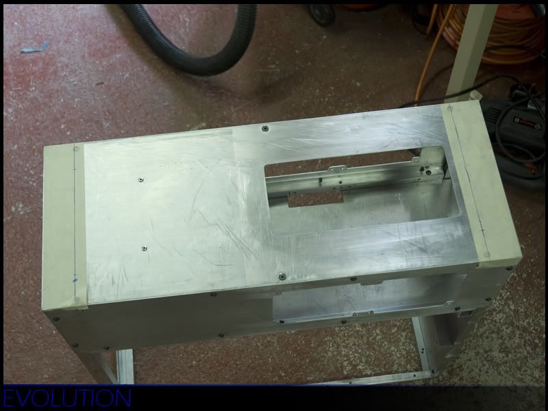

    For the 2 radiators to work as planned I needed to create some form of intake in the bottom part of the case, so simple hole was measured, cut, filed and then a quick once over with some 600 grit to take away the rough edges. You may notice that the screws have been also been countersunk, thanks to oldnewby for the pep talk on countersinking :thumb:
    Next I moved onto the feet placement.

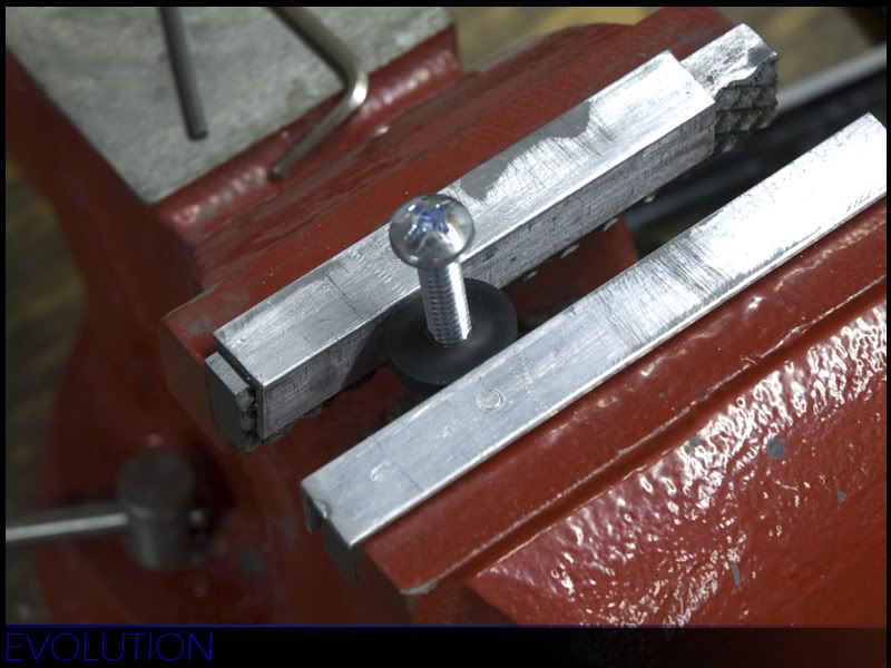

    These feet are awesome but the bolts Bill sent me were a tad to long... probably me just being stupid as I had a banging headache from the day/night before lol. Anyhow not to be out done I searched through my box of wonders and found some of the tap washers I was going to use for the hard drives so these were added to the bolts as spacers and to reduce vibrations even more :)

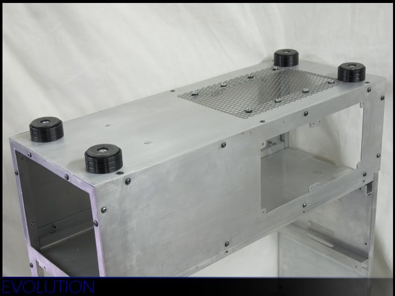

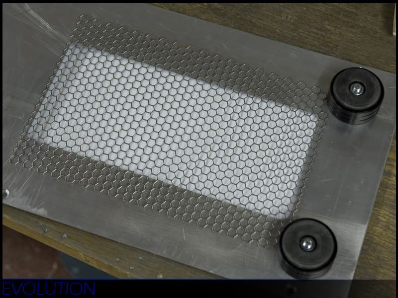

    I still had a load of hex mesh that I got in the beginning but never really found a use for. Pruned to shape around the feet.
    Bill also sent me some small M4 bolts with the grill but they were to short to be used in the way I'm mounting it so I'll be using them to mount the mesh instead.
    Some measuring and drilling.
    Parts of the mesh were then pruned out for the screws.

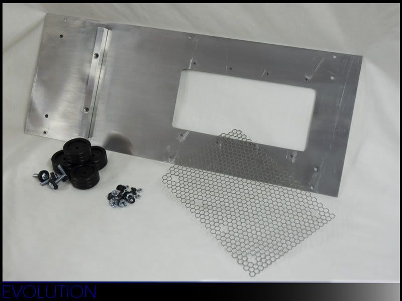

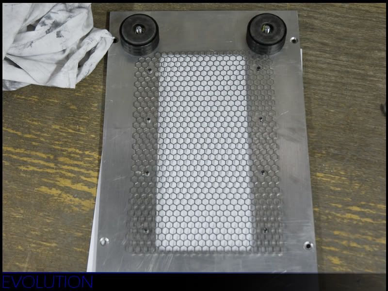

    Thought I'd do something a bit different and show all the pieces that go into the bottom panel before it all goes back together.
    The feet go on.
    The M4 sockets are pushed though and taped in place to allow correct positioning of the mesh before adding a grommet but in half a nut. The grommets and nuts will be replaced with dome caps once I place my order for the final fixings.
    Finished :)
    Time to re-assemble the bottom section

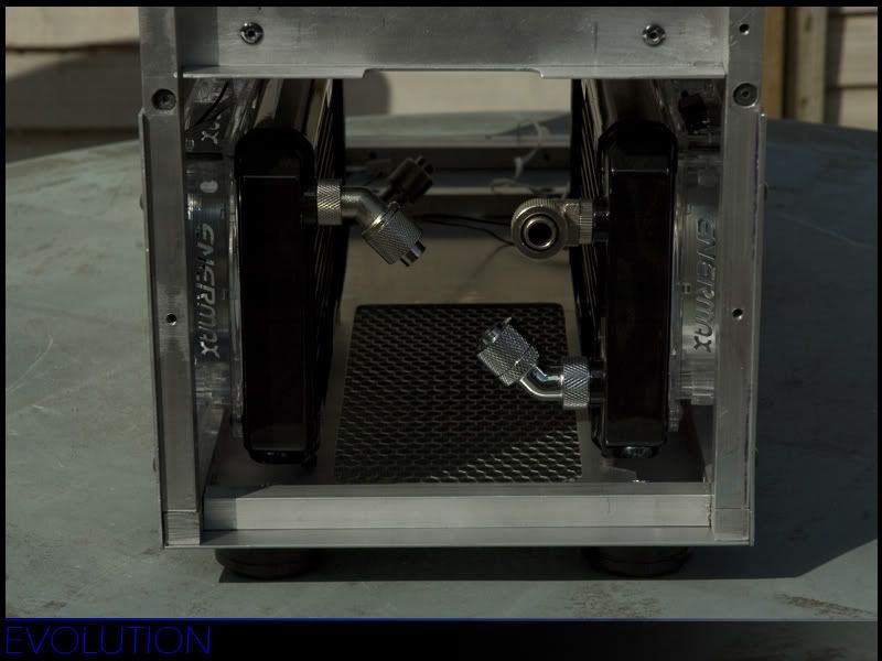

    And finally a couple of shots of the inside.
    That's all I have for today, hope you enjoy it :)

    Its looking really tastey :) Not sure if anyone has suggested this, but why not have both radiators as exhausts? then you wont have to worry about hot air flowing through the second rad... And you can put a dust filter on the bottom to stop them clogging up :)

    I was thinking about it and in fact during the planning stages it was that way but then I realised that due to the final resting place of the case I would be getting blown with warm air lol the other option was to create a shroud to move the air down towards the rear but that idea got scrapped.

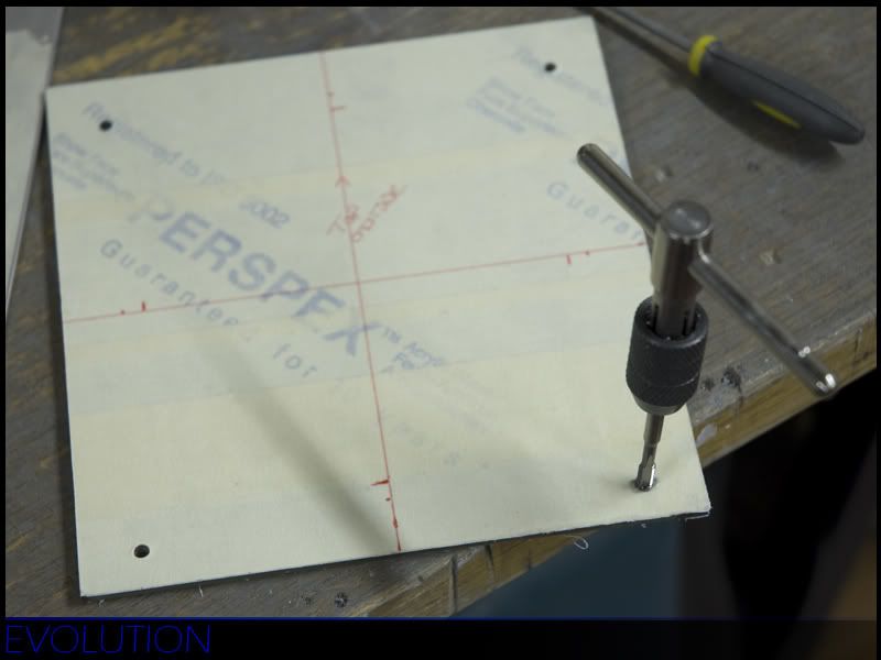

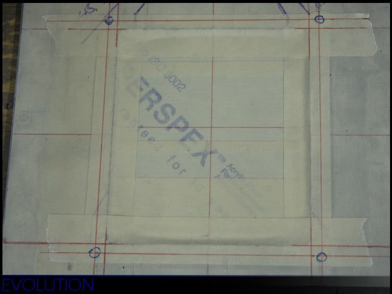

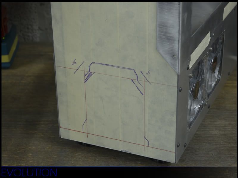

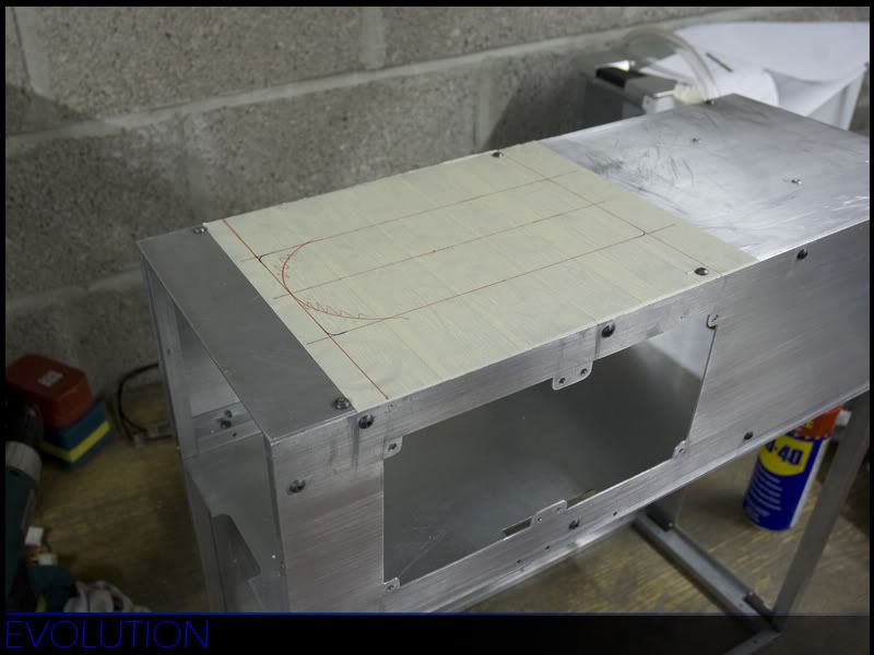

    So week time modding limits the amount that I can get done but here is what I have to show for today.

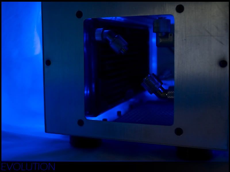

    After spending some time on the bottom panel I decided that showing off it off was a must, plus a small window should add some interest to the left panel. Things started off with some planning, A simple box was drawn and then I doodled for 30 mins after which I reverted back to a a simple box lol.

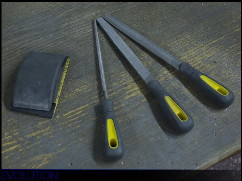

    For some reason I don't have a shot of the cutting or filing stages but I do have one of the tools I used :p

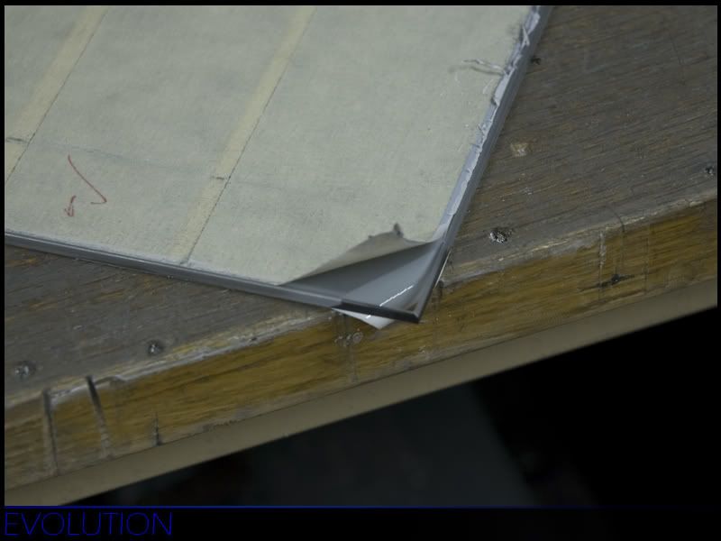

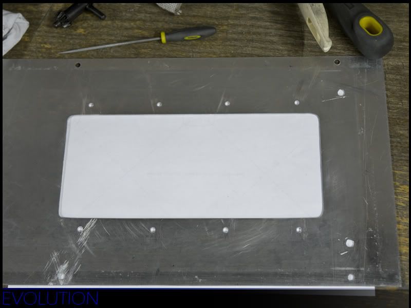

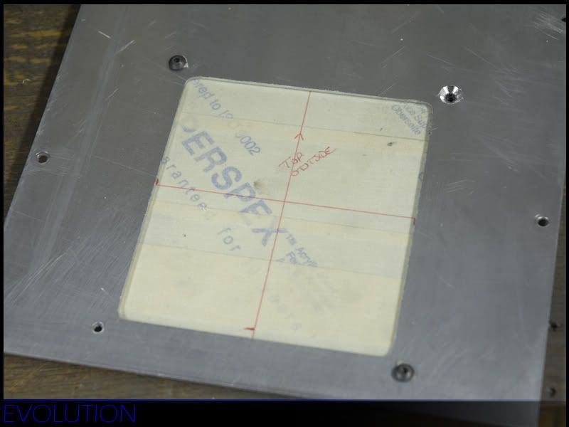

    I then cut some smoked plexi to size and gave the edges a slight bevel taking them down from 600 to 1000 wet and dry finishing of with a wipe over of WD40.
    This piece was then positioned behind the window hole, taped in place and measured for the fixings.

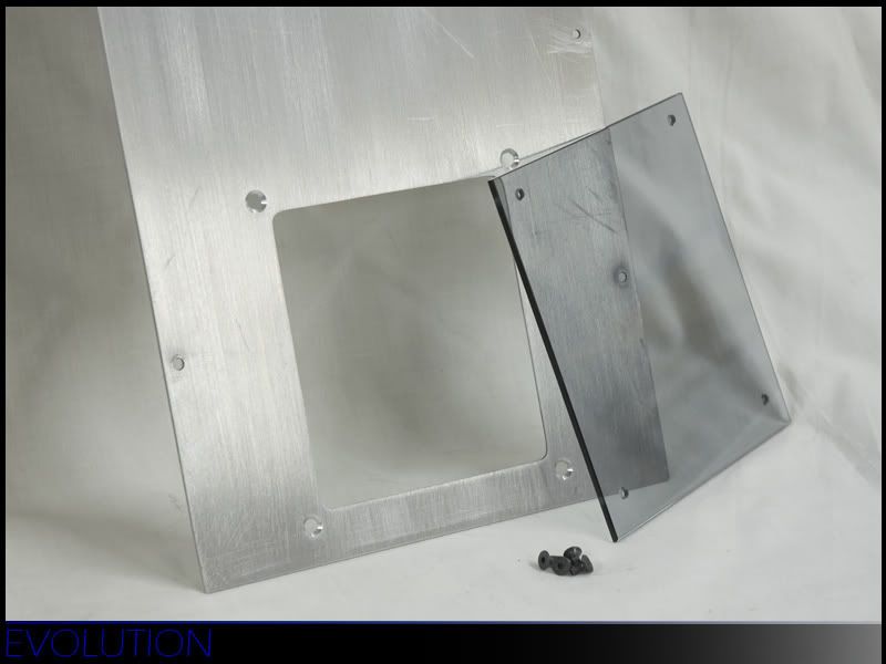

    With the holes drilled I moved onto tapping the plexi for M4 and countersinking the aluminium
    All the pieces done and ready for assembly.

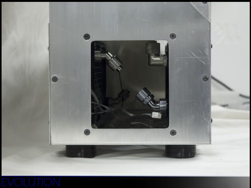

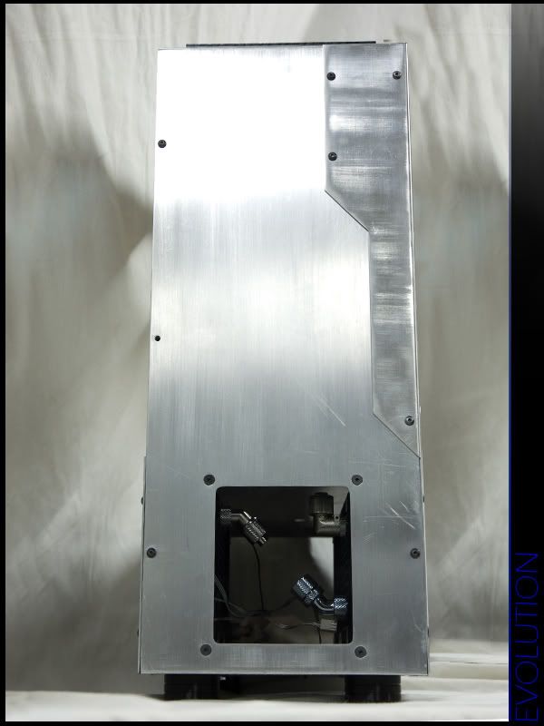

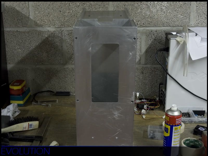

    Now for some eye candy of the new mini window.
    And finally with subtle lighting from the fans.
    Damn I cant wait for this thing to be black! its also clear to me now that some new fittings are in order as soon as I can afford them.
